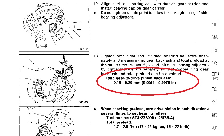

Hey all im after backlash crown wheel bolts and end cap bolts specs for setting up a Nissan Safari Rear diff can anyone help out as being a toyota owner im not sure
Doing the job for a local club member

Pm me your email, I can email you the section of manual on diff, 4mb file
Or check Nissan patrol aus forum if you want to download the whole file manual (100mb)
Re: Nissan Safari Diff Specs
See attached
Awesome thanks for the info guys.
