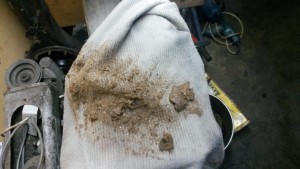

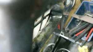

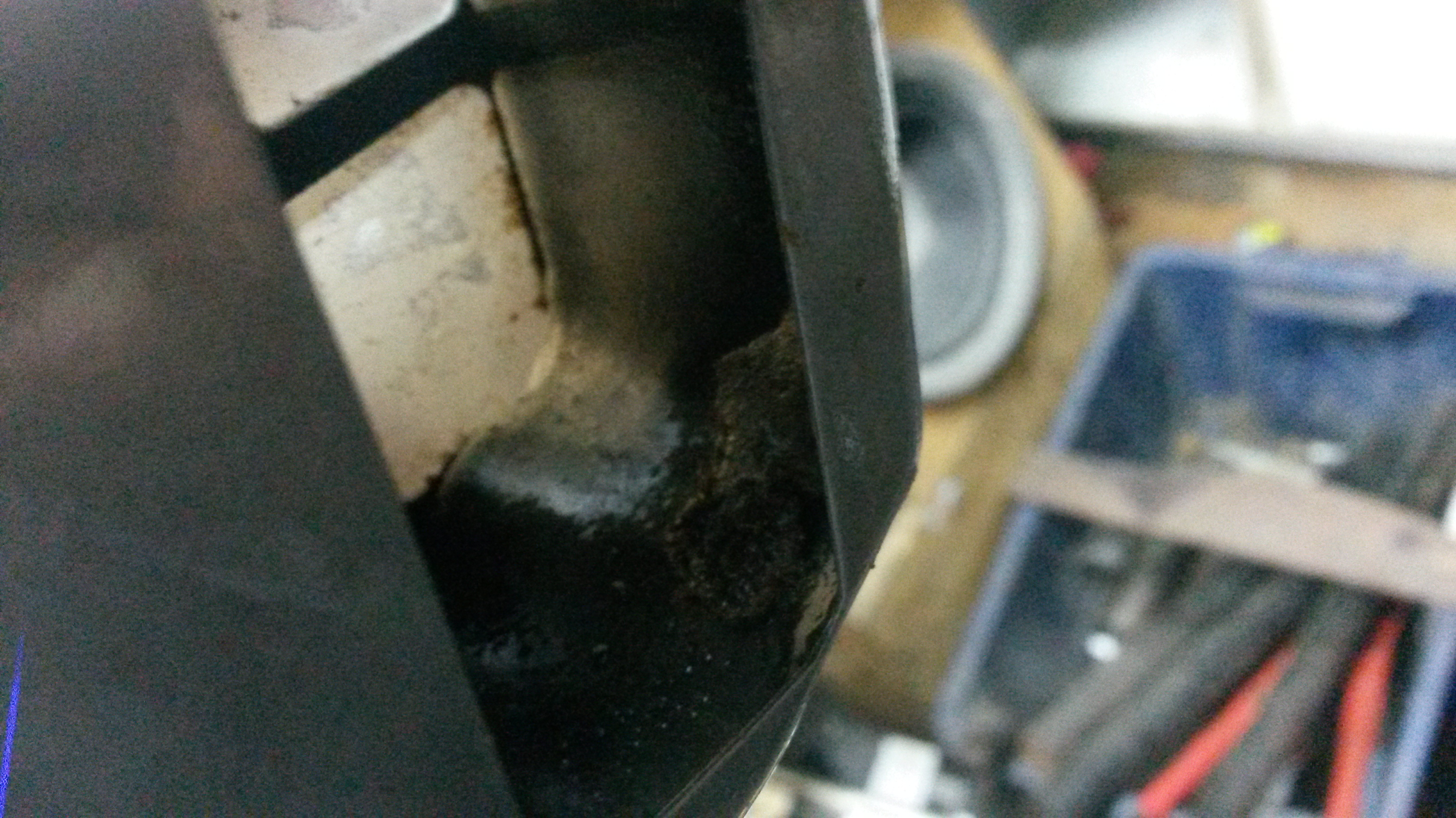

Update time
pulled the auto tranz pan off and removed the filter
As told by Keri and Tim filter was full of firbe obviously from the clutch packs.
Hit it with a can of brake clean and removed 99% of it
Tomorrow night i will reassemble and fill with new trans oil old stuff was a little brown in colour.
Tim I will let you know re the rebuild kit need to have a talk to a few people first as i may look at upgrading it if possible as it will see alot of towing duties.
Will keep you all posted
Cheers Leigh
