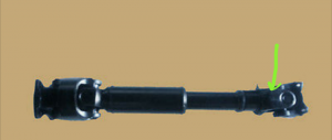

My ln65 fail wof due to excessive play in front driveshaft. it appears to have no grease in it but when I start filling it up it just comes staight out the shafts near the uni rather than travelling towards the slip join, I'm wondering do these have a bung (like a frost plug type) in the end of the shaft? does anyone know?

place of where it's leaking the grease

yeah they have a plug in the end, if they get overfilled with grease they can hydraulic the plug put as the slip joint compresses, time for a replacement driveshaft if its failed on excessive play in the spline
