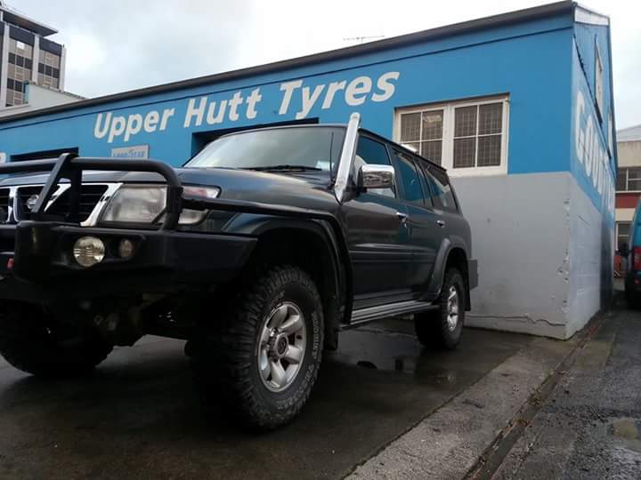

Clint wrote:Got out for a bit more testing over new years with some mates. The low gears were very very nice on the steep as farm tracks :D
All going good apart from a bit of movement in the engine + gearbox mounts at times - the low gears must being torqueing things around. Need some new engine mounts anyway.
Clint

Clint wrote:
Colinl wrote:
Geez that green patrol looks like mine...say hi to malcom if it is :)
Yep, that was Malcolm's one... he replaced it with a new shape Prado so we've been giving him shit about driving a hairdresser car :lol:
