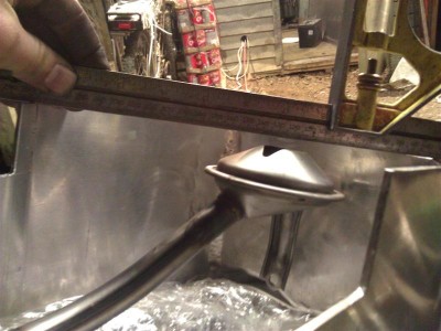

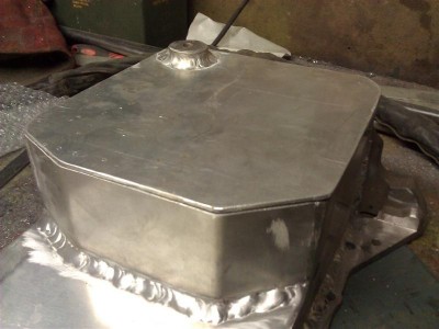

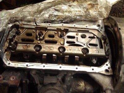

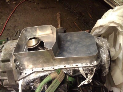

Internal baffle plate and drain plug. Have i done this right ???? Any thoughts would be appreciated

Re: Suzuki+SR20DET+Hilux Axels+coils+Exo Cage
That Baffle will work fine for keeping the oil around the pick up, the other reason for baffles and windage trays is to keep the crankshaft out of the oil, I don't know if this is a problem in your application. Keep up the good work and thanks for sharing.
Made some windage trays for the back of the crank. thanks Smokey

Them welds don't look like they'll be cracking anytime soon

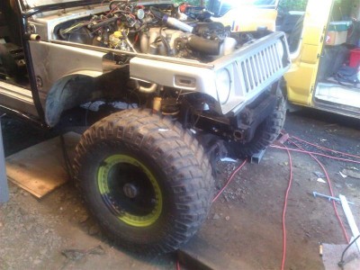

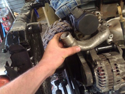

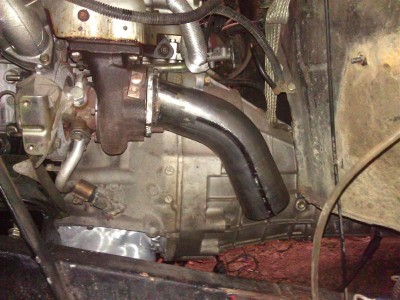

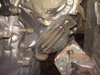

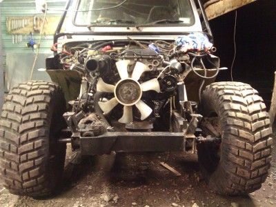

Hi thanks guys Got some more done and got the engine sitting much better lower position. Had to cut out a bit of the gear box tunel to fit.

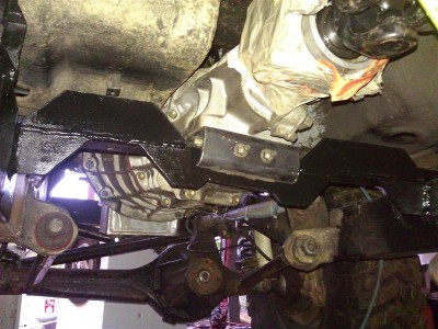

Engine mounts

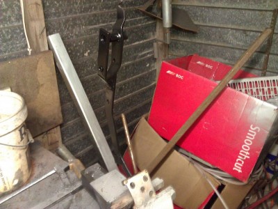

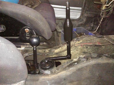

Clutch, gear shifter, sorted.

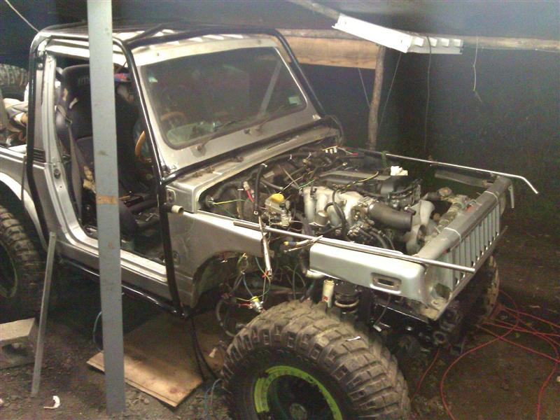

Finally got to the fun part of the project

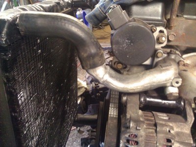

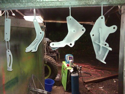

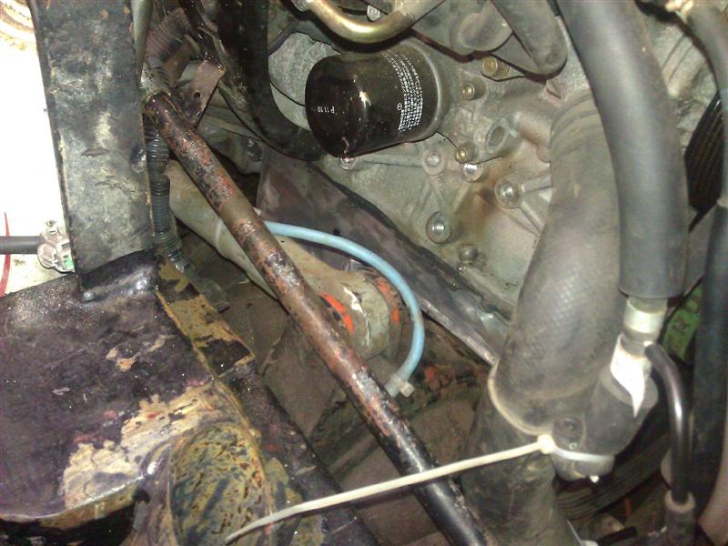

Relocated alternator and power steering pump.

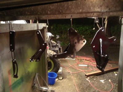

Great product that zinc it stuff though I'm sure it recommends applying a primer ontop of the zinc it before top coat

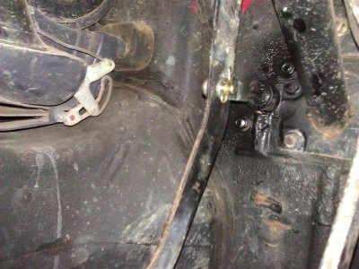

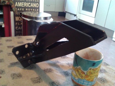

Re did my clutch set up. There was not enough leverage having it so low on the pivot.

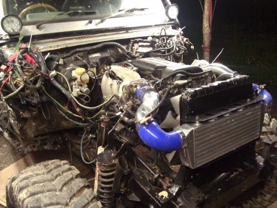

Time for a test drive

Yup standard transfer case with a full custom cradle. So hope it stands up to the punishment. If not will have to come up with a new plan.

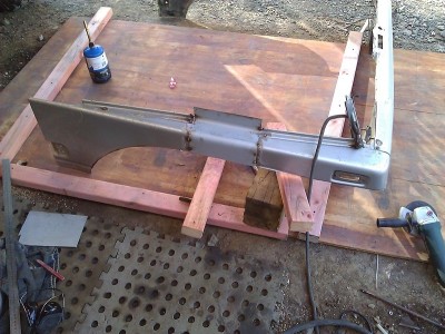

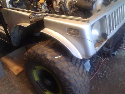

Started to extend hood but half way through, realised that all the lines on the hood would be skew. so decided to re skin the hole thing.
