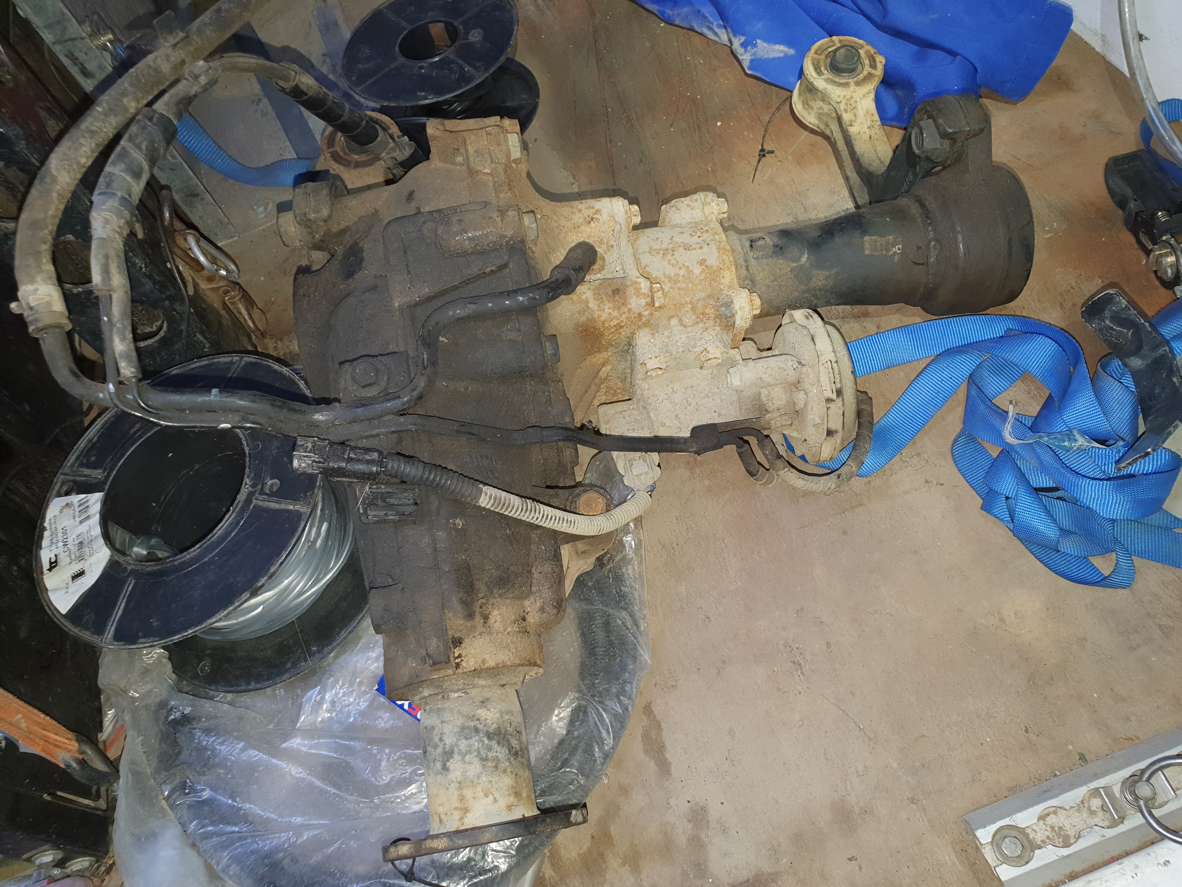

Re: first surf build.
I did briefly search for a twin transfer or something along the lines of that to push it backwards, but that doesn't seem to exist for these transfer/trans.
I have collected a hzj79 transfer/the correct extension housing to go from lex auto to transfer.(thanks big)
have a step up ag box to drive the hydro pump through..
unless theres a genius way to drive the hydro I cant come up with?
saw 4wdstuffs Suzuki at the trials with crank drive, but I have a radiator in the way.. dont have much(any) room to run additional belts or gears/chains from front pulley.
might be a dream for a while longer.
did see a man on youtube modify a hilux gear drive transfer to accept a cruiser pto, but learnt my lesson and would like to try keep this somewhat unmodified parts.

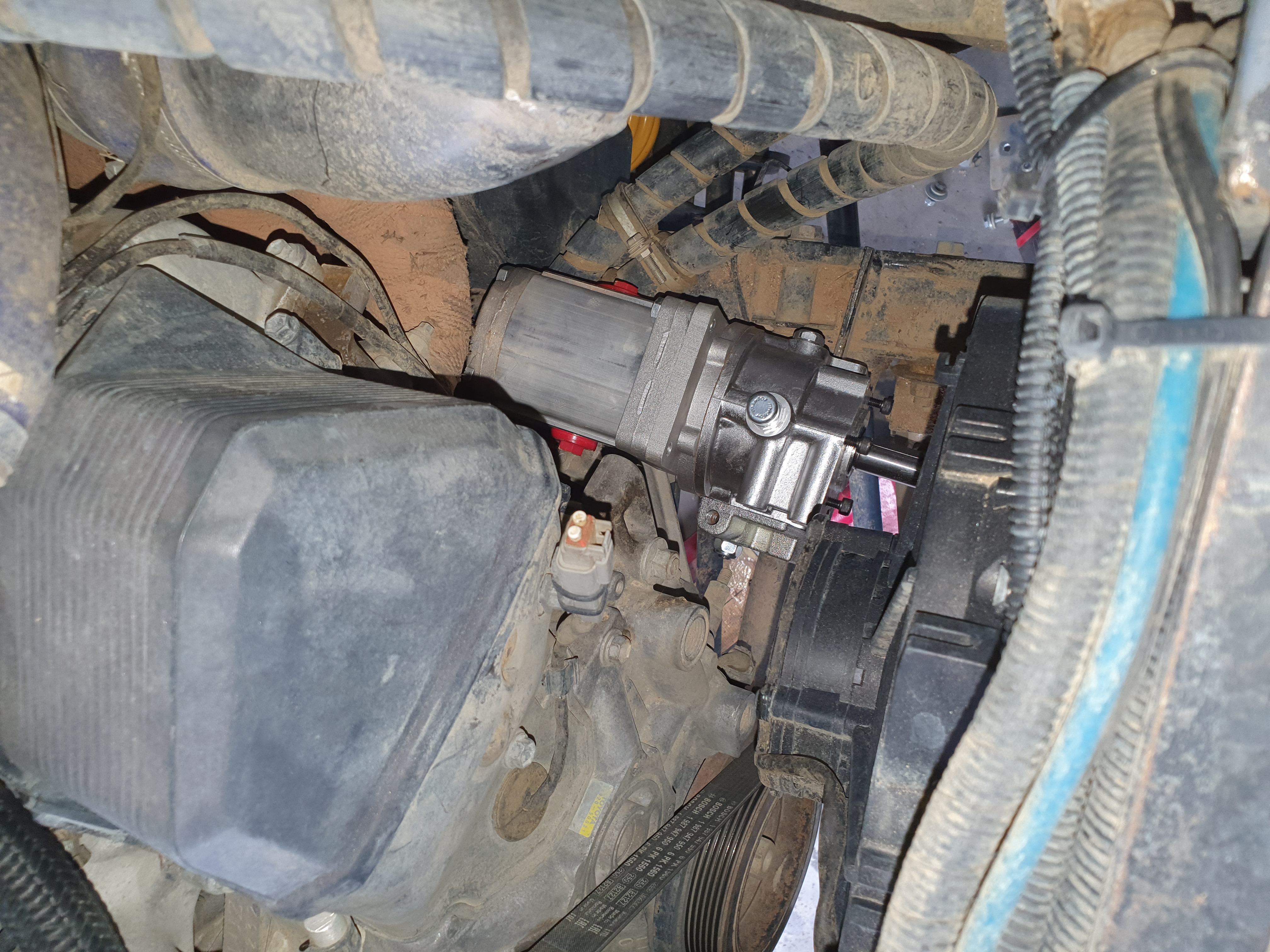

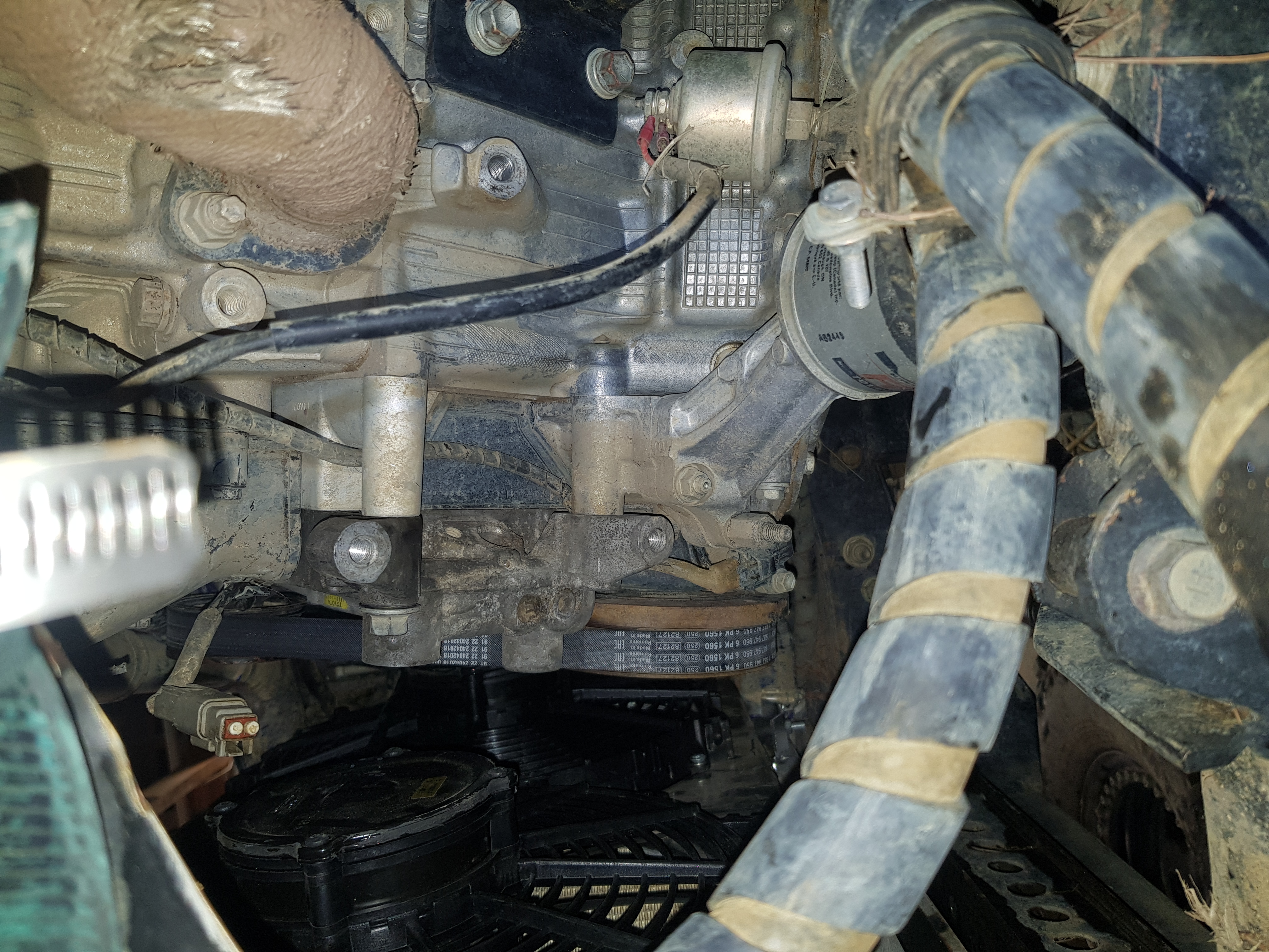

had a brief play with it at the Toyota fest at Hampton downs, was expecting a little more the what was there from there advertised track...

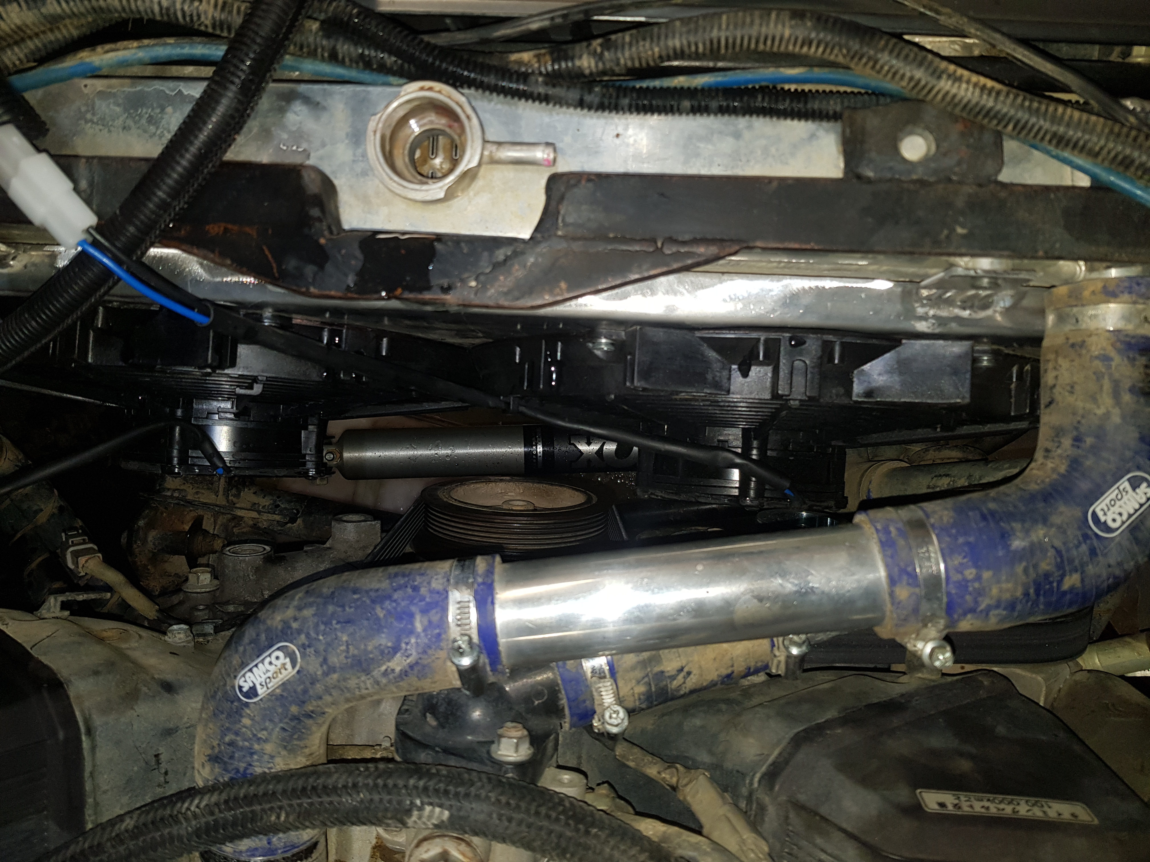

this little water decided to kill my alt and a few idler bearings...
also cooling fan shat itself again- intermittently it would not come on. I think the control valve in the pump was sticky.- but unable to find replacement parts, and now not trusting the hydro fan I've removed it.
made most of the new mount with some high flow 12v fans. this has freed up some extra space now.
potentially look at fitting a hydro pump where the ac pump used to be, and an additional toothed pulley like a lot of poms seem to do on there land rovers.- still a long term plan
also I got sold organic coolant when i first put it together. what a prick of stuff that is, solid jelly clumps clogging up my radiator, intercooler and water heat exchanger.
going to try some coolant flush, but I imagine I'll need a rad shop to try flush it out.

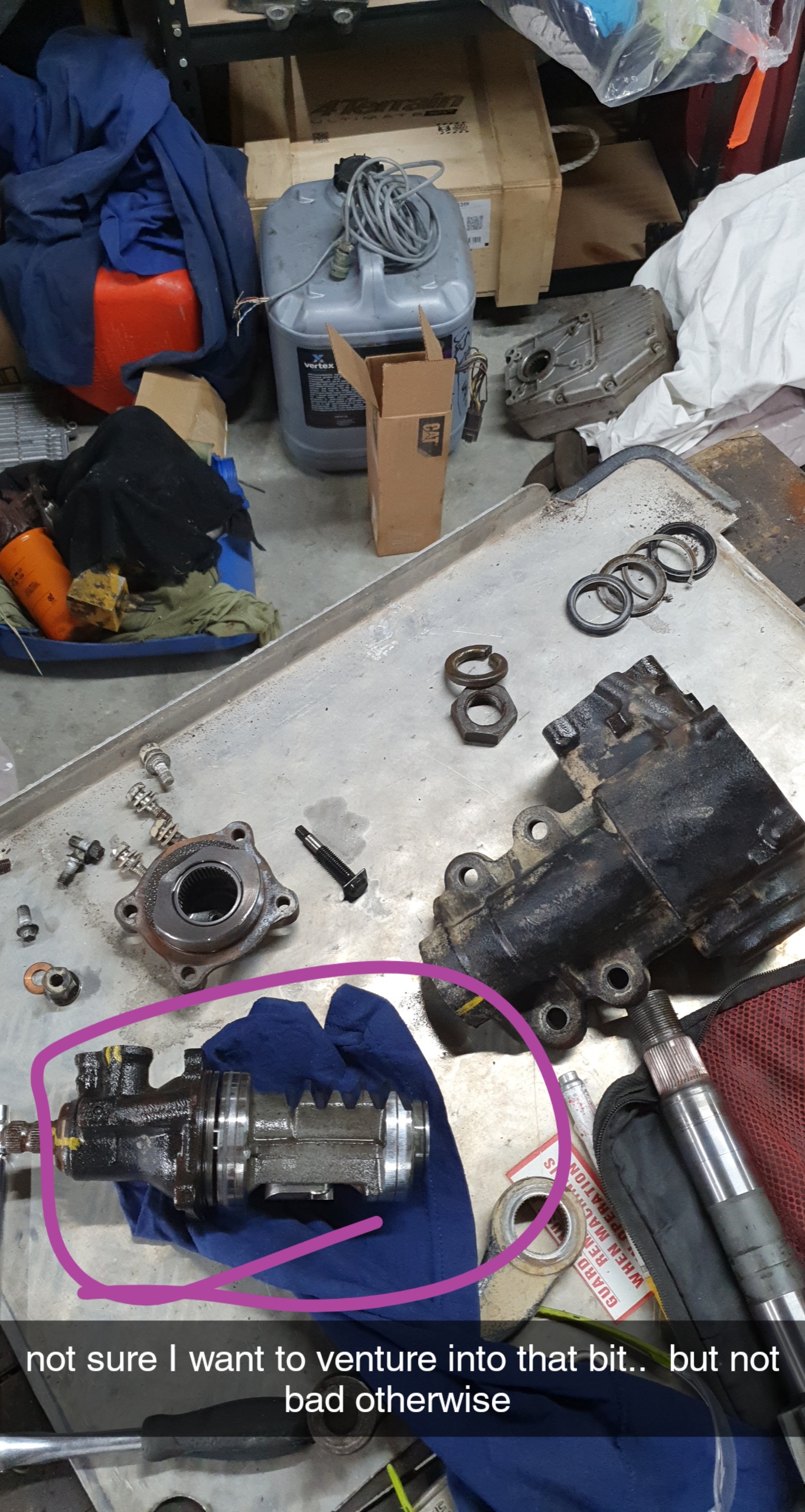

not alot has been happening...or on here at ORE by the looks
steering box started leaking sitting in the shed...
but I've got a plan,probably take another few years to execute...
