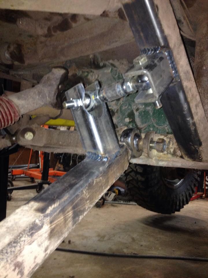

De-Ranged wrote:Just something I have picked up from the desert racing sites they have alot of concern about getting the mount points for the shocks under the center line for the link or they run a stabalizer link off to the side to stop the twist I know your running safari/cruiser bushes but when the axle is articulated what sort of side loads are going to happen?
Yep, this is a "more development needed" section. Haven't even looked at it yet. Basically once I have a final link design I can do a simple moment calc and take a bit of a stab at this. But let's do a rough run through now.
Let's assume that my Nolathane Safari bush will only allow 8 degrees of twist either way from the center (this is a random number based on nothing more than DAMM racing saying their bush only allows 8 degrees total, so if I assume 16 total, maybe that's a good assumption?)
Let's also assume that my primary (combined) spring rate is 150 pounds per inch and my main spring rate is 400 (These are both a little higher than my current calculated rates of 145 and 363) and that half my travel is at the primary rate, and the second half is at main rate. So at full compression I'm getting the equivalent of 4400 pounds pressing on my shock mount (8 inches x 150 pounds + 8 inches x 400 pounds), which is 2000kg which is close enough to 20,000 Newtons.
I'll assume that my shock mount center is 55mm above my link center line. This is 24mm for the radius of my Sch80 tube, 25mm for the radius from center of my shock eye to shock edge and 6mm gap between the shock and Sch80 tube. So 55mm or 0.055 meters.
Now a little trig.
So we want the length opposite the angle that we know, and we have the hypotenuse length. So 55mm times Sine (8 degrees) = 55*Sin(8) = 7.65mm or 0.00765 meters.
Then the moment (Torque) is simply 20,000 Newtons times 0.00765 meters gives us 153 Nm. It will actually be slightly higher than this because the top of the shock will no longer be directly above my link (and all my maths just assumed that it was) but 7.65mm side ways over 18 inches of compressed shock length is less than a degree.
Is that a lot for a Nolathane bush? I have no idea. But I guess it's something I can test. Also it should be close to my worst case example. I would have to be at full bump (which includes 4 inches of Hydro bump stop) and under max articulation. If I can lower my shock mount with relation to my link center line or if my bush rotates less, then it gets even less "side load".
Now I was probably telling you how to suck eggs for a few lines there De-Ranged, but someone else might find it useful.
De-Ranged wrote:just curious since your mounting point for the shocks is the highest stress point when your loading is straight down
It's actually not. A few of the models have highest stress near the shock mounts, but it depends how I build them.
De-Ranged wrote:I would guess the universal ball end in the shock (assuming your planing on decent coil overs) will equalize the load from the shock but the link rotation will mean your load will be at an angle
Yep, think I covered that above. I'm not to worried about it.
If any of that wasn't clear, or somebody can find a maths mistake or conceptual flaw, please do say so.
