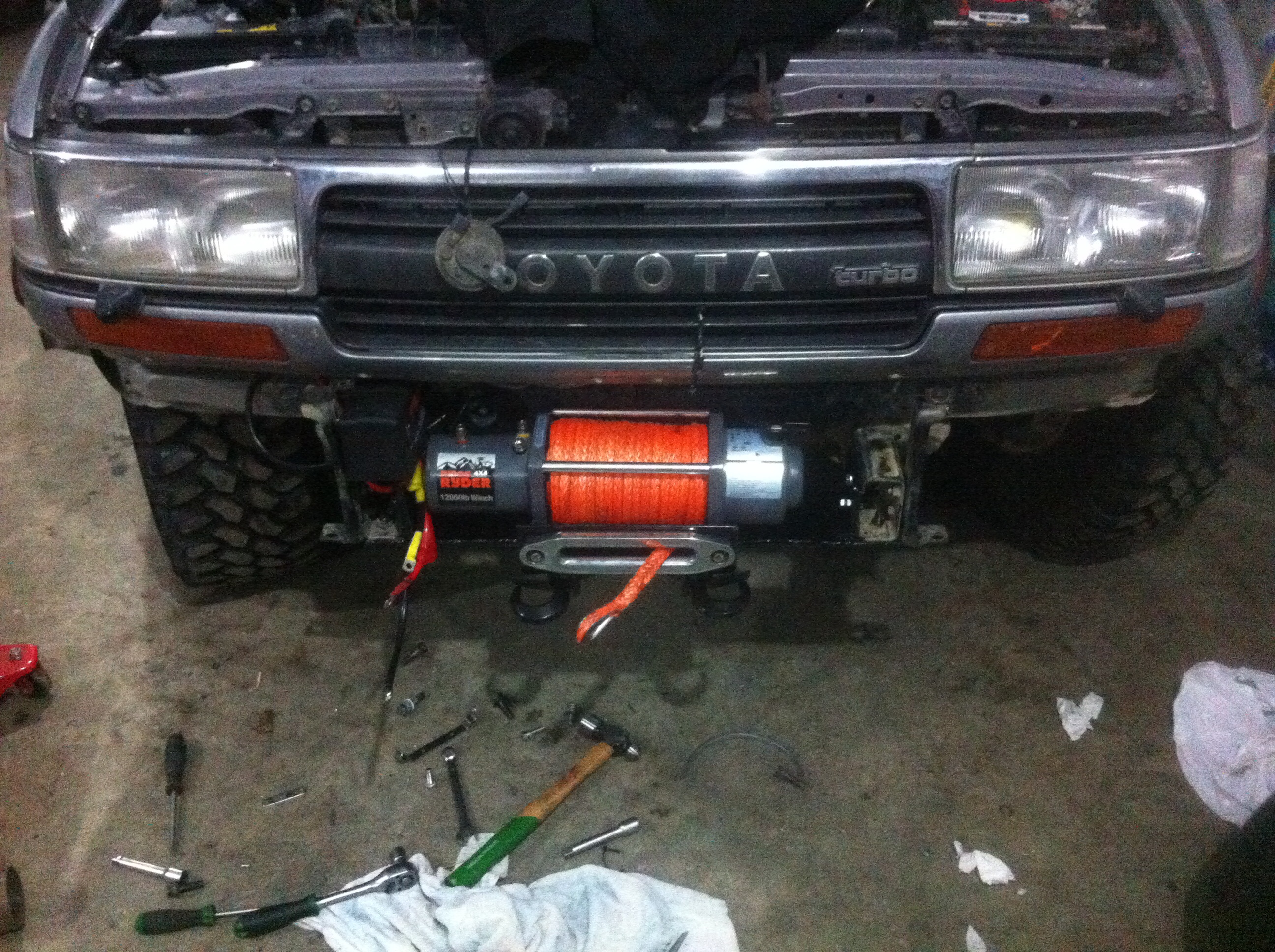

I removed bumper and started work, made a 10mm plate that bolted up to the chassis, braced underneath and on the insides bolted the winch and plate in, chopped out a section of bumper and it sits just behind. I've also mounted the solenoid behind the bumper, took out the vents and everything is easily accessible by hand. Some use a universal winch mount, but I am interested to see how this will go, hopefully my welds hold the tow hooks on... Might have to snatch a tree...

Righto, have removed the winch plate, untested and up for sale haha, I've now found a tjm navara bullbar and cut, welded in brakets and fitted it to the front here's a snap of fitting
