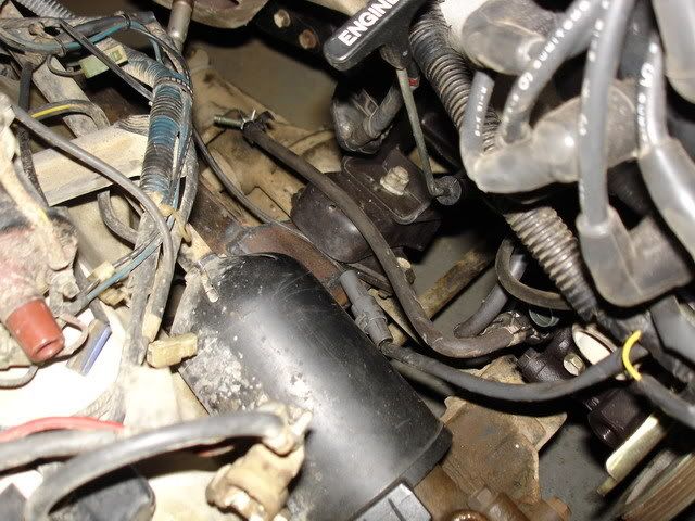

out she comes
In with a new heart!

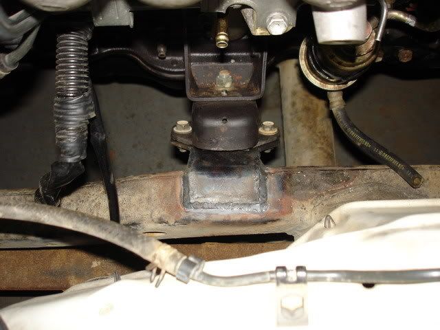

Got the engine mounts done

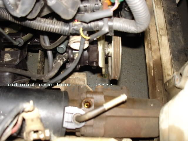

I was a little worried about the lack of room between the steering box and the pwr steer pulley, but a shorter pwr steer belt helped that

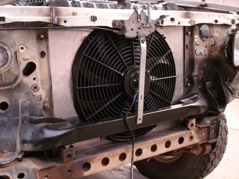

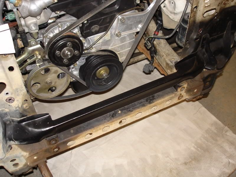

A few pics of the new radiator cross member and fan mount/shroud

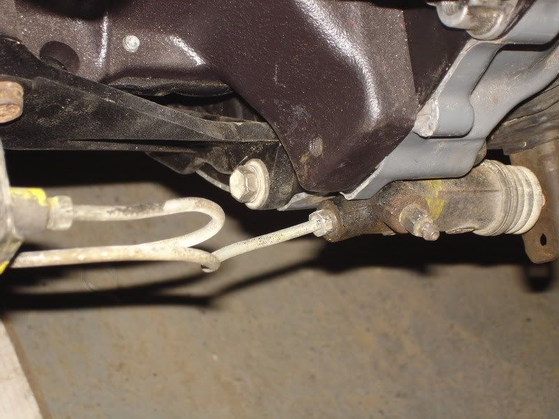

Also a shot of the clutch slave cyl, which is a 2L diesel one and the hardline is the 3Y one I think

Thanks Matt, I have used a recored 2L diesel rad and an electric 16" Wiseco fan off Tardme.

Just enough room between rad and pulleys, mite put some button head screws on the water pump pulley just to be sure
