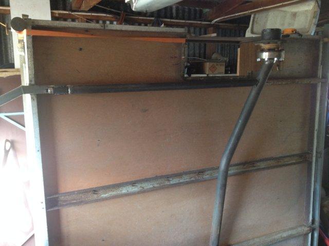

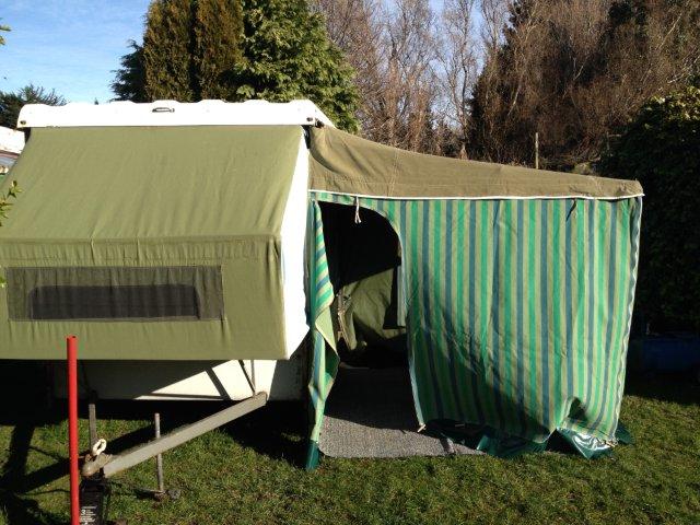

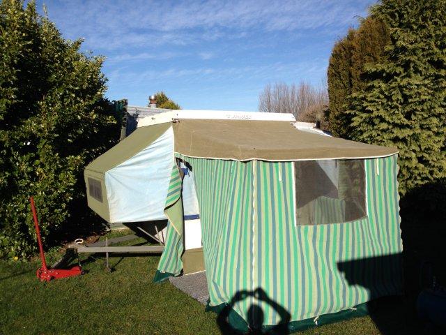

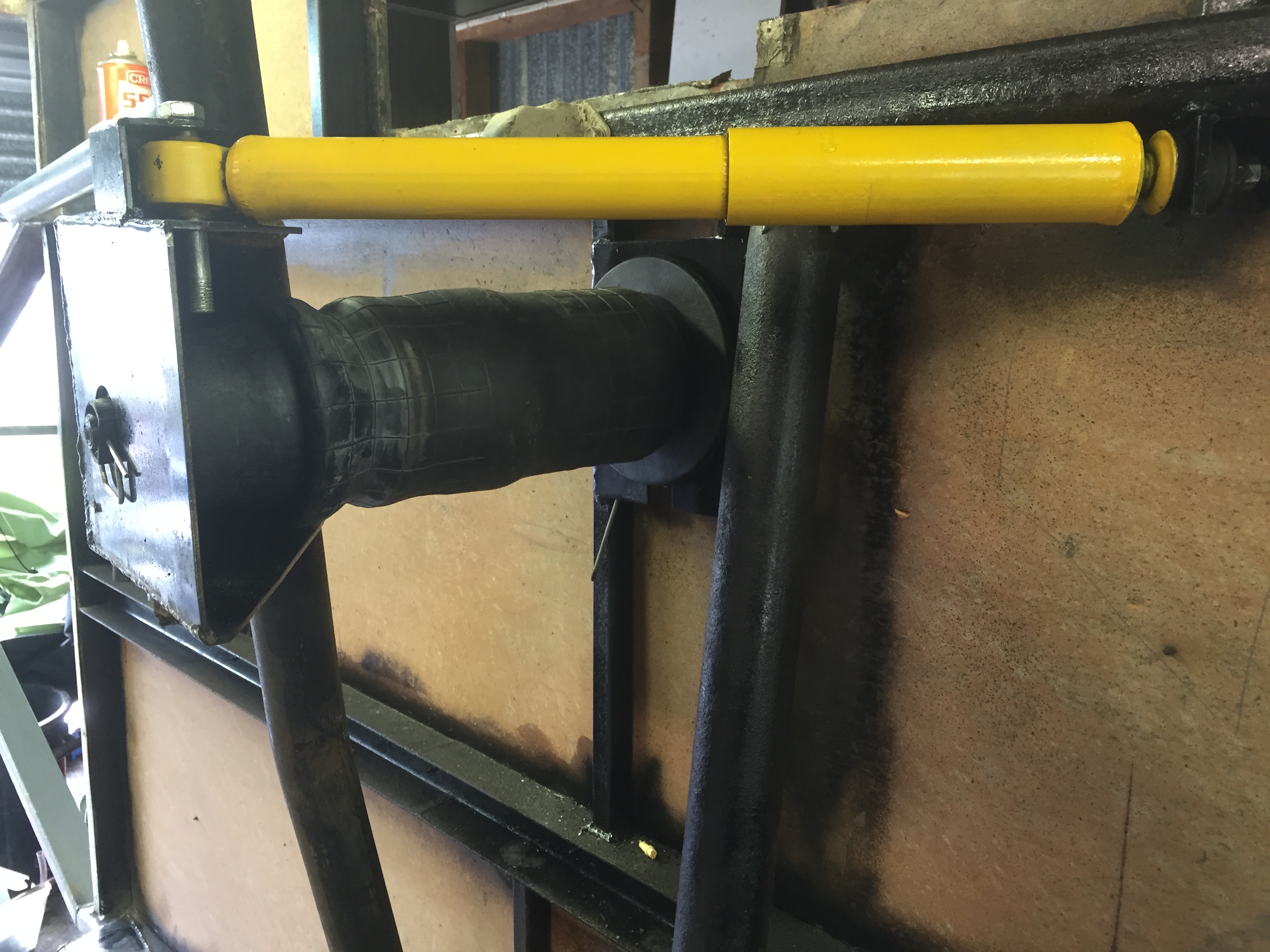

Ok so the project come along from another sprog being on the way (makes 3). Thing is that I like camping and so does my family but with the last few trips ending with a SH!T load of rain it sort of puts them off, especially with the tent being firmly located on the ground.
So along comes the ideas......rooftop tent? No because if you want to go anywhere then the tent needs packed up. Bigger family tent (large canvas type), nope because will need a trailer just to cart it anyway, hence the pop top. Also has a trailer but has a hard roof, 2 queen size beds and keeps the family off the ground.
Anyway i put the feelers out and this is what I got (last 2 pics)

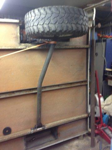

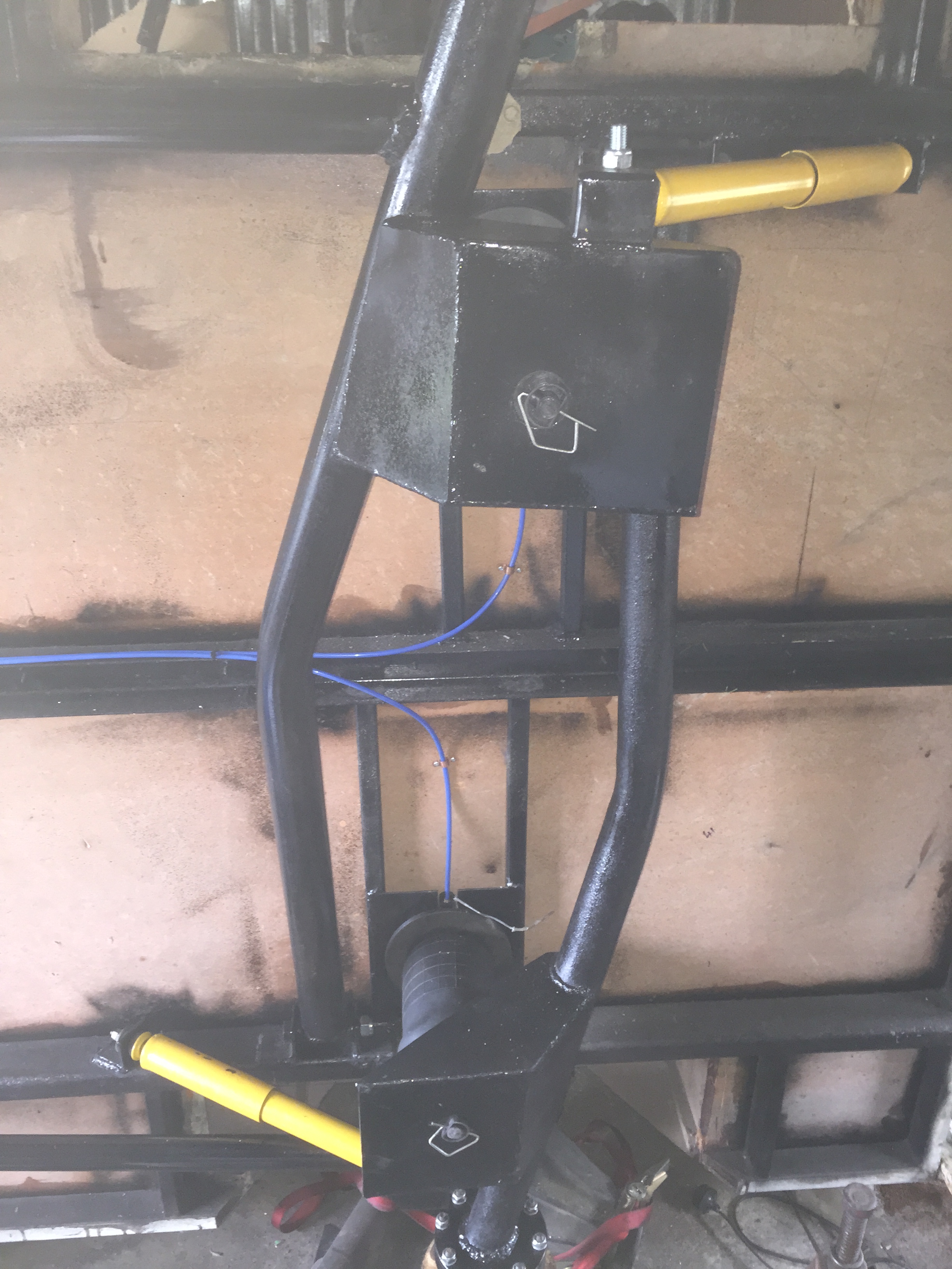

First I went about removing the canvas for some repairs and tipped it on its side to "alter" the suspension. Fighting with a small garage otherwise I would have it upside down.
Got some arms made and had some LJ78 hubs and stubs from another trailer project so there finding there way onto Phillip (thats its name).Also ordered some Rangerover rear airbags from a chinese supplier (yet to arrive). Decided to lift it to make the drawbar level with the surf http://www.offroadexpress.co.nz/Forums/viewtopic.php?f=18&t=30760 This leaves me room to fit 31's and push the axle back 200mm.
The first pics are of the suspension design. Both arms are made and fully welded up. Waiting on airbags and run out of welding wire to finish the mounts off. Then ill add the shock absorber mounts and think about making some longer stays as the facrtory ones wont reach the ground now. Also have to think about a new style coupling as the normal ball/hitch type only allow 15 deg of twist/updown. Thinking of a UJ type.
Bring on the next days off.

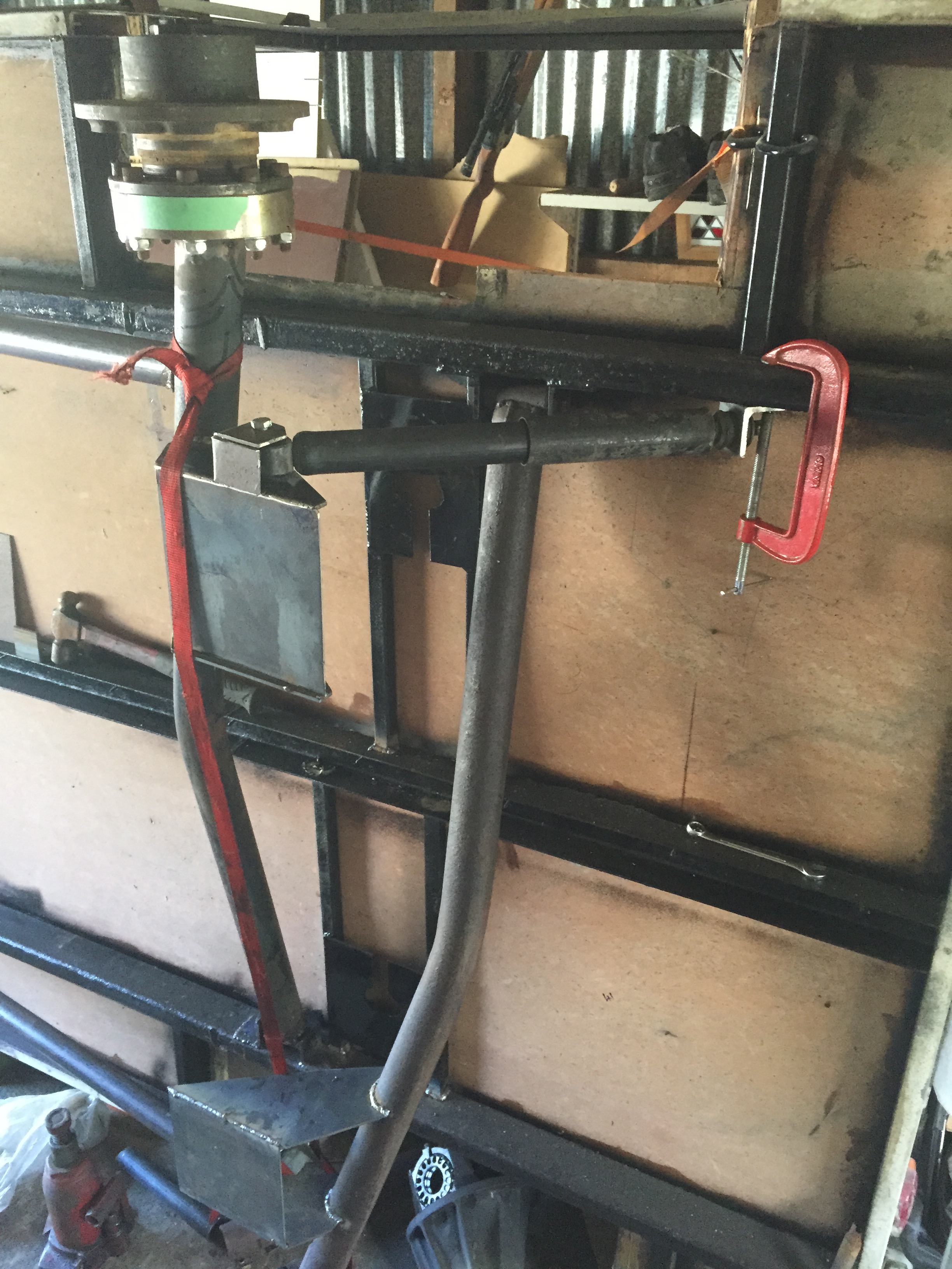

So update time, things have been slowly coming along. Ill get a pic of it on its feet but here are some for the mean time. Just waiting on the mud guards to be folded up and this ill fit those too.
Re: Poptop camper setup for offroad adventures.
Cool
So is it a swing-axle setup or are those axle tubes mounted rigidly?
Out of interest is there any reason you didnt just go for a single rigid axle setup?

Hey mate, sorry the pics are not all that clear. The reason I went this way was to go for an independent setup. I can take some pics of the mountings if you want but basicly the front bushing is setup bundera/rangie style and the rears are just your normal pivot on a pin style. I wasnt a big fan of the flat axle due to the lack of clearance in the centre with the smaller tyres on the pop top (there 31's). I sort of worked on the thought that ill most likley be winching more than most others due to towing a trailer so I may as well help myself by keeping as much clearance as possible.
I hope to get the guards fitted soon so can have some good pictures of it in action.

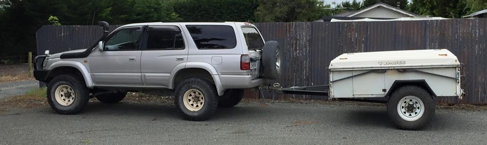

Took the ol girl for a tow down the road, handels the pot holes really well with the camper not even moving over the bumps. Few little things to tidy up and shes WOF time ready for our camping trip.
