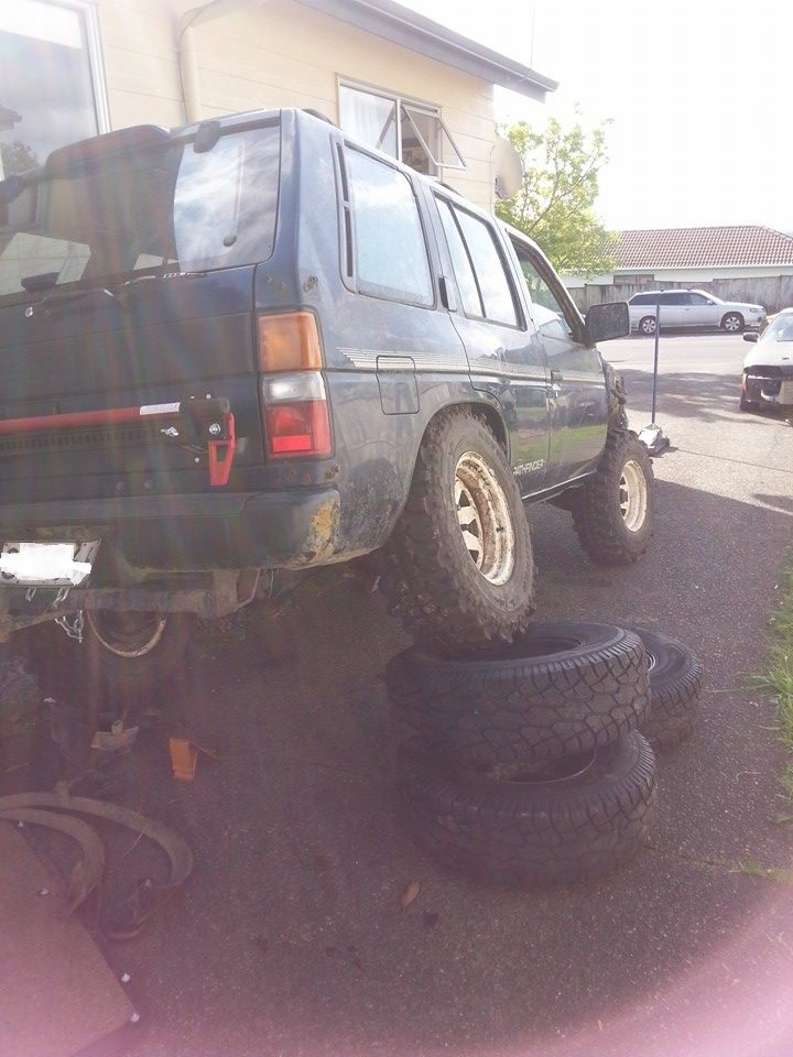

Hi guys,

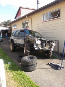

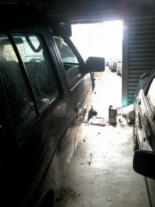

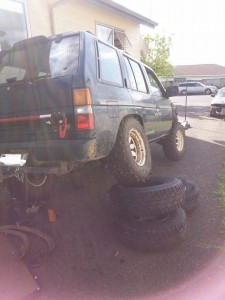

Thought i'd make a thread of my 1994 Pathfinder Bush hack build.
It's a 3 Litre V6 manual. When i first got it, it was standard as with 31" A/T's
I took it out for it's first test run at Woodhill 4WD Jeep park and it was really suprising how well it performed. I had previously been to the park with a friend in his Patrol which had a fair amount of work done to it and the Pathfinder certainly didn't have any trouble doing what we attempted in that. I ended up getting a bit out of my depth towards the end of the day and bent a rim and damaged a few panels so i thought it was about time to start looking into some modifications while it was off the road for repairs at the same time.
Adding to the repairs, i bought myself a 3" suspension lift New tortion bars, coils, front & rear shocks. Aswell as a High-lift jack, Safari Snorkel, 33" Simex Extreme Trekkers and a 95000lb winch
So the work begun...
And this is now the outcome so far..

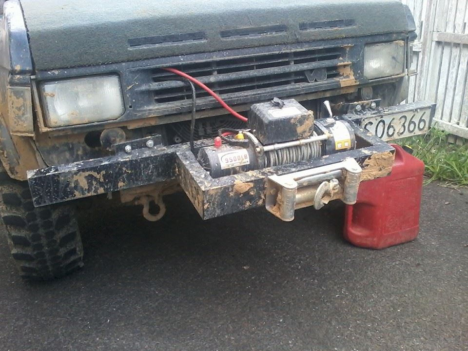

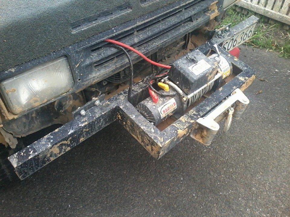

Took the truck out to Woodhill 4wd park in the weekend just gone. It performed so much better this time round! The 33" Simex's and lift have made a huge difference and i was going many places i wouldn't have even thought about attempting beforehand.
Tested out my new winch and winch bar numerous times pulling not only myself out once or twice but a few of the other trucks that couldn't quite make it through. Unfortunately i bent my mounts that hold into the chassis in the front there. I was only running the standard bumper support mounts so this could be why... Does anyone have any ideas on how to strengthen these mounts or has anyone made any custom bars to suit there pathfinder/terrano and had the same issue? Are there any other structural points on the front end that i could also use as supports for the bar?
Re: 1994 Pathfinder Build
Not wanting to be nasty here, but that is one rough winch bar
You will find that you'll most probably get pulled up at WOF time for having too many sharp edges that pedestrians could get caught up on. Plus it hangs off the front by miles!
Surely you'll come up with something tidier and less cumbersome in the future. I understand everything is a work in progress.

yeah i saw your pics in the other thread and thought anything but a staight line pull is going to rip that clean off the truck....
You need to triangulate the force employing the two mounts you have used plus the ones under neath the chassi rail were your tow hooks bolt on also. then you also need to allow for sideways force. ill post up some pics of mine so you can see for your self.
Although this is a 98 mistral the chassi is the same.
I started with just the winch mount keeping the winch as close to the front cross member as possible to help minimise lateral leverage when winching on an angle.
You then need to spread the load force up and down aswell, this is where you need to employ the lower mounts under the chassi rail, this will stop any leaverage up and down you can see the distance between the mounts above the chassi rail to the mounts below the larger the distance the more force it will handle
first page of scribble right hand side is the bit you want to be interested in. this is the winch mount made from 8mm plate steel. the ret of the bar was built off this

you want to try and mount that winch up on that bar not in front of it, chop a bit of the grill out so it can sit right back, get rid of that little push fan to get it right back and make sure you've got a good pull fan on the other side of the radiator don't use one of those useless Chinese ones from supercheep they move fawk all air go up to pick a part and get the biggest one you can find off a big 6 cylinder car

As for the bar, it was just a quick build to see how it'd go. Ideally i really would like a winch bar that houses the winch in close and doesn't stick out far but unfortunately i don't have the skills to fabricate such thing myself. It's definitely the next thing i'm looking into though. If anybody has any good suggestions or ideas of what i could do or someone who could build me one i'd really appreciate it

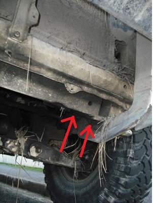

Anyway how about something like this (attached)
Like crash was saying, utilize the factory tow hook points which are in the frame (green arrow)
Then tie the mounting points for the winch frame into the factory bumper holes (red arrow)
ie Where you cut and folded the factory bumper mounts - those mounts are attached with two bolts each side and can be removed completely.
Like derk is saying, you want that winch up on top of the bumper as far back as possible. The bumper itself is fine, just needs to be secured in more places. So if you cut the front frame off, Then if you reworked the upper mounts and added the lower mounts, it would be all good

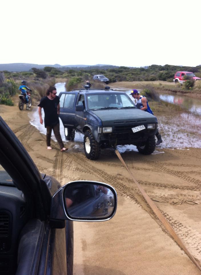

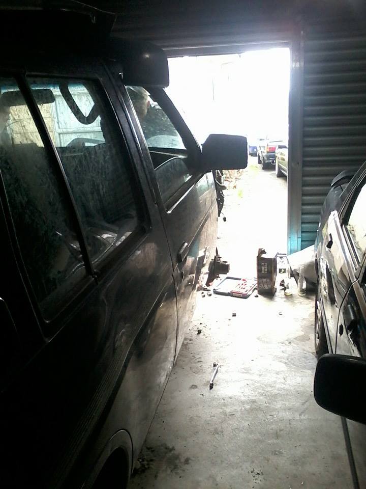

Went out today with a group of friends..
Got towed from the bombing range to Rimmers road by the boys and had a family friend waiting at the entrance with a car trailer to get us home! This lovely chap in his patrol gave a helping hand to get us up through the entrance cause the Toyota's struggled a little with the dead weight of the rano behind them!
It's definitely now time to look into a new engine and i'm thinking about going away from petrol and making a TD42 engine out of a Nissan Patrol fit. Don't know if it's been done before, I'm sure it has though. If anybody is selling or you know of anybody selling a TD42 engine i'd really appreciate a heads up as i'm now on the hunt for one!
I got caught out when i went through a puddle that turned out to be more of a lake. Before i realized, i had hydraulic'd my engine with water staying positive, we tried our best to get it running again with the minimal tools that we had, removed the spark plugs and tried to turned it over to try get the water out, tried crash starting it behind one of the other trucks and didn't have any luck.. I believe that it's now seized and won't be going anywhere for a little while... Got towed from the bombing range to Rimmers road by the boys and had a family friend waiting at the entrance with a car trailer to get us home! This lovely chap in his patrol gave a helping hand to get us up through the entrance cause the Toyota's struggled a little with the dead weight of the rano behind them!
