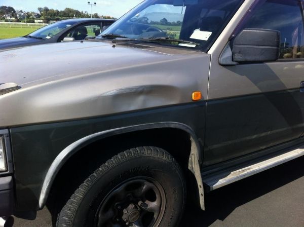

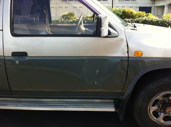

Now as an adult and my career underway I decided it was time to purchase my own vehicle. Enter a 1992 Nissan Terrano, TD27T.
It was a little bashed up around the edges (thanks to a bus & a fence) but as it was to become a offroad vehicle, I wasn't too concerned:
Now (nicknamed "Te Rino" she looks like this:
