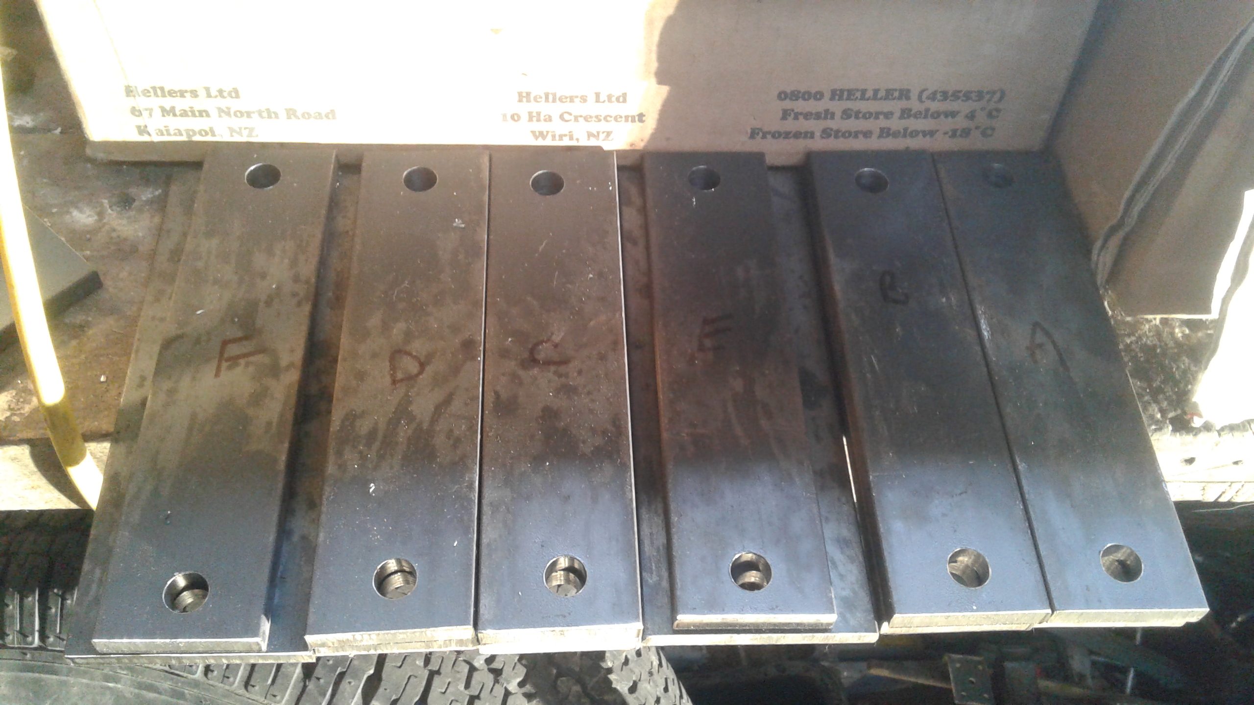

Brackets to fix sliders to chassis.
Start of sliders, bolts will be other way around, just don't want to melt nylons welding.
Hopefully bolt heads won't get caught on rocks or anything.
