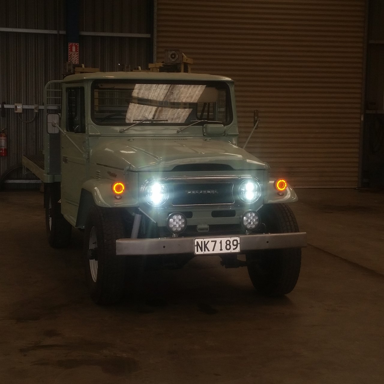

My shiny LED headlights and indicators did get a warrant but I have lost main beam on one headlamp already, hopefully my new ones from Caleb will be arriving soon

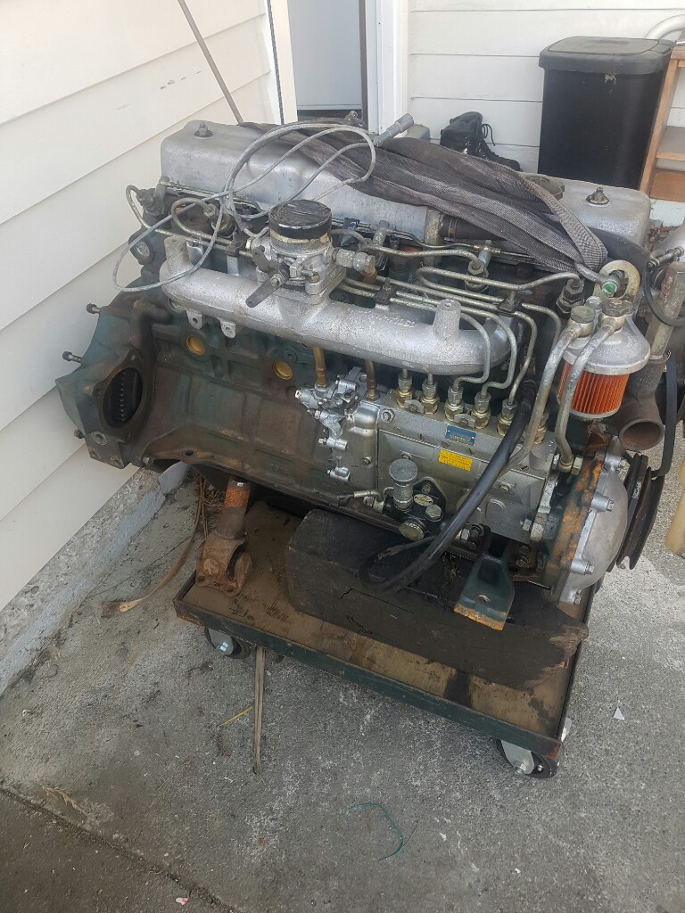

The engine has been running low on power and white smoking so I got the injectors rebuilt to no avail so I had a compression test done and I have knackered valves I was going to rebuild the head but I found a good runner for less than a gasket set so I'm going to try that first. It is a later H and has mounts for EDIC so I'm going to have to make up new linkages for the throttle and stop. They are quite different to the old setup.

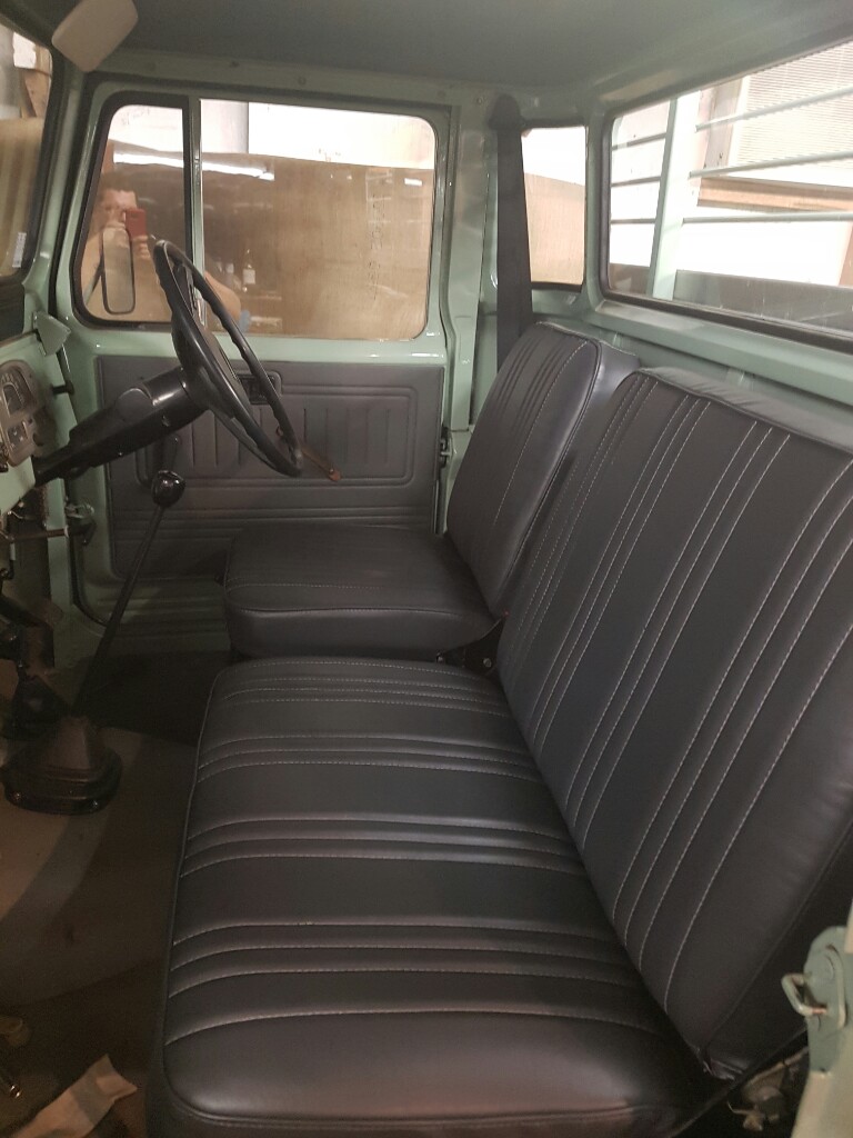

While it has been idle I have had the seats recovered and found some old stock door cards from Japan. Now I'm having to get all the silver dash bits painted as it all so clean inside now!
