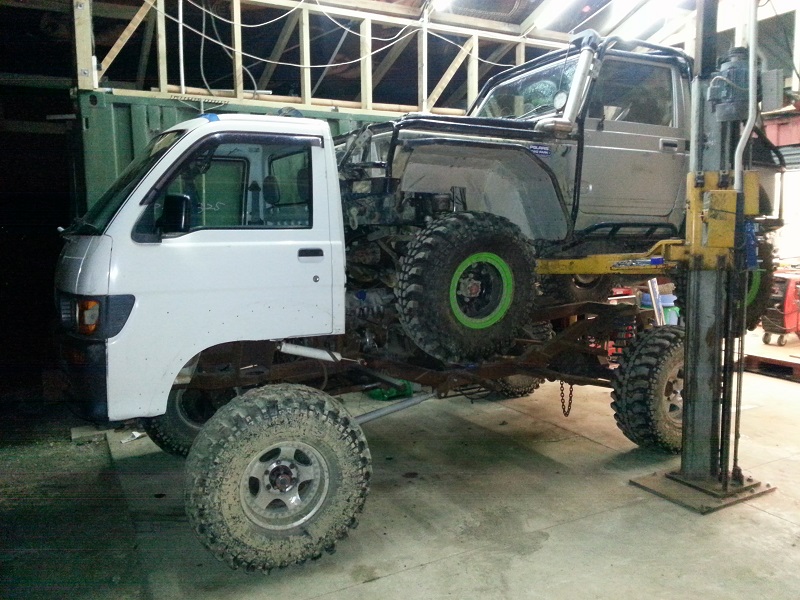

Found My new project. Built by a guy in Hamilton, but work and kids means he had no time to finish.
Full custom chassie, 5 link front and 4 link rear, fj45 axles, hydro steer and mid mounted ld28 turbo.
Set up for dual wheels all round.
Heaps to finish but the major stuff is done to a very hi standard.

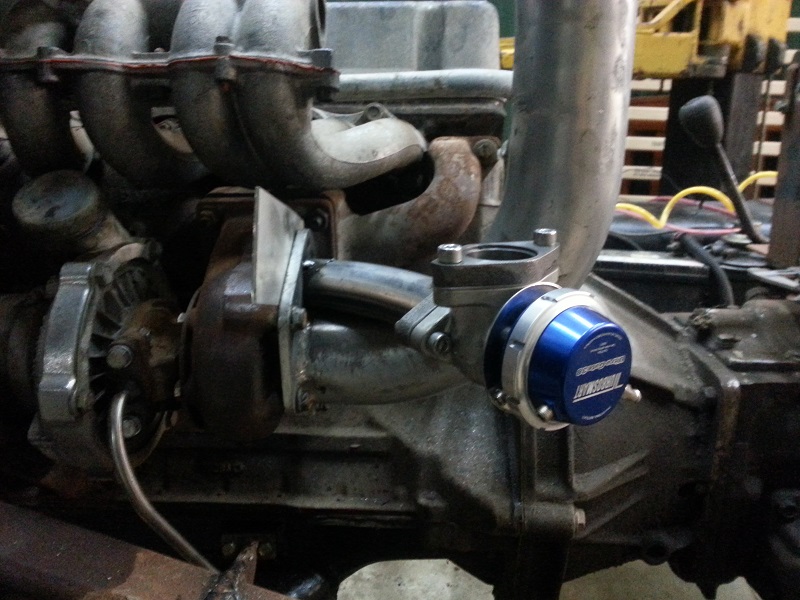

Got the motor going runs mint. Needed a new diesel stop solenoid. first start up couldn't stop the thing ha ha.

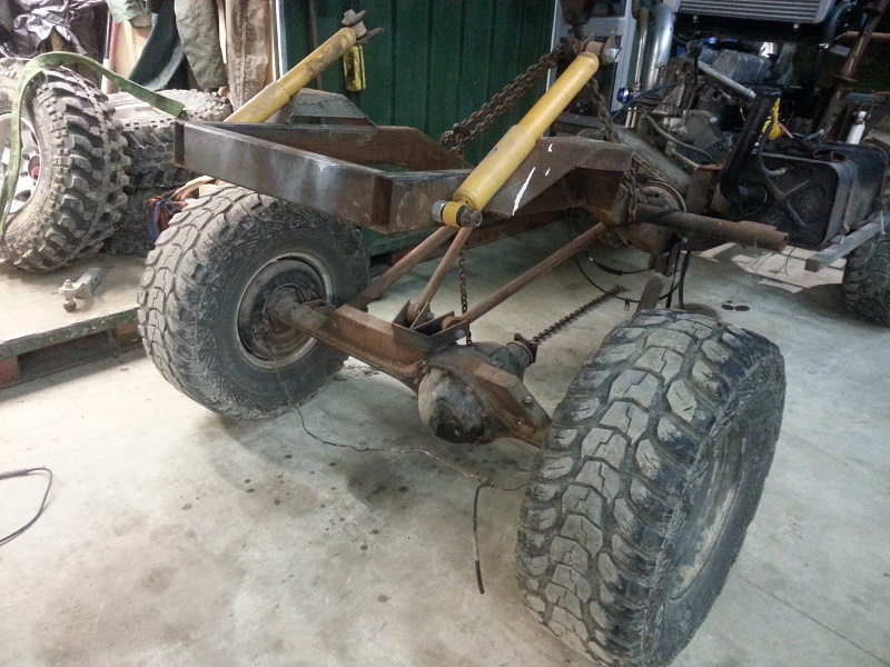

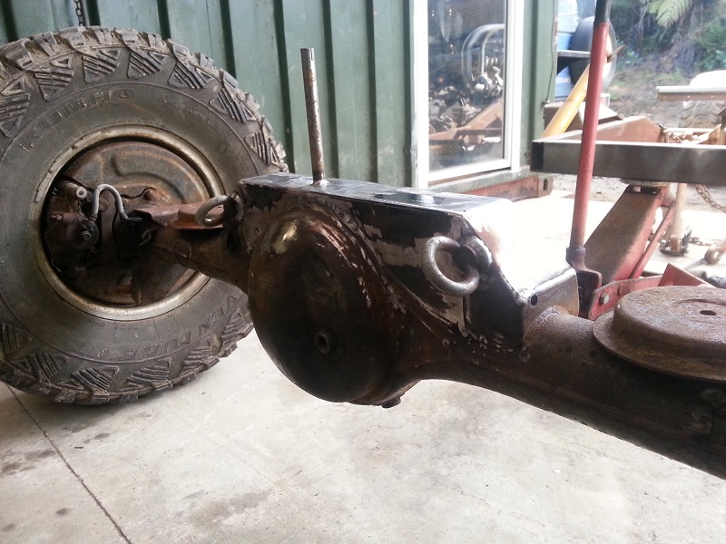

Started to realize this was a big project so decided to make it worth the trouble. So new strong axles where needed. Parts Safari
Re: Lobstrosity
Front axle.
Re: Lobstrosity

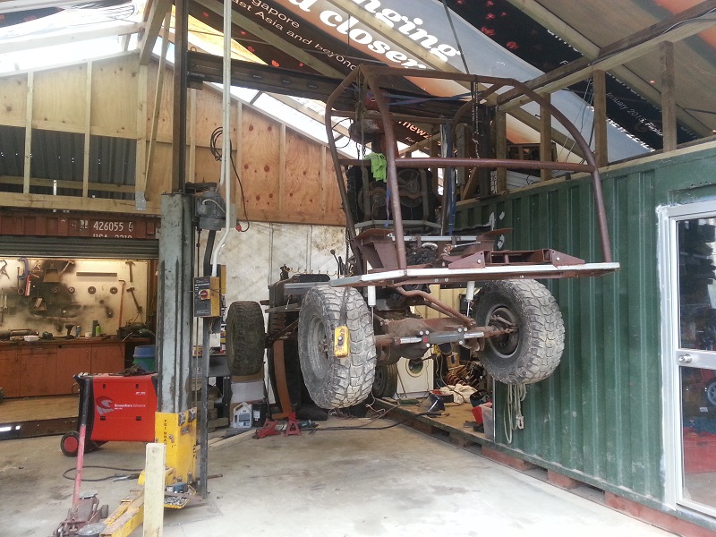

So that up to date. Had the cab back on for Tyre clearance measurements. Had to fit 35

So what are you going to put on the back of it
my 4wd is not a truck
Re: Lobstrosity
The plan is to have a flatbed on the back. And if all goes to plan to cert it and use it to transport my Suzuki to 4x4 trips.

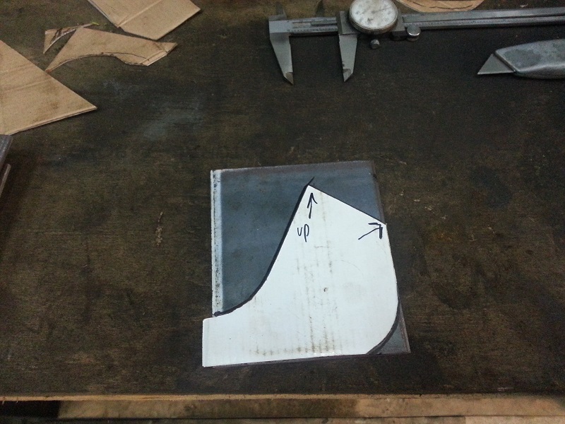

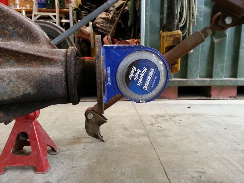

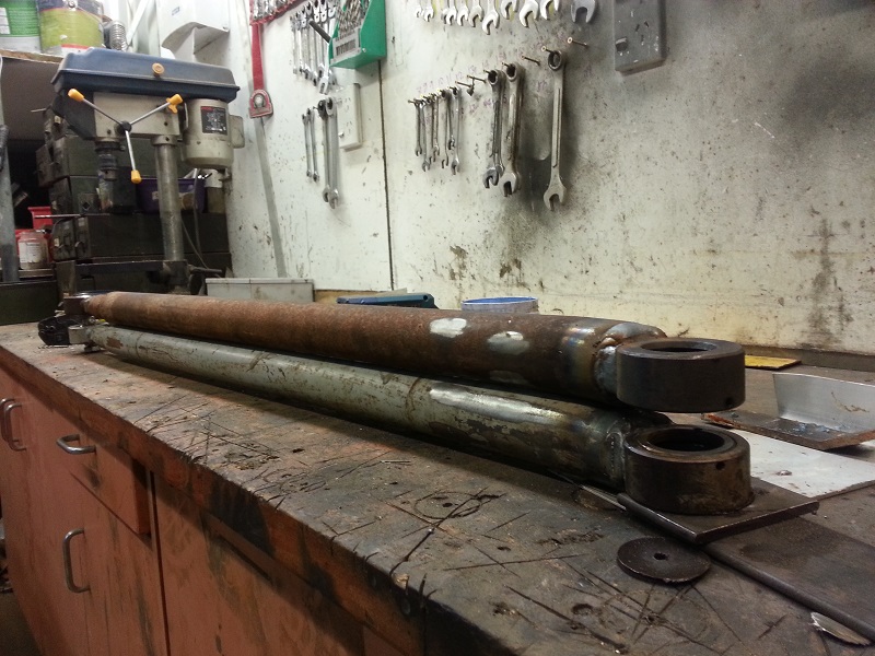

Bit hard to set up a 5 link with the rear steering arm out the back. Put a bend in the bottom arm to miss it.
Re: Lobstrosity

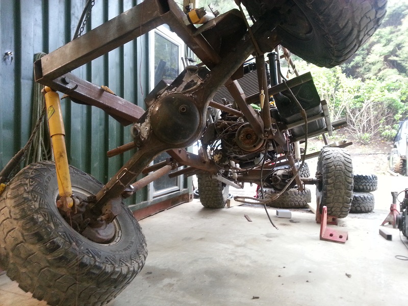

New top links to make them 70% the bottom ones.
And some spring retainers.

What are your link ends? Custom housings with spherical bearings? If so, got a part number on the bearings? I'm deciding weather to go this way or just buy rod ends from Ruffstuff.
Yeah you might want to look in to the hydro steering legality. I believe you are only allowed hydro assist, but I don't know for sure.
Glad you went Saf axles. I think anything less would have been wasted effort.
Re: Lobstrosity
Yup gave up on the hydro steer when i decided to go road legal. Keeping all the steering Nissan patrol.
Rod ends are huge, they take a 16mm bolt. They from
