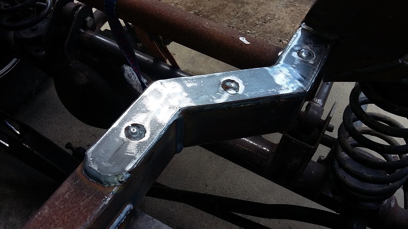

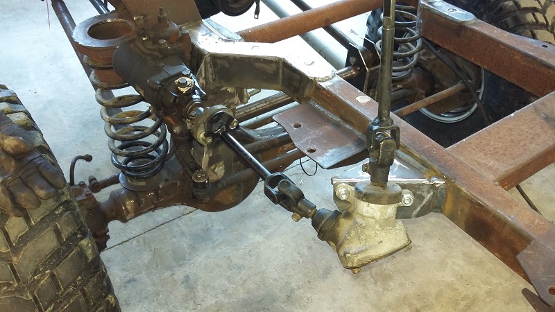

Got the steering mocked up, started gusseting up with some 6mm plate.
Mattrade
Posts: 377
Re: Lobstrosity
Postby Mattrade » Mon Dec 07, 2015 7:01 pm
Nice and solid to start building off.
Mattrade
Posts: 377
Re: Lobstrosity
Postby Mattrade » Mon Dec 07, 2015 7:07 pm
Pan hard bar chassis mount/steering box mount.
Mattrade
Posts: 377
Re: Lobstrosity
Postby Mattrade » Mon Dec 07, 2015 7:13 pm
Steering mounted up 8)
Mattrade
Posts: 377
Re: Lobstrosity
Postby Mattrade » Mon Dec 07, 2015 7:23 pm

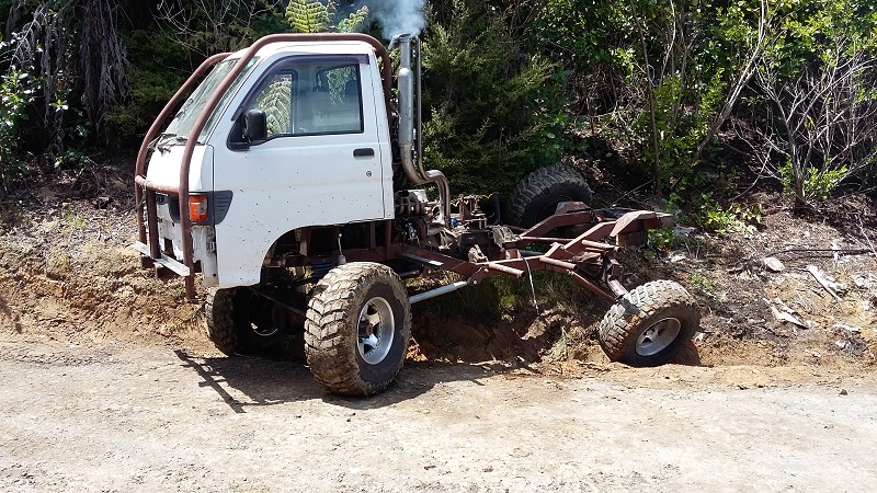

Rolling on all 4 steering and engine running mint. Clutch hooked up and breaks plumbed up to front. Drive shafts hooked up but thought i could get away with rear axle drive shaft misalignment but its just to much. Will drive with no springs in the back but fouls on droop. :roll:

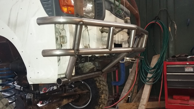

Started to build my front bumper while i save up for a new power plant and transmission.
Going for a silver top td42 and auto :D Deisel POWER

The reason for the change, huge drive shaft angle :roll:

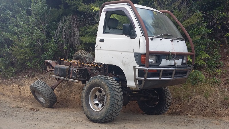

Mattrade
Posts: 377
Re: Lobstrosity
Postby Mattrade » Tue Jan 05, 2016 6:56 pm

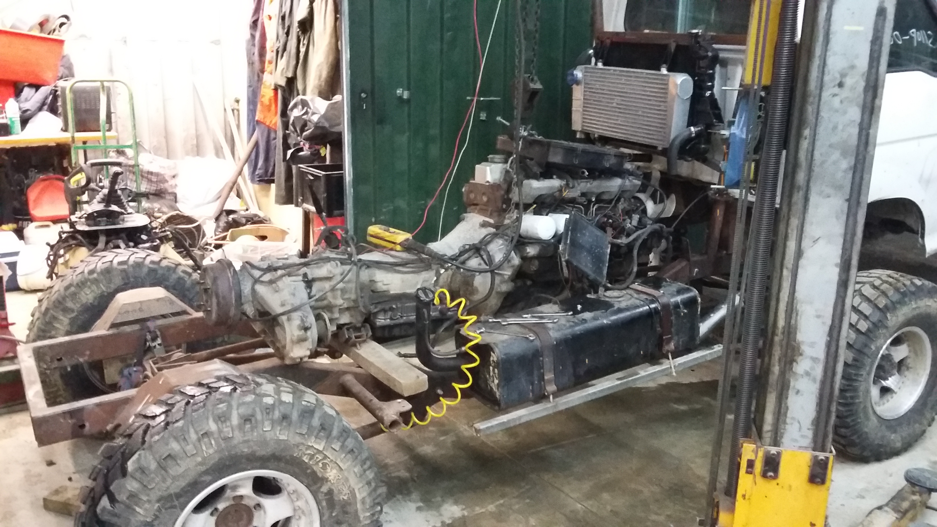

A quick 11 hour drive to New Plymouth - picked up a 4.2 silvertop with auto box. With 172k on the clock.
Started it up on the workshop floor... started after 2 cranks and no smoke - so stoked 8)
So drive shaft angles are no longer an issue but its ####### long as hell so the hole truck is getting extended by 350mm!!!!!! :oops:

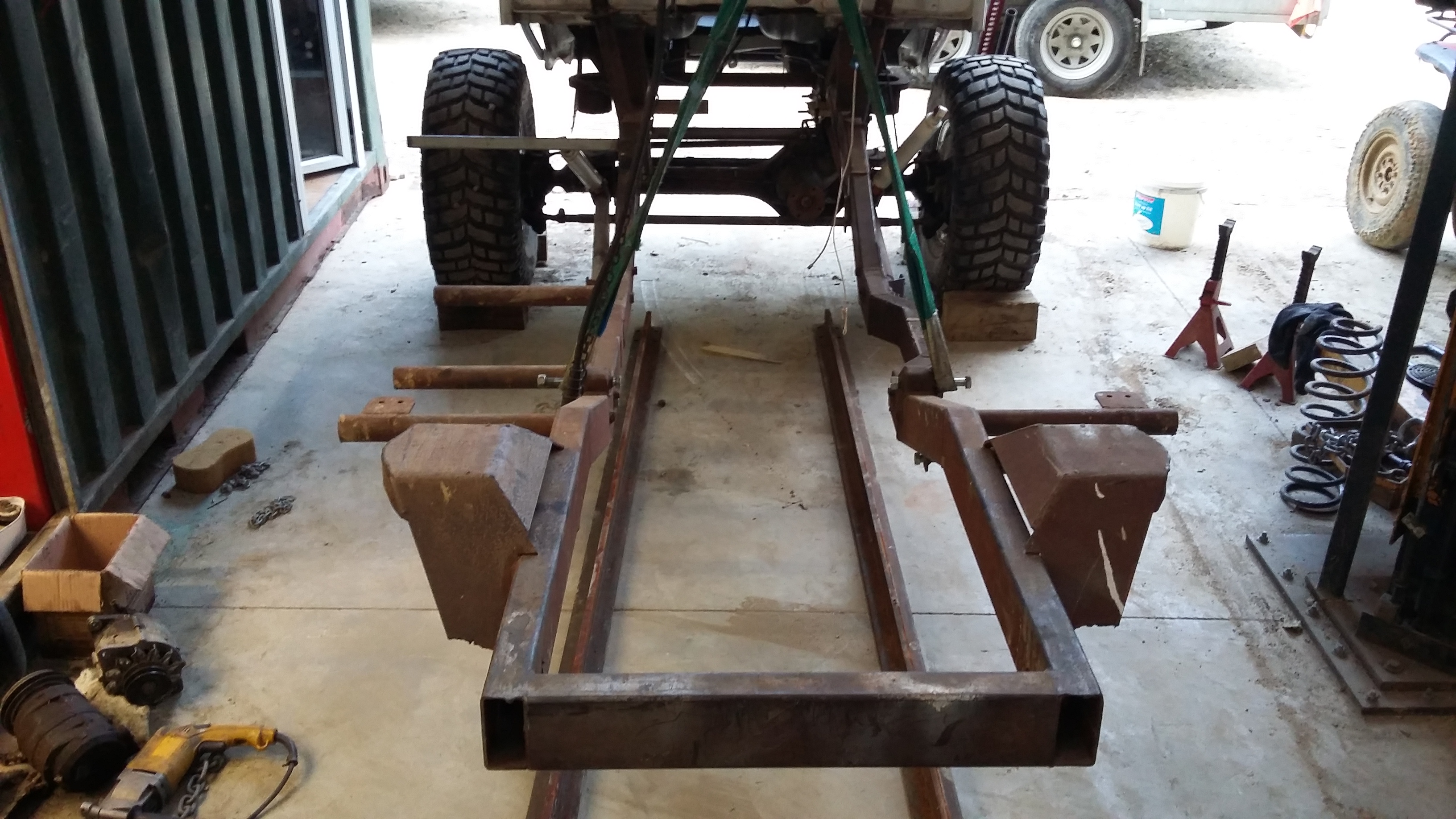

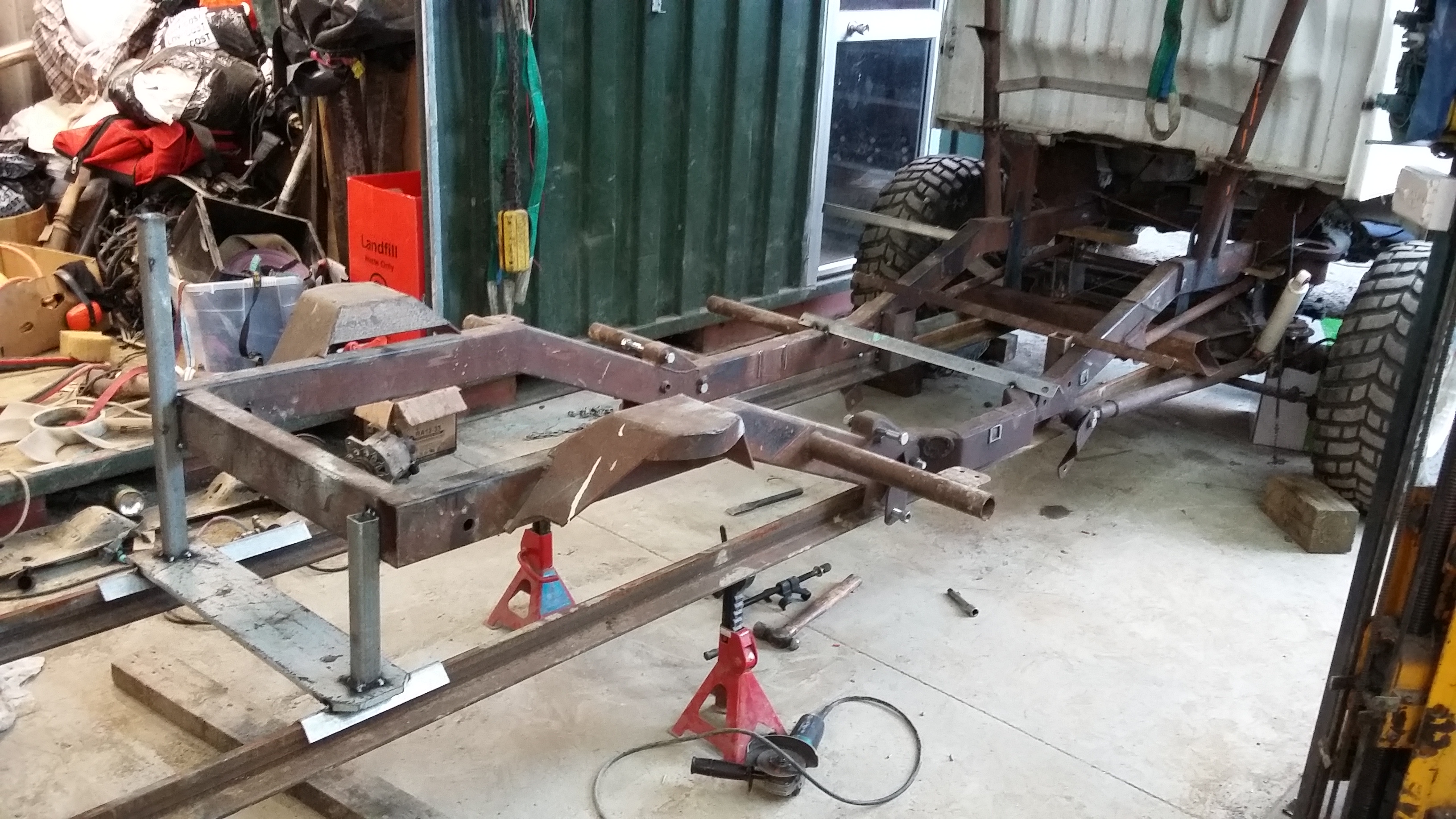

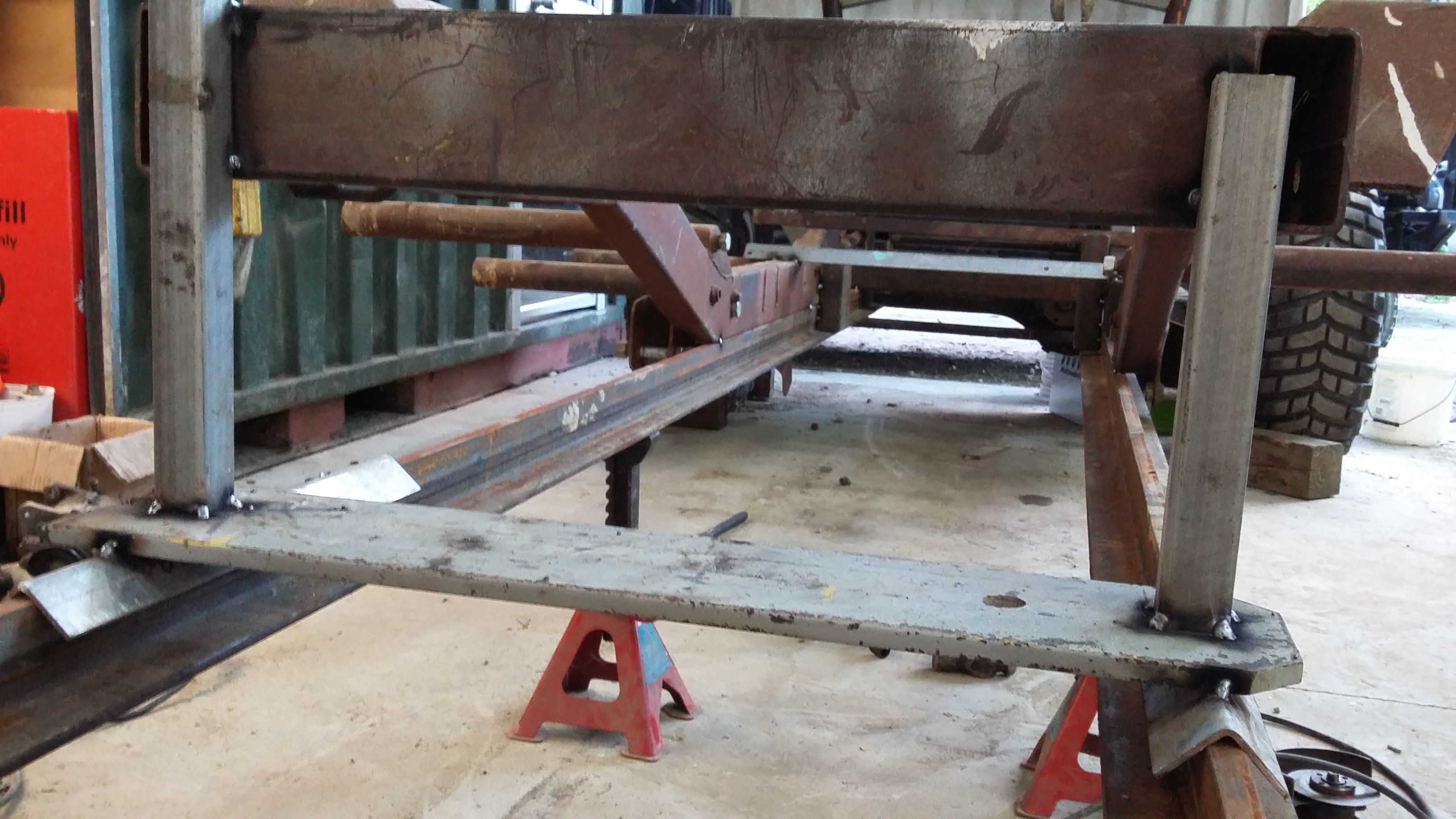

Got down to chopping it in half. Started a new job in the lift industry so have a few big steel rails that lifts run on and thought they would be perfect to use as a jig to line everything back together and stop it twisting as i weld it up.
Mattrade
Posts: 377
Re: Lobstrosity
Postby Mattrade » Tue Jan 26, 2016 8:26 pm
Extended and fully welded ready for a 5mm plate to stiffen the joins up. Also going to gusset the inside just to make certain its good and strong.

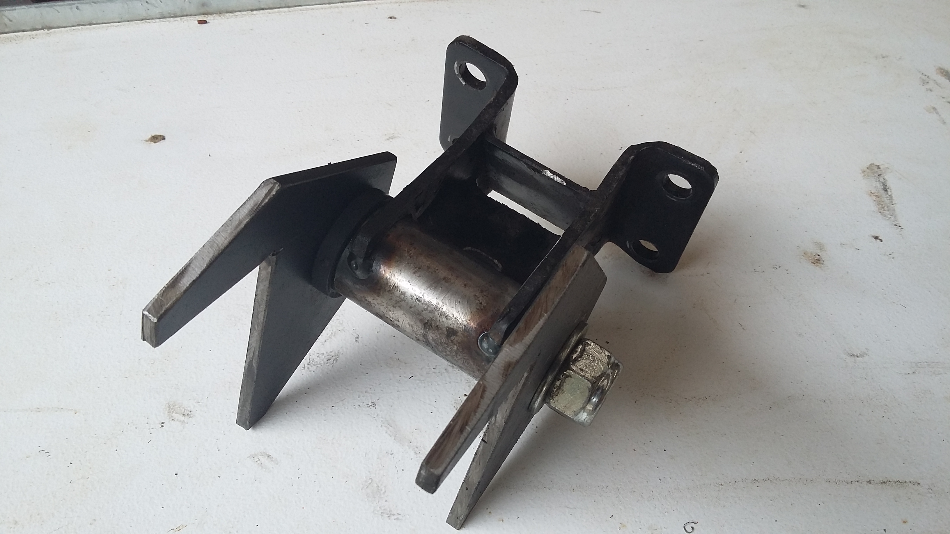

Postby Mattrade » Tue Jan 26, 2016 8:41 pm
All the engine mounts where worn out and one missing. Thought i would make some super strong ones.
Found leaf spring bushes from Repco, 34 OD 18 ID for 5 bux each.
Used thick wall 1.5 inch tube and a M18 bolt with Nylocs
will do the same for the gearbox mount.
mudlva
Posts: 2917
Re: Lobstrosity
Postby mudlva » Tue Jan 26, 2016 8:47 pm
Use a m12 bolt and fit a 3mm wall crush tube otherwise you will destroy the rubber ends.
I used similar idea but used a l.c. radius arm bush.
Great feeling knowing that if the rubber lets go it still cannot part company from off the chassis mount.
Mattrade
Posts: 377
Re: Lobstrosity
Postby Mattrade » Tue Jan 26, 2016 9:05 pm
Dam wish i had realized that ha ha but your right. Easy ish to fix.
Thanks man

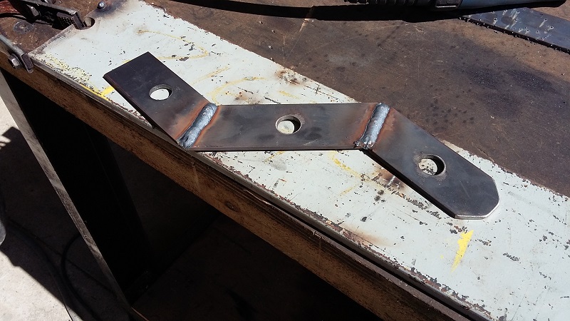

Postby Mattrade » Sat Jul 16, 2016 9:34 pm

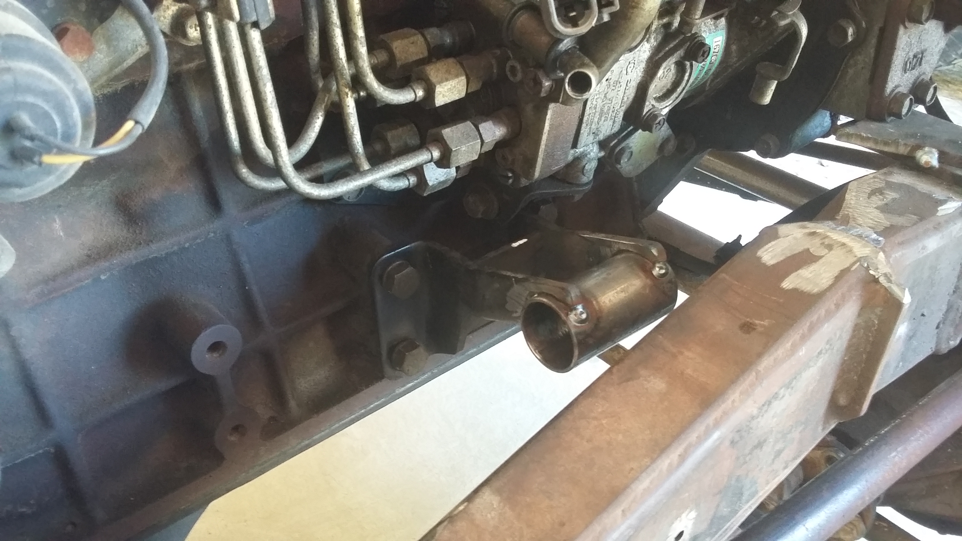

Rear gear box mount. Made a crazy wrap around mount to get it nice and high out the way of drive shaft.

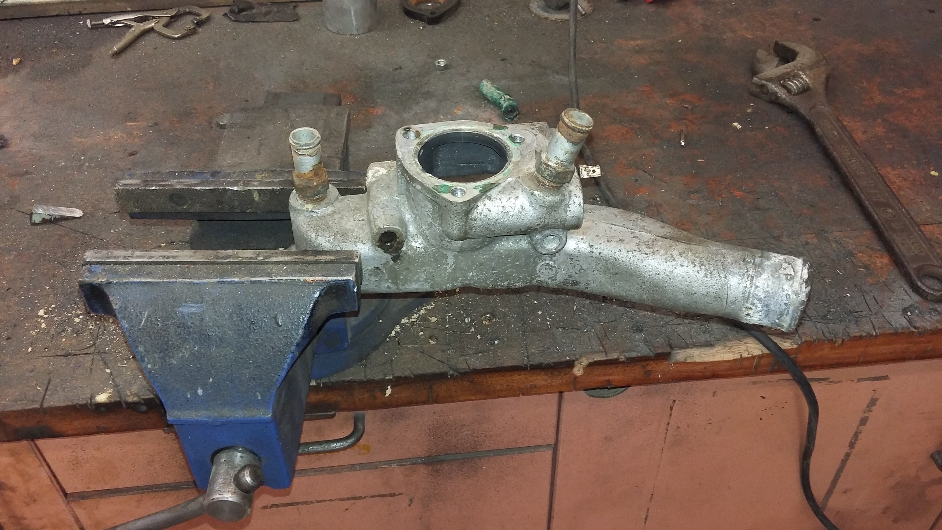

Thermostat top housing cut and turn and shifter install.
