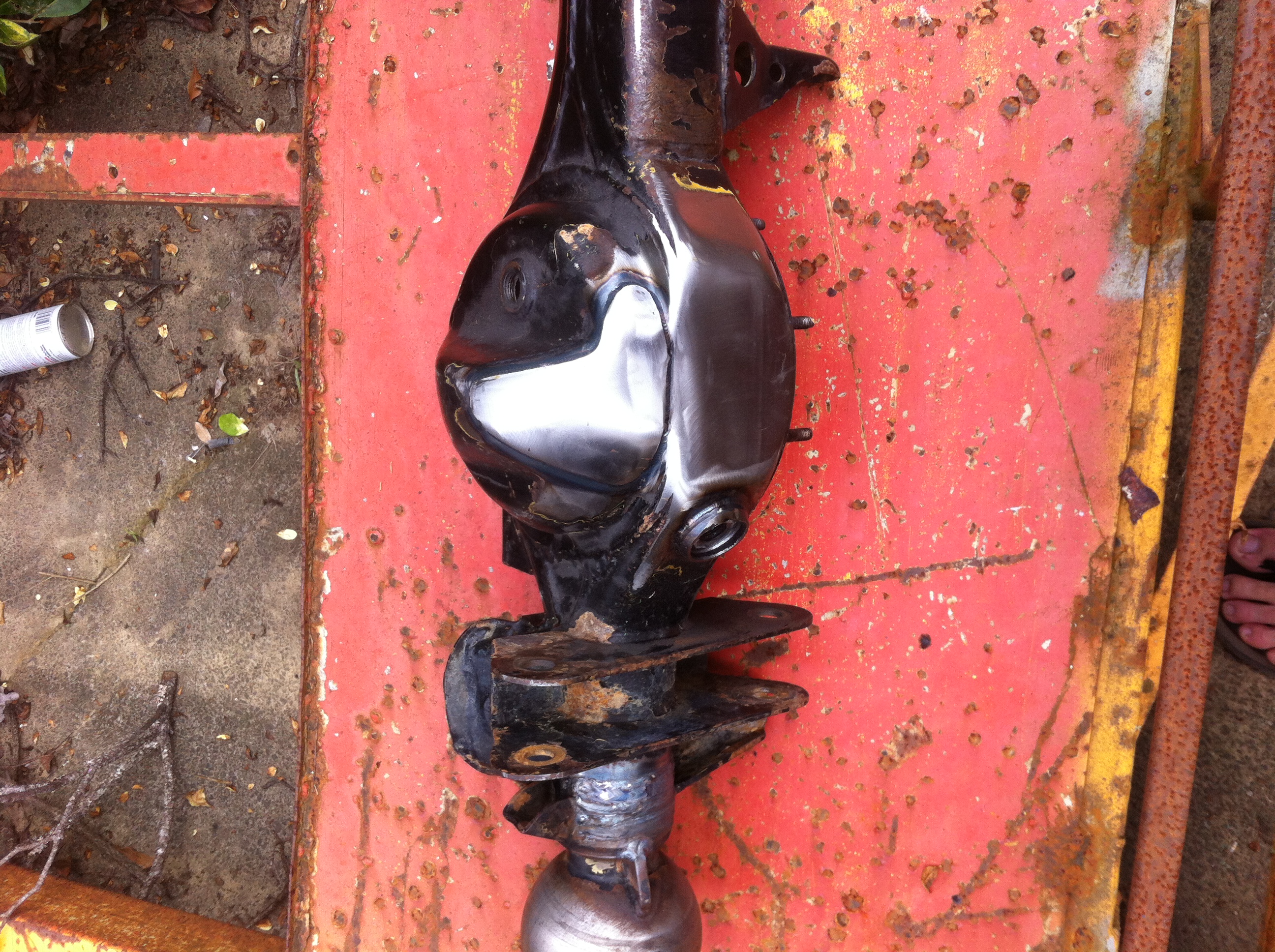

I need to do some welding on my diff housing, but I don’t want it to bed and bow. What is the best way to get around this? Preheat the area I am welding? Tack the housing to the bench? Brace it before welding?
I need to fully weld the box to the housing in the notch that I have cut out in the housing

I've welded more diff shaves than I can remember lol after all them I've come to the conclusion after trying alsorts of different ways the most accurate is to tension the housing in the opposite direction so when I weld the weld shrinkage pulls it straight again.....I have a jig I've built to do this
Sorry I've had a look through my photobucket and can't find a pic of the jig (plenty of diffs in it but non that show the jig...) I've used a piece of I beam that has a couple of chains at the ends that I can tension to pull the diff.... for what its worth I pull a hilux diff about 10mm on each leg prior to welding and this is usually within 1/2 a degree of true
if you do get some pull from the weld that bends the housing you can counter this by heating a 50c sized area on the opposite side to cherry red with a gas axe then let it air cool all the way to room temp and measure again each one of these will pull the axle around half a degree

I too use a chuck of I beam (well actually 2 pieces of 200mm channel welded back to back) with chains and a bottle jack. Cheap jig to build, works mint.

OK, so prebending the housing is the best way? Holding it rigid when doing the welding isn't enough? I'm sure I could work something out. Thanks for your help guys!

If I was to do a diff shave at the same time as welding that box in, which way would I prebend the housing? The shave is obviously welding on the bottom of the housing and the box is on the top. Weld one, let it cool, flip the housing over, pull the opposite way and then weld the other?

Ive always done the shave with a diffhead bolted in and made the filler plate a exact fit, havnt had to many issues sofar

Madaz wrote:Ive always done the shave with a diffhead bolted in and made the filler plate a exact fit, havnt had to many issues sofar
I also use an old diff head that I cut down and can fit a true'ing bar through it so I can see how much I have moved it when I pre tension and how much I have to correct the diff to line it up again.... all that said I personally think they can stand a fair bit of miss alignment, the reason I go to the level I do is if your charging for service you do it properly and I can say to the client it is true and mean it lol
Oh also I do way more than one plate when I shave lol, I shave the axle angling out to the axle tubes I then shave the diff pan about 1/3rd of the way up

If you truss the top & shave the bottom it all evens out according to my wheel alignment report
Good advice from deranged though - if you want to be fussy I'd do each bit separately, prestressing it to suit.
