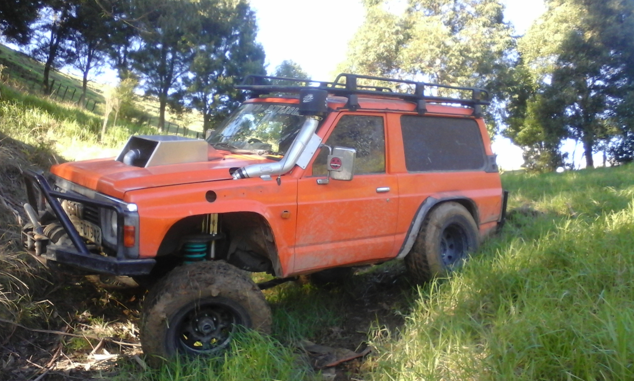

td42 na manual 2" suspension 2" body lift pto winch.
first step was remove the body lift,guard chop, radius arm spacers and 30mm trim blocks and 80 series bumps.
huge difference very stable truck.
then some barwork happened.
opportunity came up and now ive gone to town.

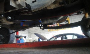

buds long arm kit.

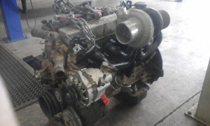

12mm 1hdt converted pump.
cat turbo .
custom intake an cooler.
new clutch.
3" flexy coils etc etc

armada 4" lift 80 series shocks in front an 4" gq rears

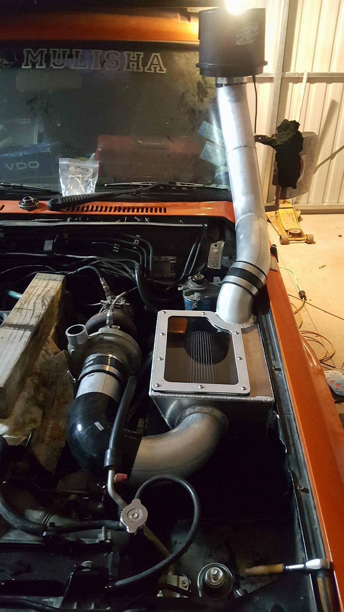

airbox snap
