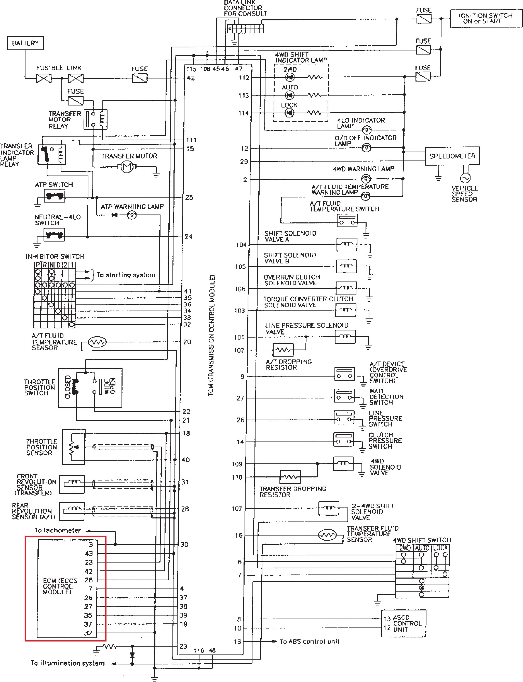

Having everything the mounting was done, and after carefully checking the conection diagrams I realized it would be impossible for me to use the TCU, so I had to configure the TCU in order to have a 50% torque distribution all the time, instead of using the speed difference between the axles as it was designed, so it was actually like a 4HI all the time.
This worked rather well until I broke a U-Joint at 75mph (not funny) I realized that I need to have the ability to swith to 2WD back and forth and this transfer case was not going to work for me. I took the front drive shaft out and didn't worry about it for a whilem as it was 2WD all the time, until I was doing heavy mud driving that it was heating the transmission a lot, sadly I didn't have an independent oil cooler, rather than the radiator/oil cooler combo, the end result, was that water leaked inside the transmission, which evaporate and burned all the seals. After tearing the transsmision apart I realize there was so much to fix as the friction plate where all destroyed that I needed to buy a new transmission.
The thing is that the ATX14A Transfer is a nightmare to wire up and to control, but as you can see in the circuit diagram, I just couldn't easily convert/recreate the signals coming from the ECM (RED)

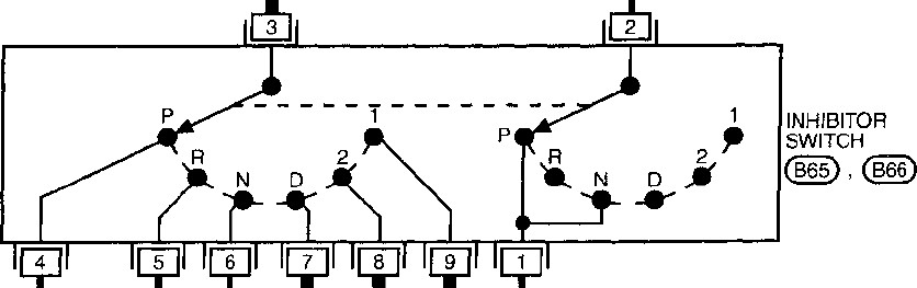

For the shifting control I use the Inhibitor Switch because it gave me the exact location of the shifter, (I kept the original ZJ Shifter and I only had to adjust the shifter cable height so both the transmission and the shifter align correctly), that means that I left "1" as First Gear, "2" as Second Gear (First and Second Gear have the Overrun Clutch activated so I had sort of "engine brake", ideal for going downhill) and "D" as Third Gear. For the OverDrive I had to place a switch so it could effectively shift from Third Gear to OverDrive when the shifter was placed on "D".

Having all this I enable the Inhibitor Switch so the engine could only turn on when in "Park" and "N", I also used the Inhibitor Switch on "R" to engage the backup lights. I used the original Jeep oil pressure and temperature sensor re-threading them in order to work for the QD32T engine, having them enable I got engine temp and oil pressure back. For the Speedometer I have to use and Speed Corrector because of the transmission gear ratio and the wheels I was getting values too different from the reality.

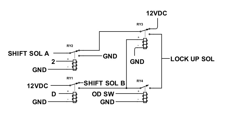

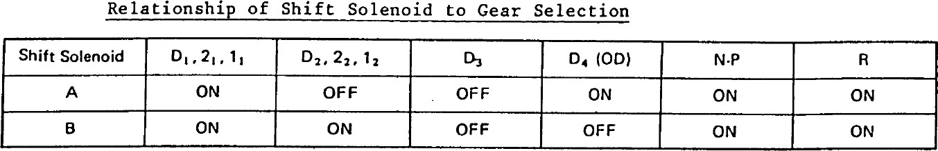

In order to get the the proper shifts I need to recreate the Relationship between Shift Solenoid and Gears Selection.
As I wrote before I use the Inhibitor Switch to get the "2" and "D" signals
So the only new Signal I needed was the OD that was just an ON/OFF Switch to 12VDC, all the 12VDC mentioned it's just a fused relay to 12 BAT controlled by the ignition switch.
I needed 4 Standard 5 Pin Relay and 1 Standard 4 Pin Relay.
I don't remember if this was exactly how I connected it, but you get the Idea on the Schematic that you can only OD/Lock Up on "D", and that on 1, N, R, P both Solenoid A and B are On.

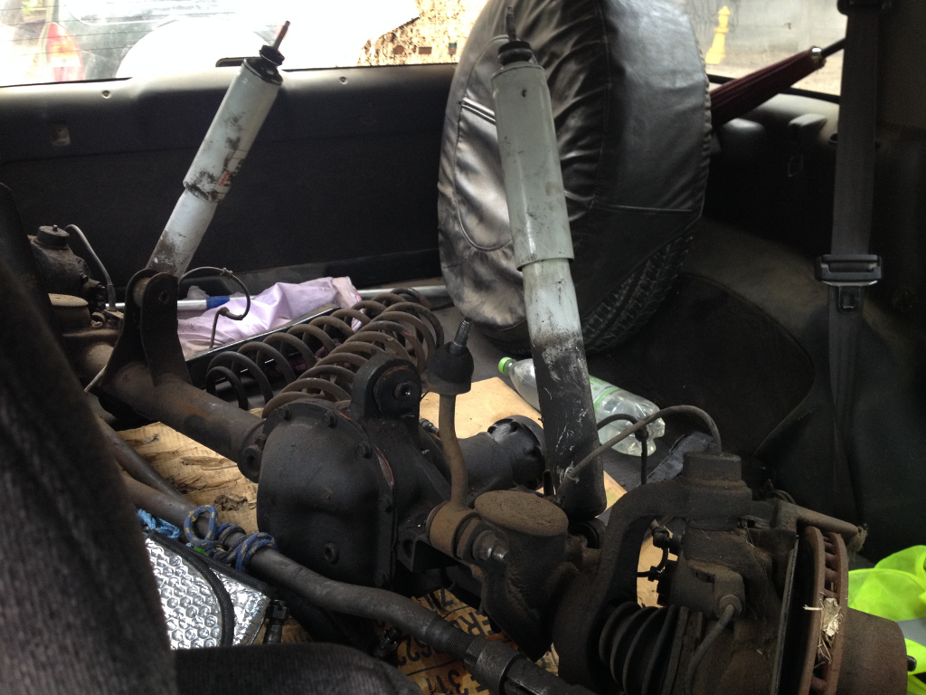

1-AXLES I swap the front axle as it was junk, I swap the read axle so it could be a D44A (had years of bad experience on a D35) the axle ratio for both axle is now 3.73
If I had more time I would have swap the Front Axle with an XJ High Pinion D30, with some adjustable lower control arms, but for now it make no sense to make that change.
