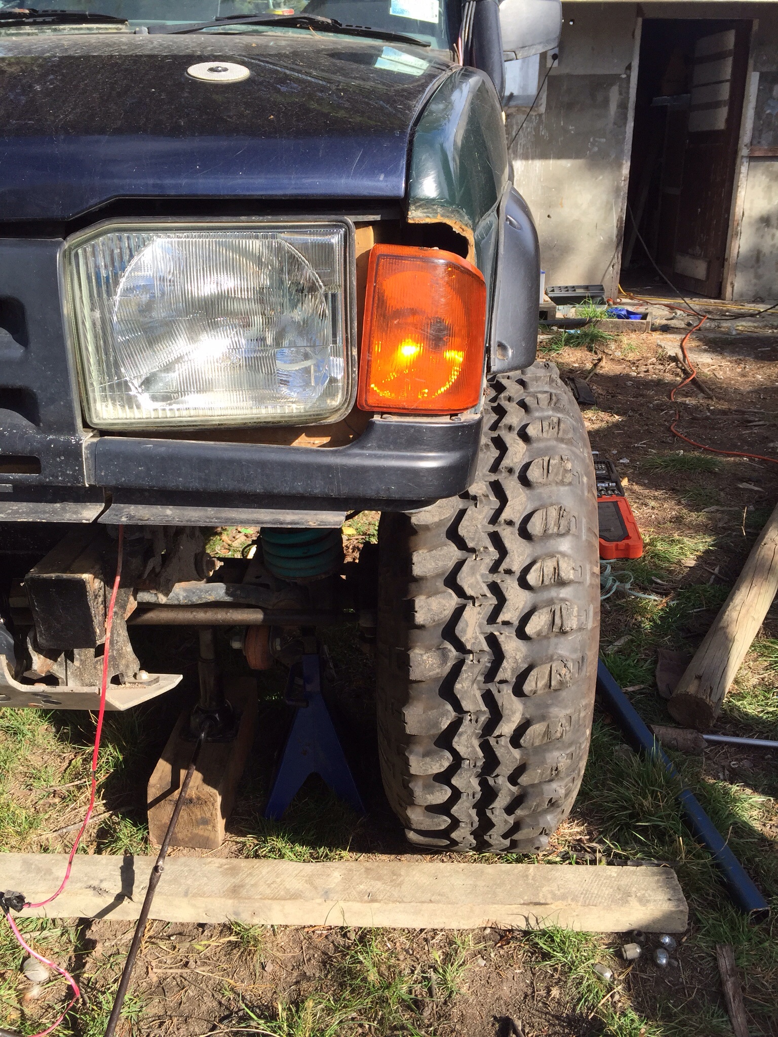

Started building side bars these will go over top of flares and mould into the side steps.

Playing round with mounting positions, will make all the side bars removable.

More photos to come.Trimmed up rear guards.Had to remove front solid flares and remount them back a bit to give more clearance. Front bar has been charged. Almost finished the bar work.

Have moved all the winch backwards, rear diff is now in, front pretty much in.Fitted new front springs.

Have fitted 30mm wheel spacers now, this thing is wide and looks staunch
