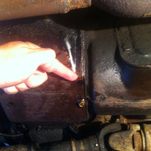

Hi all before i start pulling things apart any ideas where this oil leak could be comming from.

Is that where the bellhousing and gearbox join? Could be any number of things, crank rear or gearbox front seal, or it could be coming from further away, best to degrease entire engine and see if there is a clear path that you can trace.

black ....... Have checked it is engine oil the transmission is greeny
