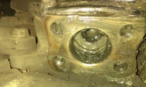

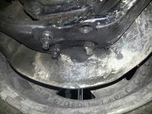

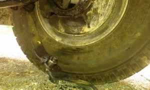

After a bit of a shock finding a broken stud, this is a warning for all cruiser owners.
Please check these as they are known for loosening and then snapping the studs. One cruiser owner only had one left.
Hate to think of the consequences.
Check them now!
Landcruiser swivel housing bolts

Yip been there done that. .either keyway or arp studs I think.. which is what I am going to be doing. Shit design when you add big tahs..I only had 1 stud about 1/4 thread in holding it on.. but my knuckle almost came off.. I wss only doing about 5-10ks whwn it wanted to climb a bank.. I was like wtf... anyway turn spanners every time you're out.. what I do now. .

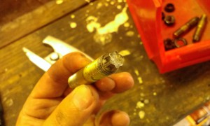

Have just taken the nuts off the studs and even the studs are loose. When you tighten the nuts it may seem to have fixed the problem, but check the studs also.
They have a star shaped end which a 9mm socket seems to fit nicely. Not sure if there is a special socket for it.
Now time to drill and easy-out the broken stud.
Re: Landcruiser swivel housing bolts
once the studs start winding out they keep on winding out after you retighten the nuts, you have to clean the studs up and refit them nice and tight with some locktite and everything usually stays pretty tight and snug after that still pays to do a periodic check every so often, excess grease leaking out of the swivel seals is usually a good indication they have come loose again
fullthrottle wrote:Now time to drill and easy-out the broken stud.
They ccome out pretty easy as they would have been loose before they broke off.. All mine were loose so I would just try to get a flat screwdriver in there and try it first.. might surprise ya..

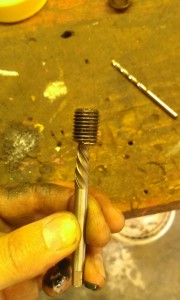

Big wrote:fullthrottle wrote:Now time to drill and easy-out the broken stud.
Dam close with the screwdriver. Unfortunately the last part of the thread in the housing was a little burred, but the easy-out came to the rescue.
Got ya, you little bugger
