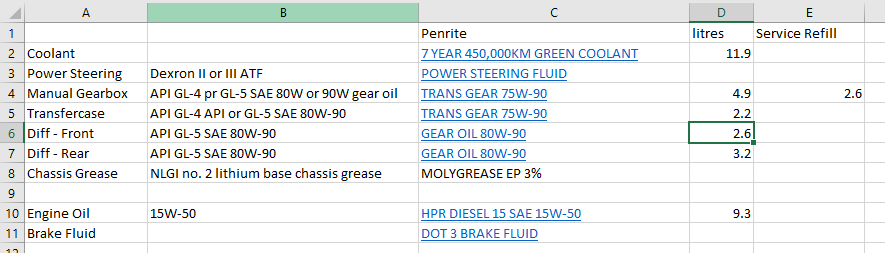

What diff oils to use and how many litres per diff roughly? And what is the easiest way to refill trans oil? Cant seem to find a bung.. also which oil and how much for this?

To find out what to use and how much, I use this:
https://www.penriteoil.com.au/product-selector
Select your vehicle and they will tell you exactly what you need. SuperCheap regularly have 40-60% off Penrite oils too.

Off hand it was just shy of 3L for the rear dif and 2L for the front. But could use different oils in each one if you have LSD rear, or Lockers. Not sure about the filler for the gearbox but some go through the dip stick tube.
Can also compare to the castrol site for quantities and recommended oil types.
http://www.datateck.com.au/lube/CastrolRetailNzl/
