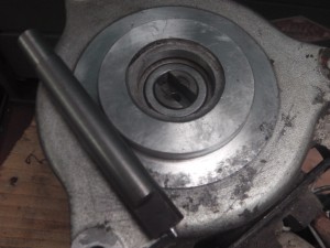

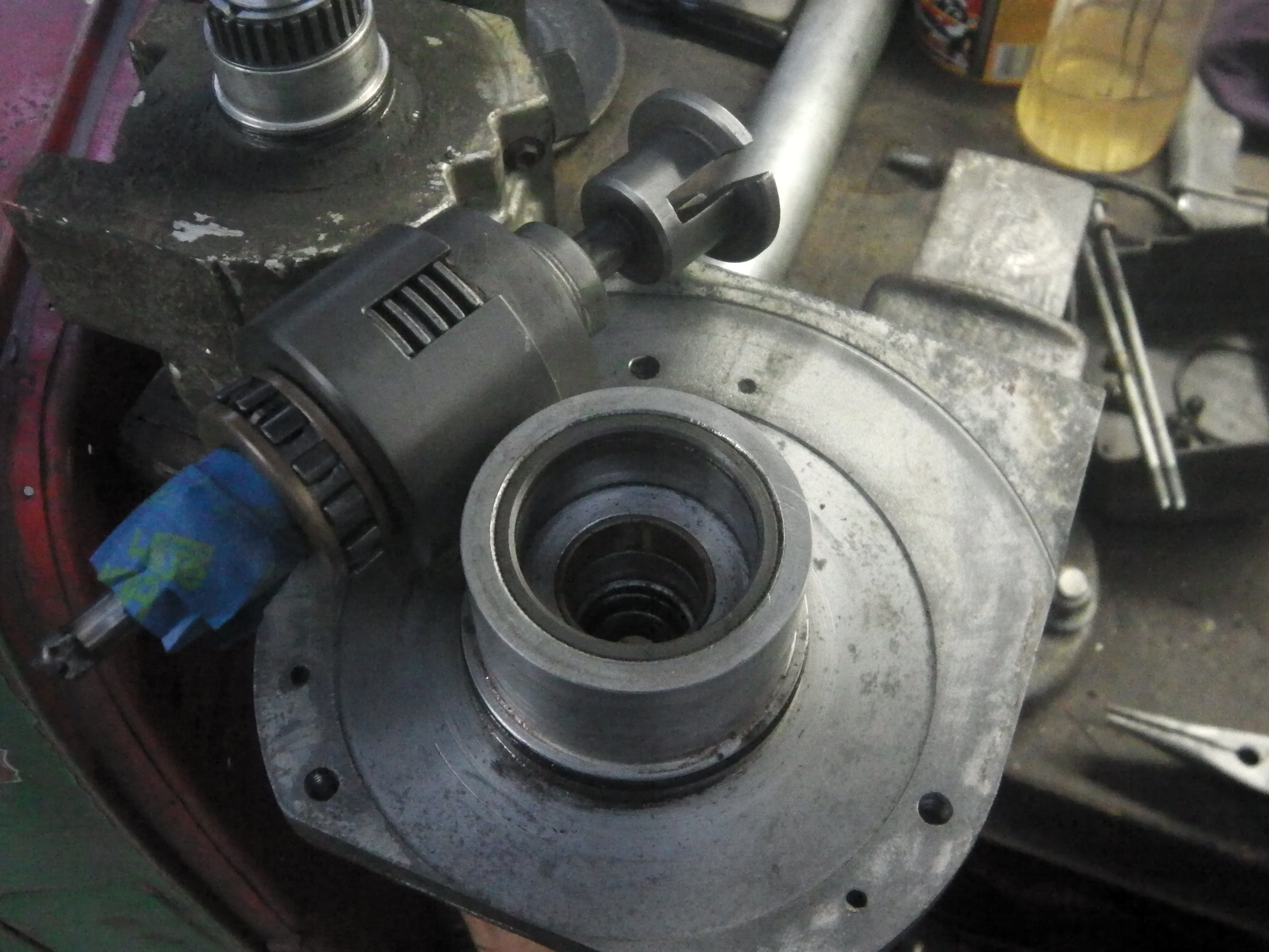

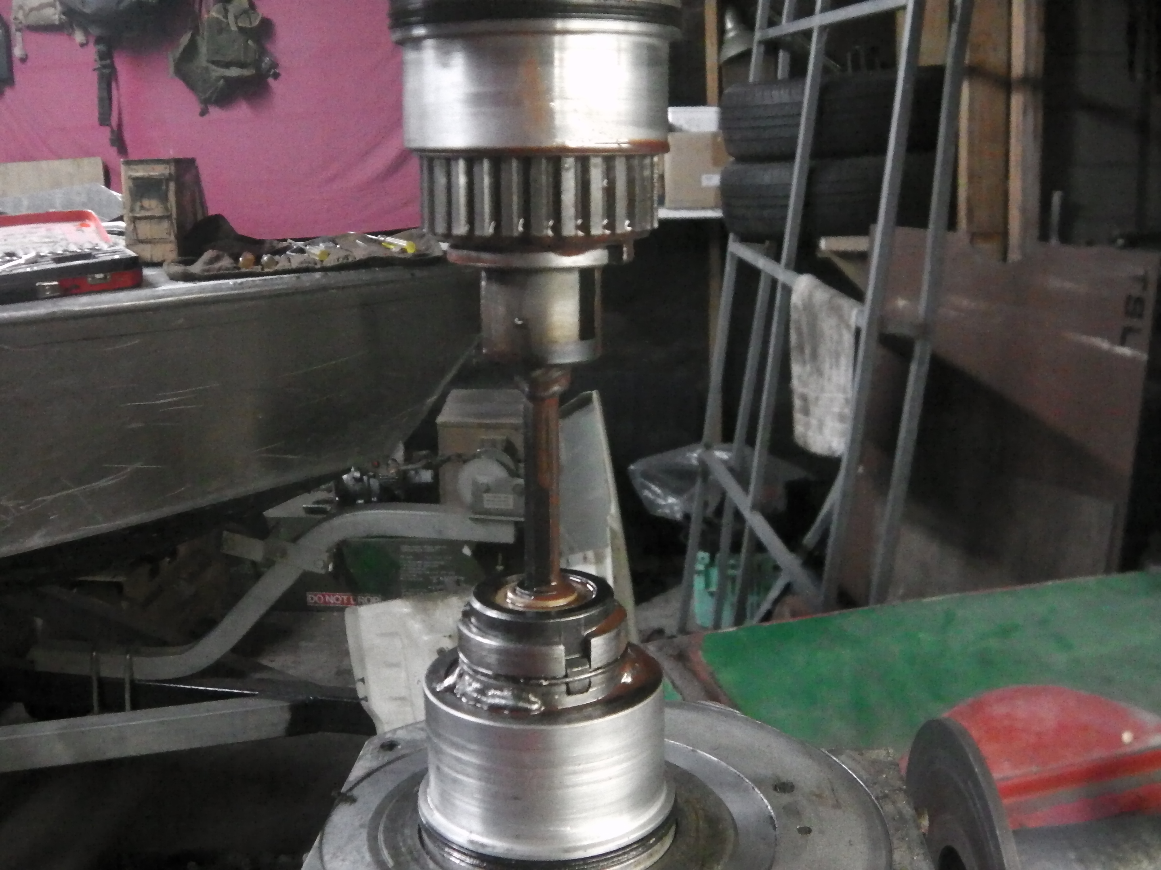

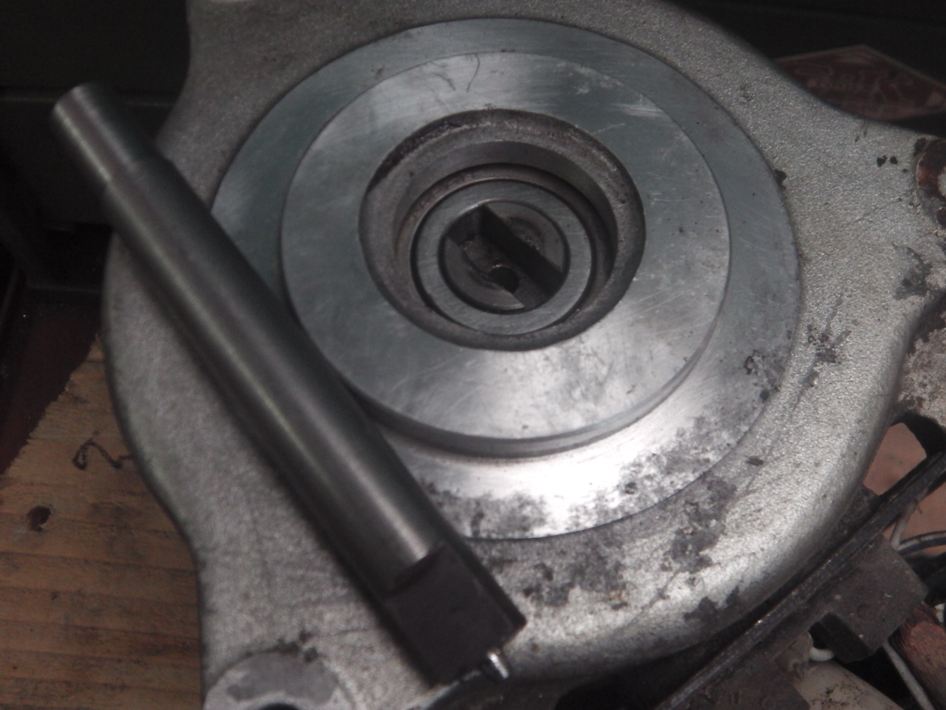

The factory low mount winch is great, easy freespool, 50m of rope, but when the blimen thing almost stalls under heavy load it will wind in but not back out, last straw was a recent trip to the coast and it left me in a spot of bother. the issue is the clutch not releasing allowing the drum to spool out (leaving you with a clicking sound of the motor trying to turn backwards against a stubborn clutch) Google proved useless once again so i fixed the problem myself.

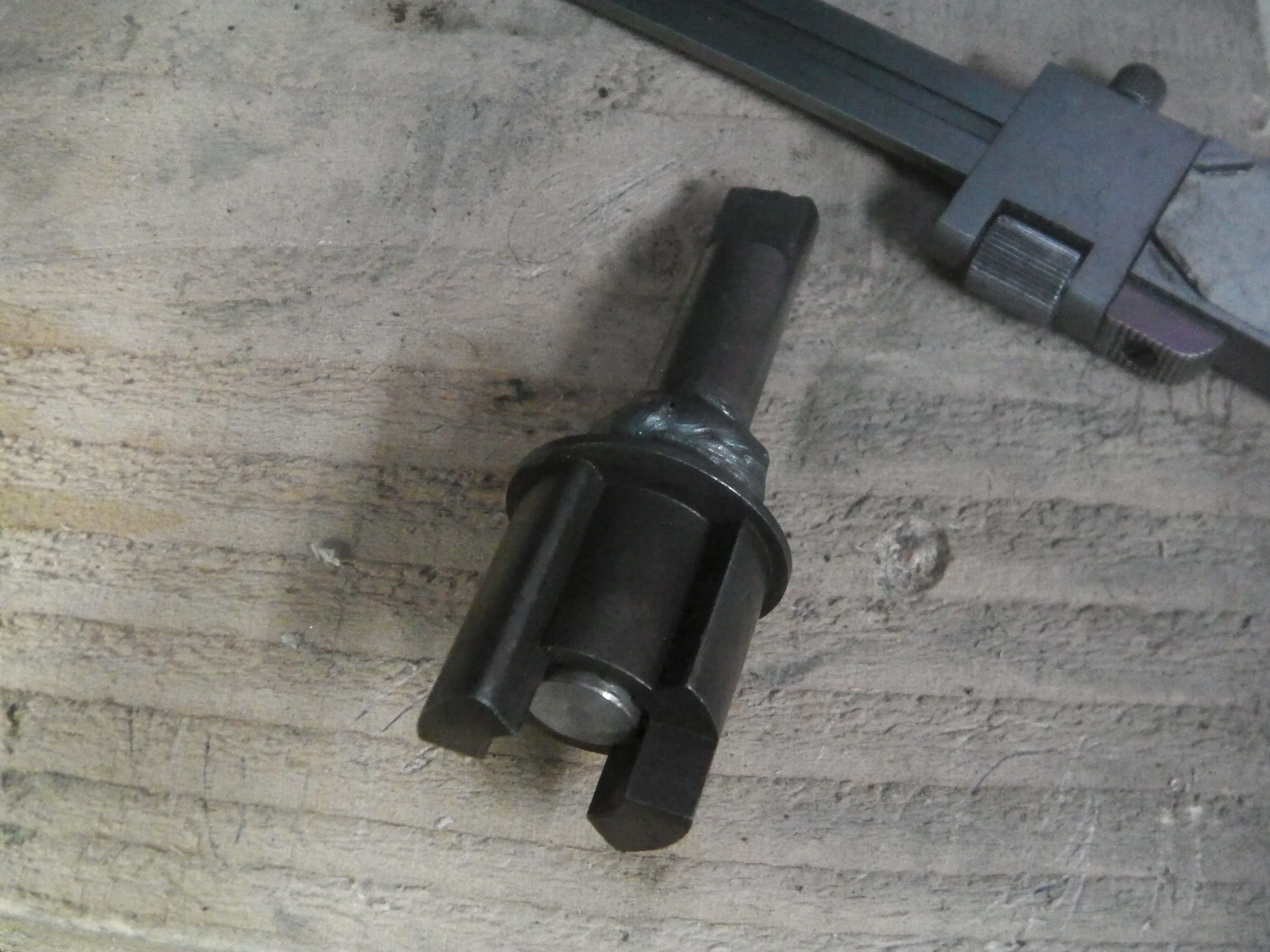

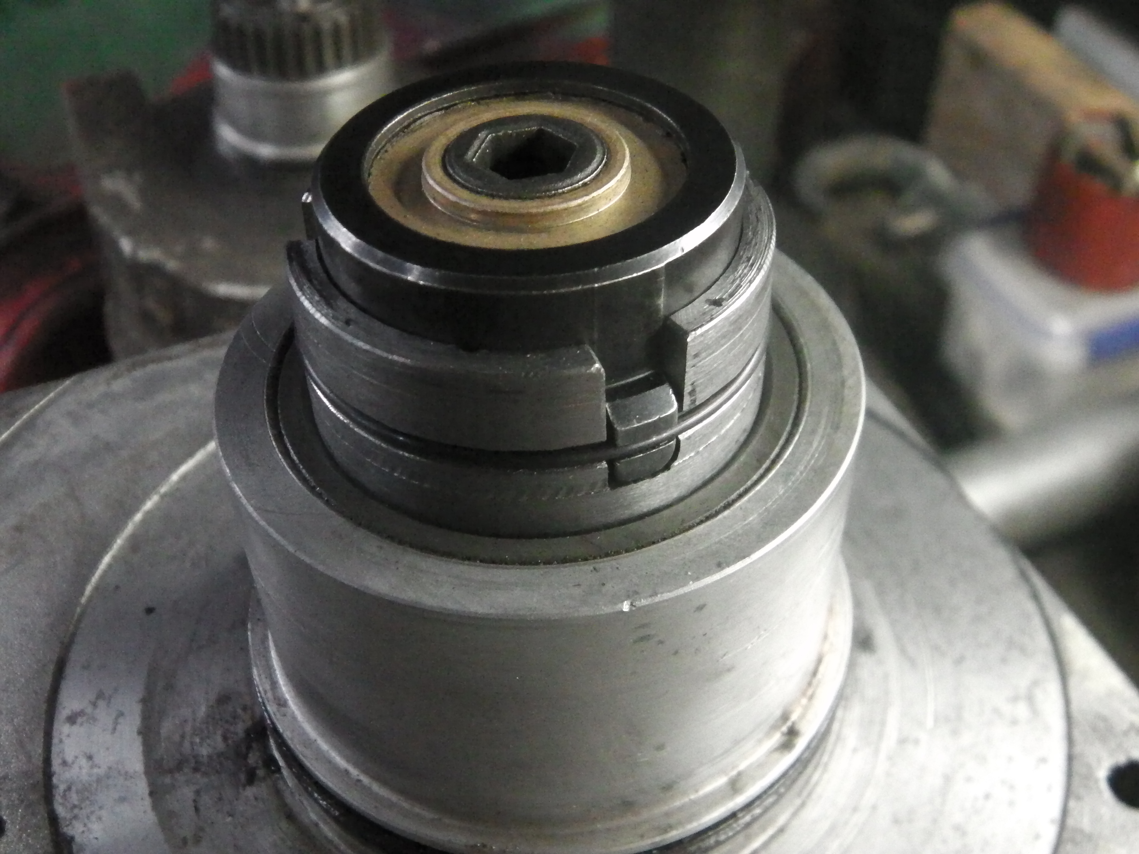

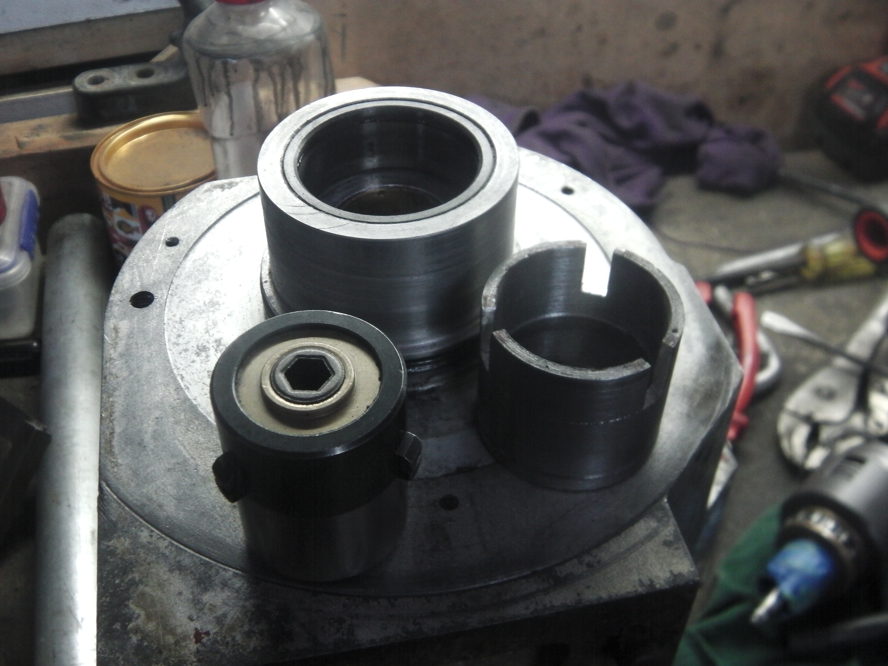

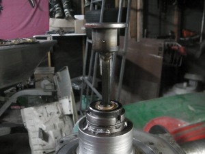

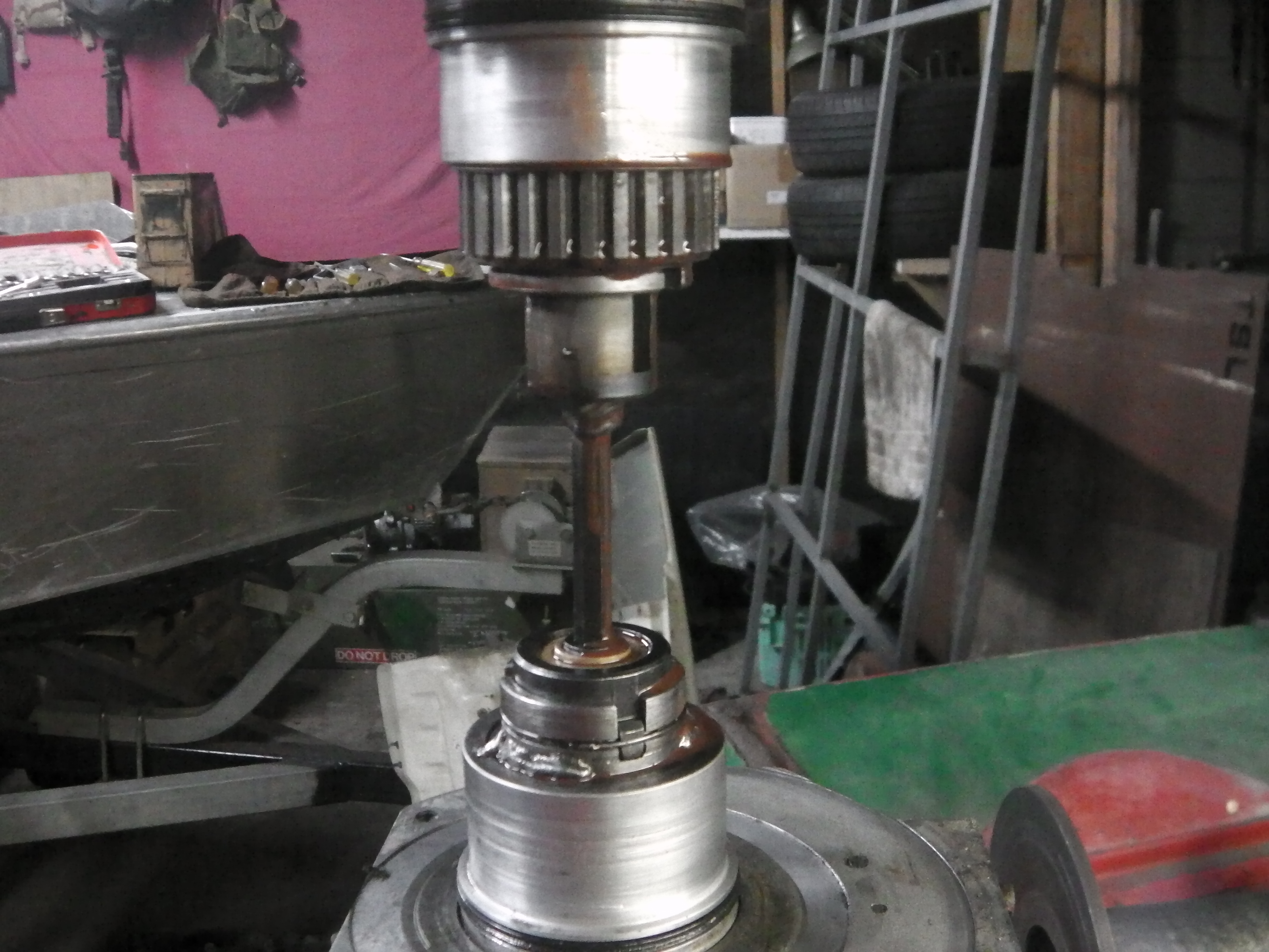

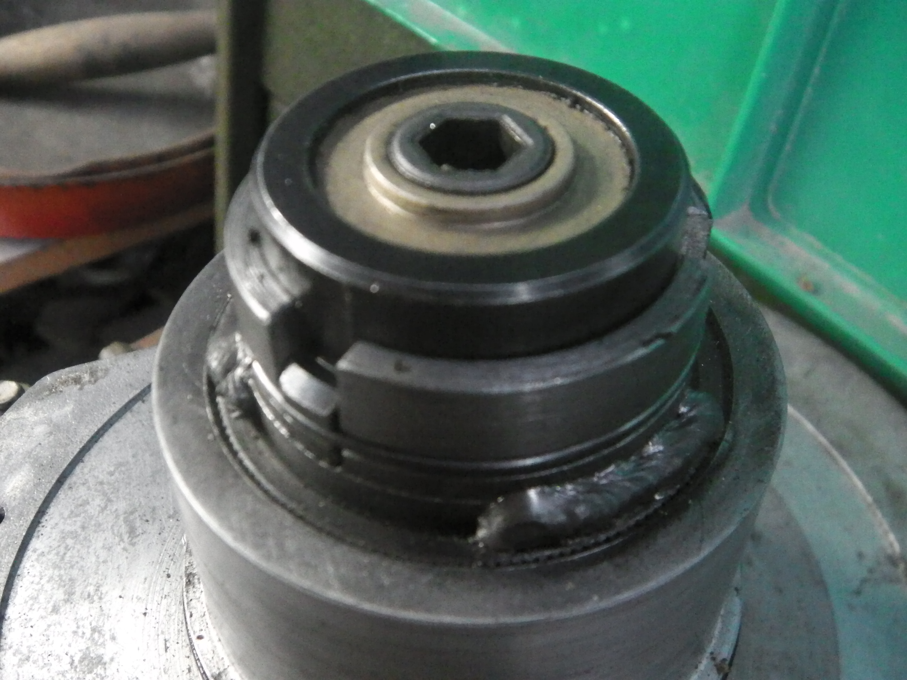

pretty much replacing the clutch plate one with a commonly used flat coil spring one.

Sorry i havent managed to get the photos in order but i hope this will help anyone else out there like me that wants to fix their 80 series winch because they like it.....but mainly cant afford to buy another. When i pulled it apart there was no sign of any water which was brilliant (and suprising), when assembling it i used a high tack waterproof grease on every bush and seal i came across, and any thread i touch i use this shark oil based never cease.I pinched it off the old man, cause you know its good when its got bits of animal in it.
ive stalled the winch and it wound back out again, works perfectly, no more wind in and not wind out buisness

kbushnz, yeah i had checked the solenoids, im not running dual batterys but do have a new 810cca one, its been doing it for years so when it shore the end off the drive rod (from me clicking the hell out of it trying to get it to reverse) i figured it was time for some DIY...again

I got the clutch from the parts bin at iorn man 4x4 but im sure theres a few other brands that use the same clutch system, not sure if you could buy it new on its own though.

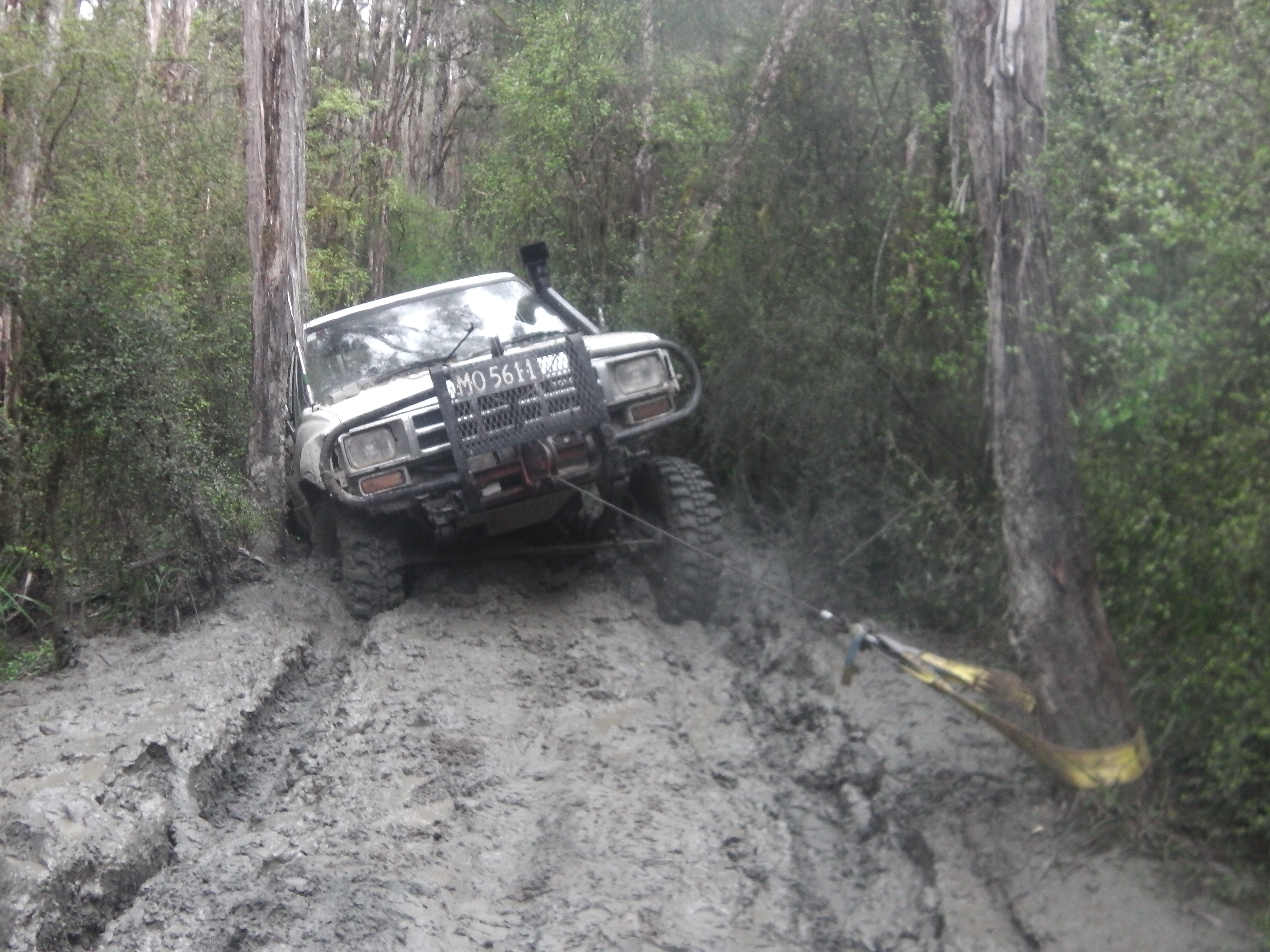

drove the Bulletproof chasm the weekend just been so the winch was either going to shine on through or suck the kumara. pleased to say it worked absolutley perfectly, no issues whatso ever, with modding the inernals of the winch i also went to DC cunninghams (a welding shop in chch) and got them to crimp up a couple of lenghts of 50mm2 earthing cable to use as new leads, direct from the battery, (along with new terminals that had a large surface area for the new cables to go on) this made a noticeably BIG difference to the performance of the winch.
on another track it dragged me up on my axles a 7m bank and a non driving sheepshagger hilux up the same bit of bank straight after without any sign of slowing or heating, pretty bloody stoaked as the factory cables wouldnt of allowed that before.
