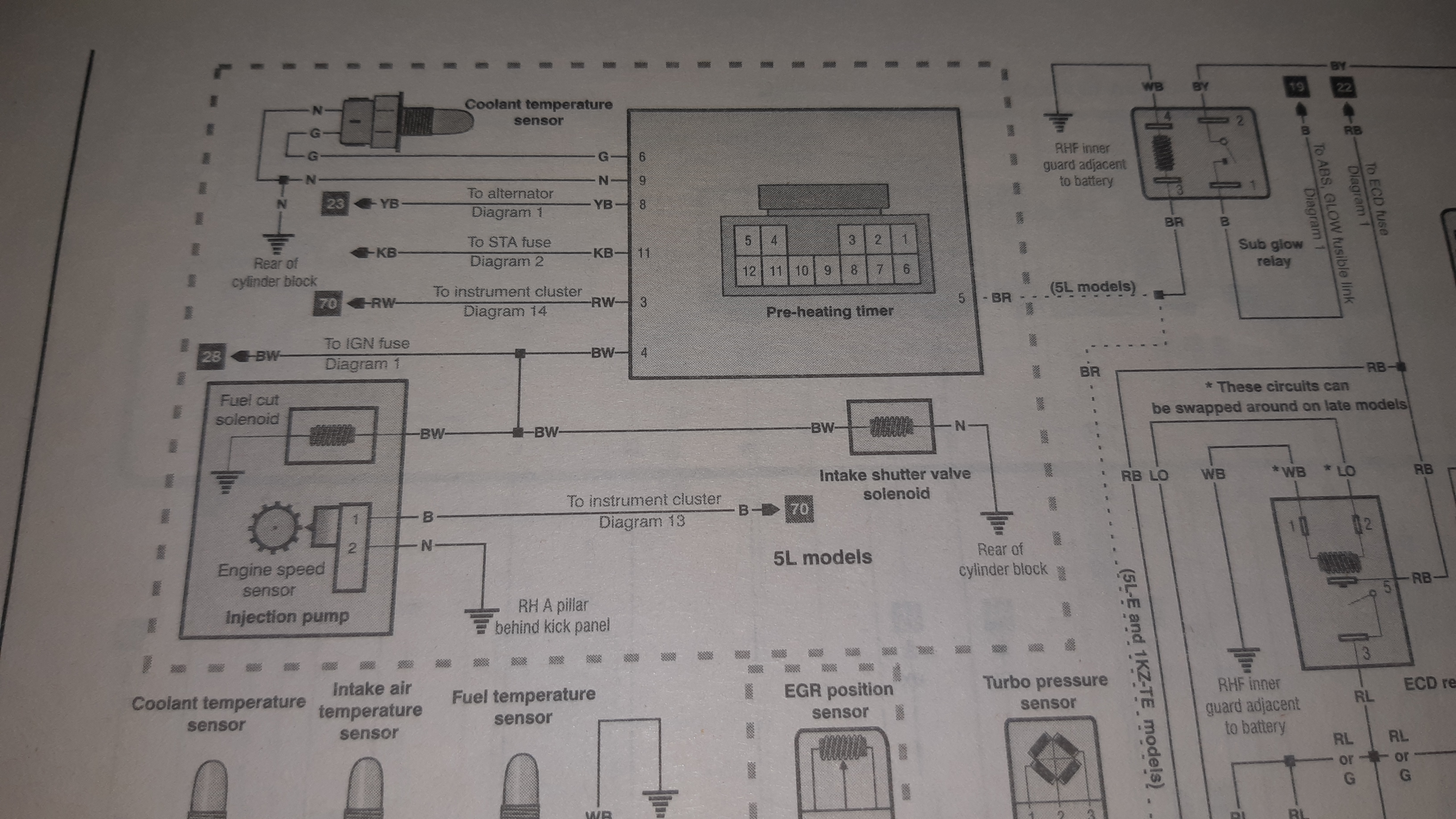

Re: 1996 KZJ78 starting issue
I have a hilux 97-05 diagram not sure if any help but might be similar?

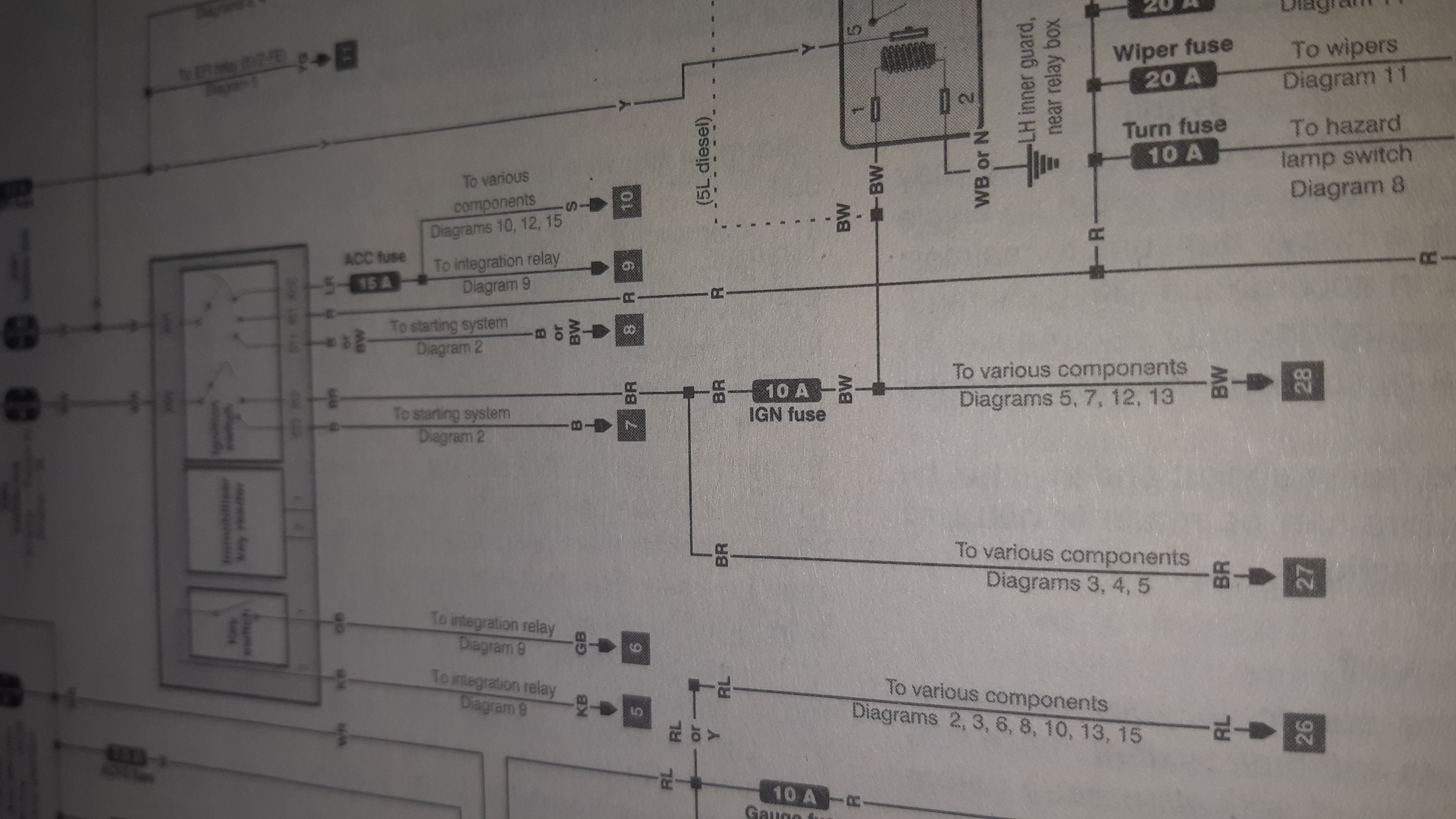

From what i can see the ign fuse covers both pump and glow plug timer
- Bush Crasher
- Posts: 95
- Joined: Mon Jun 30, 2014 4:11 am
thanks Stu! diagram says 5L engine but logic might be very similar, I will compare with the japanese version i found on ih8mud.
