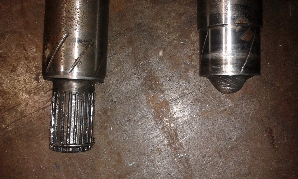

Over the past three weeks we did break some stuff.
1) The spare tyre mount. Take a 31" tyre, tie a ground anchor and spade to it and then driving it quickly out from Big River at 6:00pm gave us a broken spare tyre mount. Add more weld to fix. We also lost the top of the PRS aerial that mounts to the spare tyre mount.
2) The drivers side CV. Had come through Molesworth and just got back to the seal in Hanmer when I heard a funny sound. Pulled over and checked underneath to find two of the three bolts gone and the third on the way out. The CV shaft was hanging loose. Stopped at the garage for bolts, washers and loctite, followed by a visit to Hammer Hardware for a hacksaw and fixed it in the motel carpark. Hasn't moved since.
3) The rubber strut mount now has some splits. Not sure how long this has been like that - only noticed it at the end of the holiday.
4) Rear A-Arm heim joint: This is well known for wearing out, or the joint coming loose from the a-arm and slopping around in the threaded hole. We had to stop a few time and tighten this up to remove the slop. Have started looking at what we can change on it to make it a better set-up, but in the meantime I have ordered a replacement joint kit to kiss it all better.

Toyota CV's & Half Shafts:
We now have toyota CV's instead of Suzuki ones, using this kit sourced from BenT. The key components are the adapter plates from suzuki diff output flanges to toyota CV flanges, free wheel hub spacers and brass bush bearings.
Here you can see the installed adapter plate with the countersunk cap screws on the suzuki side of the adapters. These were necessary because of their proximity to the diff mount bolts, which were also countersunk cap screws.

Now for some testing...
At ZukiCentral, I got onto a steep rutted sidling. Taking it slowly, I got hooked up and lost traction - drivers side front wheel at full extension. Back in the day, I would gently apply some brake while driving forwards to spread the drive so tried that.
BANG!
Bugger, I thought I had popped my drivers side CV. Got out at 5:00pm, raced to Repco to grab a spare to replace it with at the camp. Only to find it wasn't the CV, but the spider gears in the diff...
Lesson learned - what worked with 27's and standard gears is not good with 31's and crawler gears. Don't do it again!
But, the CV's held fine in what is normally the situation they would pop.

So, then to fix the diff. I called back into Rick's on my way back down to Haast, where we found that sourcing Vitara ring, pinion and spider gears in 5.125 ratio with 26 spline sides is actually kind of difficult. Some ringing around of wreckers yielded the correct ring & pinion from a GV diff, but not the pair of 26 spline side gears...
Except for Peter Munro Commercials, who happened to have a 4 side gear, 26 spline centre sitting on their shelf. Ordered in by a dealer who meant to get 22 spline, but didn't realise until it was installed. Now the unit was sitting opened on the shelf and they were keen to get rid of it. Best thing though, the air actuated locking ring. Yep, they happened to have the correct ARB air-locker on the shelf and would discount it to get it gone.
Oh yeah!
Oh yeah!

All back together and down to Haast, further problems:
Driving along the track (such as it is) and something hooks up underneath - feels like a stick or something caught underneath. Get to a creek crossing that needs some thought and as I line it up, Al notices the diff rotating.
Seems the third member mount has let go and in doing so sheared off one of the drivers side diff mounts, one of those countersunk cap bolts. The entire nose of the diff is rotating up and down about the diff mounts when under the drive and it was pretty close to puncturing the sump - some impressive looking bolt head shaped dents. We hold it down with a tie-down and I drive out in 2WD - now a familiar feeling.
Again, that night heaps of help from everyone on the trip, but this time, instead of finding a busted diff, we manage to ezy-out the sheared bolt and put it all back together. Then checking the third member mount, find it has come loose again - the thread pulls in somewhat when spannering it, but it is half stripped. Replace the entire bolt with a new one and add another new nut beyond the captive nut. Some spring washers and some loctite and it is better than ever.
Have speculated that the third member mount may have contributed to the previous diff breakage, but it seems odd that none of us noticed while fixing the diff.
One other thing you can see in the photo is the metal clamps on the CV boots - it doesn't take much to rip these off in grass and other muck. May have to replace with zip ties or wrap in insulation tape to stop them getting caught. What have others done?

... speaking of which, this little gem capped off the destructive weekend. Drove back over Haast Pass, through the Neck and beside Lake Hawea when I thought "this gear lever feels a bit funny".
Then it broke off. I was doing about 80km/hr.
I pulled the whole thing out with the boot and could move the stub between 3rd & 4th with my fingers, which I did until AlbertTown. Then used a socket and extension bar to change gears from there until Queenstown. Welded up that night courtesy of Keri and it was all go again.

Cross member:
I happened across a Brisbane Suzuki forum where I found a cheap HD cross member for sale. Had been thinking about one of these for a while and it so happened one came up and it was priced cheap. It also came with a pair of the altered ego style shock repositioners.
What I didn't realise is that as well as being solid plate steel, it is also designed to lower the transfer case to help restore driveline angles after a lift. However, this does not work well with a 3" body lift. The gear lever simply would not work and the mechanic had to space the transfer case mounts back up to their standard position to make the gear lever work. Even so, I still got used to holding the lever in place in 4th.
And it seems it was a fortunate thing. The factory cross member we removed (the third one we have gone through) have the start of a crack:
