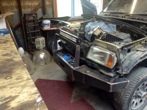

This is my Zook that I have been working on over the last few years.
2" body lift
3" suspension lift
2" shock spacers and hat flip
15/8 rims with 30" tyres
the frog escudo
- Campbell.s
- Driver/Navigator

Awesome !! Were bots in nz are ya?
Wot mods have you done so far?

Re: the frog escudo
Just outside chch, so far I've rebuilt the motor and front and rear diffs, lock rite front and rear, front diff is steel, 3 inch suspension lift, winch bar with a 9500lb runva, rock sliders, LED light bar etc just got to get the top coat on and wiring up dual batteries and some kind of rear bar that will house the high lift jack.
Re: the frog escudo
What 3" suspension you running?.
Any pics of front bar as I'm building mine now and starting on my rear bar soon to take the high lift jack across the rear horizontaly.

Re: the frog escudo
FTS lift kit not sure how it'll go seems to hard at the moment but will soon find out. Winch was made by ORE member loppee in rolly, top bloke and makes a damn good bar. Would love to see what your rear bar turns out like.
Re: the frog escudo
How have you mounted the front bar to the chassis?
Awesome looking bar!

Re: the frog escudo
Has brackets that bolt to two factory holes where the bumper mounts to I believe on the side and then drill a third through the front, then simply bolt the bar to the brackets, I'm adding in another to tie it back to that round bar that goes across the front of the chassis.
