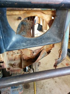

The guy I bought this off had started the body lift. He only had a few mounts in and had lost the rest. So I got some 50mm spacers cut at work and painted them. I also made up some brackets to help strengthen the front body mounts under the headlight as this was all rusted out and had had a poor fibreglassing job done previously.

Front Left and right. Rust and no strength in the area.
And fixed, with strengthening plate top and bottom and the body mount actually supporting the body!
