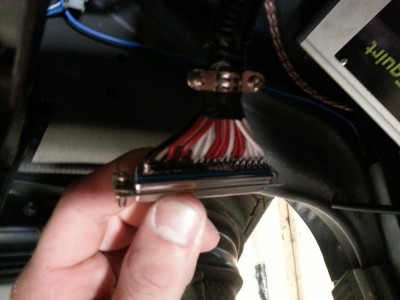

DEATH_INC wrote:
Paulballz wrote:Ok have tryed that before will do again though run straight to batt earth
Sorry, I may have to take that back...does the megasquirt have 1 or 2 earth wires? Most ecu's have a main earth and a sensor earth.
Just one earth... This is where i had so much drama doing wiring as the megasquirt diagram i got was for a car that already had loom wired up i.e sensors already grounds ect...i did not have any of that so made loom from scratch...That spot on the engine orignally had 6 ground wires coming from it for original ecu. (3x per bolt)
DEATH_INC
Posts: 329
Joined: Tue Feb 06, 2007 12:00 pm
Location: Papatoetoe Auckland
Re: RB25Det Nissan Terrano
Postby DEATH_INC » Tue Oct 30, 2012 11:24 am
Paulballz wrote:

Paulballz wrote:
Just one earth...
I doubt that's right. It should have at least 2.

Pin 31 controls the ACC valve (fast idle) This works a can hear it click in and engine idles higher while cold.
I am going to go through and redo alot of my earth wiring and get a new heavy duty earth lead from batt to engine / body
Although after reading that still do not understand why i only have 1 earth cable coming from ECU in the loom...This cable is not a heavy gauge cable either but i have soldered it to a 25amp cable to earth
DEATH_INC
Posts: 329
Postby DEATH_INC » Tue Oct 30, 2012 1:30 pm
Paulballz wrote:Although after reading that still do not understand why i only have 1 earth cable coming from ECU in the loom...This cable is not a heavy gauge cable either but i have soldered it to a 25amp cable to earth
Mmmm, I'd try to take a peak at what is coming from the plug, see if they've joined 'em all together after they come out of the ecu....

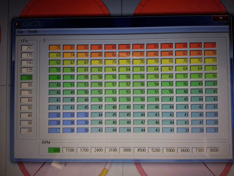

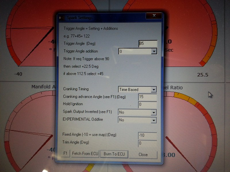

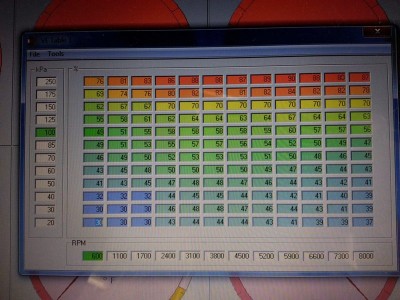

Paulballz
Posts: 183
Joined: Mon Jul 25, 2011 3:01 pm
Location: Whanarei
Postby Paulballz » Tue Oct 30, 2012 8:24 pm
Ok will awnser questions then prove im not insane!
Yup Gardengnome i have cranked engine with injectors out fuel pump on and they shut and close completely. They Open on ground signal from MS so shouldnt be opened by stray currents?
Philux, agree hoping someone could tell me what this meant.
Todays progress, contacted mega tuner he told me to unplug everything but the coils/injectors/cas and TPS /Map vacuum... Everything else including alternator unpluged.
I have uploaded videos
First Video
This shows the fuel on/off and pressure to confirm..first video to show im not insane and truck runs with no pump pressure quite well.
http://www.youtube.com/watch?v=mUQtIm9k ... utu.beLast
video to prove im not insane
Revving, running WITHOUT fuel pump "ON"watching Megatune.
http://www.youtube.com/watch?v=soZNvsru ... e=youtu.be
Very frustrating as it runs really well before what i believe it starts to foul the plugs from fuel
Hopefully megatuner or someone can spot something wrong in by the gauges...please note the intercooler was unbolted so was pipe work...just throttle body into plenum.
Excuse the wire birdnest, i redone all the earths and they are running every where at moment until it all confirmed. (there is also a background pump sounding noise some might hear, ignore it the house water pump)

DEATH_INC
Posts: 329
Postby DEATH_INC » Wed Oct 31, 2012 8:35 am
I'm at an absolute loss as to how it can run that long and rev that much with 0 fuel pressure. It makes absolutely no sense at all.
All I can think is the injectors are wide open and it's sucking a shitload of fuel whenever the throttle is closed and it creates a heap of vacuum. But even that doesn't really sound right.
Did you put the ecu earth on a separate bolt/attachment point? This will stop the coils etc from earthing through the ecu. + run a big earth wire to the battery from where the sensor/coil etc earths bolt to the engine to the battery (I think someone else said this already). You need to do everything you can to stop the power feeding back through that ecu earth.
One other little experiment if you could....may not help but does it run if you remove the fuel line so there is no residual pressure in the system? Needless to say, don't turn the pump on :shock:
Where is your fuel gauge pressure taken from?
The noise suppressors from the coils shouldn't be the problem, they may make it run a bit odd at times, but won't do this I don't think....
I can't make out the gauges in your vid....old fella :lol:
meatc wrote:I still think there is an earth issue. ECUs switch the earth to fire things so need a nice earth for a ower source and will often have a sensor earth so the ecu knows what the sensors are seeing. If your ecu only has one earth that is shown in a diagram as having to go to the same place as the sensors i would be making sure your ECU is mounted with a ground, not sitting on the seat with no earth.
The fouling sounds to me like its opening the injectors for to long because the ecu cant see how much earth the injectors are getting (if that makes sense) Once the fuel is up to pressure there will be enough for it to run for a very short time with no fuel pump, but only really if the injectors are open wide for ages.
Good idea running an earth from the ecu body, though it should be done internally, another won't hurt.
As I said earlier, with my bikes system I didn't reconnect the sensor ground wire, and it just ran the injectors wide open and fulled everything with fuel quick smart. I'm thinking this has a similar problem....
DEATH_INC
Posts: 329
Postby DEATH_INC » Wed Oct 31, 2012 8:47 am
(edit; Ive edited heaps from my first attempt... :lol: )
I think I've got something...if the gauges on the top right are pulse width and duty cycle?
They both go way to high. Off boost the injector (duty) cycle should only go to around 20% max. Yours is going full. So is the pulse width.
I thought it may be rpm inputs but I've removed that...the rpm looks good.
Map is good.
This proves what we all think about your injectors staying open far too long though.

Can you bring the injection/ignition tables/maps up and post a pic?

Here is some pictures of some of the tables... ANOTHER PROBLEM I AM NOTICING IS THAT IF THE BATTERY IS EVEN THE SLIGHTEST DOWN (NOT 100%) CHARGE THEN THE PULSE DOESNT GO AND THE GAUGE GOES RED WHILE CRANKING OVER.
My working week has started today so please keep your thoughts coming and i will reply as i can, should get a little bit of time possibly thursday night to spend on truck an try ideas...
Also i cant stress enough that all the problems with the megasquirt are due to my lack of knowledge and the views i express here are my own through frustration due to my lack of knowledge no other reason...I do not want to give the megasquirt a bad rep or harm in anyway the people providing this products business...The guy i have dealt with has been amazing from emails at 11:30pm at night to 13emails in one day some days... So please do not let this forum at any stage put you off buying a megasquirt system if you are/have been wanting one.
p.s sorry about poor pic of plug this site makes me downgrade my pics, it has a black wire going side ways that is soldered to the groun pins then goes out in 1 earth wire as stated

Cool as, just wanted to see that the maps hadn't gone haywire, look pretty good to me.
