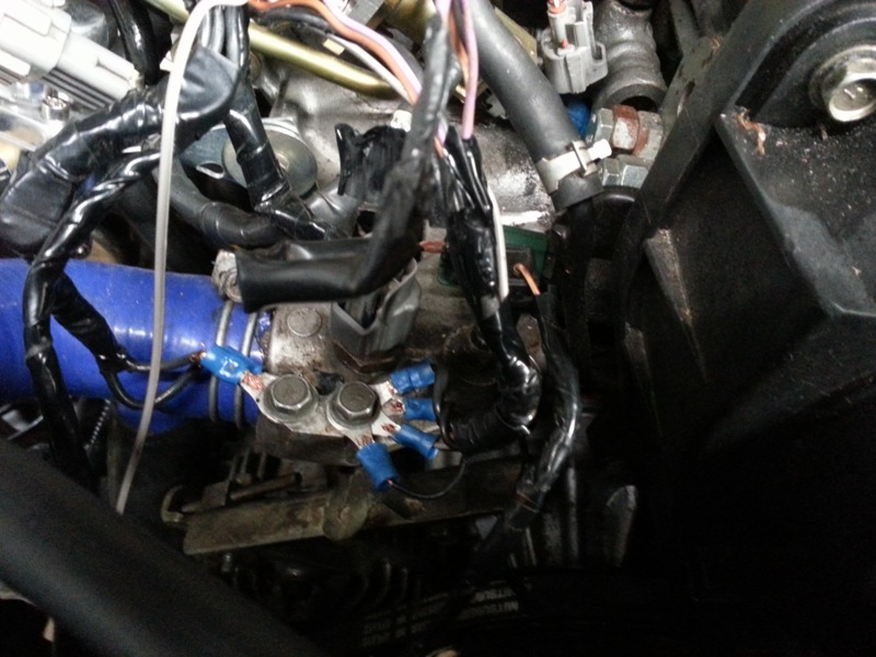

Where are you picking up the earths for the ECU? You should have one (sensor earth) that comes from the same place on the engine as all the sensors/injectors etc and then the main earth direct from the battery.
I had issues with the engine in my toy (standard ecu) when I first set it up cause I had both earths to the ecu coming from a common body earth. Simlar but lesser problems that you describe with the over fueling. The small amount of voltage variation messes with things, remembering that a number of the sensors send signals that the ECU picks up in volt ranges of less then 1V and most sensors are running on less then 5V not the 13+V of the rest of the car.
Toy - Zuk chassis tub, hilux 4.88 axles and transfer, Nissan CA18DE motor and auto trans, sc12 supercharger, 32 10'5 simex, twin motor 8274 custom freespool. Well the parts are all there in various corners of the shed
Paulballz
Posts: 183
Joined: Mon Jul 25, 2011 3:01 pm
Location: Whanarei
Re: RB25Det Nissan Terrano
Postby Paulballz » Tue Oct 30, 2012 6:17 am
Hey meatc, the RB engine has a section by the thermostat that is used (standard) for all the earths. I have ran my grounds for the following going there through 6 heavy wires... CAS / Boost Solenoid / Idle up / ECU / Coilpacks / TPS / Coolant sensor / VCT (these are the only original components used at this stage plus the MAP vacuum)...Some of the smaller gauge wires have been spliced into one connection. When i check this area for ground with multimeter against the 12v batt, i get the 12.41v (so guessing it grounding suffecient.
For my battery earth cable i have ran the standard TD27 wire, It bolts in the side of the block / bottom of battery tray / then - Battery. It also as a smaller gauge wire (about 4mm thickness) then runs from block to truck inner guard.
jonossiksilvia
Posts: 727
Joined: Mon Jul 12, 2010 5:53 pm
Location: christchurch
Postby jonossiksilvia » Tue Oct 30, 2012 9:19 am
To get an exact reading of wat the grounding is doing you should be measuring the resistance not the voltage

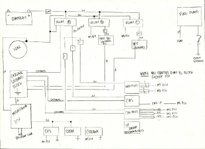

ok will try that so you mean measure the ohms?
Here is a complete wire diagram of how i wired the engine...Please look through it for any faults that are obvious remembering my electrical experience before this was limited to car stereo installs.
F=Fuse
MS ECU= Signal from megasquirt
Have checked all plugs to ensure they are getting 12v...
Note: Engine has run with this setup (althought not correctly)
Black hose is where i connecter MAP Vacuum line
Earth block
jonossiksilvia
Posts: 727
Postby jonossiksilvia » Tue Oct 30, 2012 10:00 am
Yes ohms. Ie set to ohms on meter, put black wire on neg battery, put red wire on say a bolt on engine that has not got a rubber washer. If reads 0.00 means good earth no resistance.
Sorry very brief as on phone

Postby Paulballz » Tue Oct 30, 2012 10:39 am
well my fluke brand multimeter test showed
Ohms symbol selected
Black on NEG battery terminal
Red On Bolthead of Earth clamps then tryed earth wires
Key on =13.2
Key off = 1.2
Battery (Positive) disconected = 0.2
Guessing is this not good at all?
jonossiksilvia
Posts: 727
Postby jonossiksilvia » Tue Oct 30, 2012 11:00 am
Forgot to say touch leads together to make sure it goes to 0.0 first. Also check not just that bolt but as far as earth wires go ie ecu plug, sensors etc

Paulballz wrote:Hey meatc, the RB engine has a section by the thermostat that is used (standard) for all the earths. I have ran my grounds for the following going there through 6 heavy wires... CAS / Boost Solenoid / Idle up / ECU / Coilpacks / TPS / Coolant sensor / VCT (these are the only original components used at this stage plus the MAP vacuum)...Some of the smaller gauge wires have been spliced into one connection. When i check this area for ground with multimeter against the 12v batt, i get the 12.41v (so guessing it grounding suffecient.
Am I reading this right that the main earth for the megasquirt is going to the same place?
If it is move it to the earth on the battery, or at least somewhere else.
It may not cure it, but it is better that way.

jonossiksilvia wrote:Forgot to say touch leads together to make sure it goes to 0.0 first. Also check not just that bolt but as far as earth wires go ie ecu plug, sensors etc
Yup it goes to 0.2 when touch terminals
Just rechecked again
Key OFF but both batt terminal connected = 0.5 that is on earths on engine plugs
Key "1" Click = 1.2 - 1.5
Key "IGN" (not cranking one before) = 13.4
Tryed multiple spots on plugs and engine and all come back similar results.
Testing body with key off comes back around 0.8

Ok have tryed that before will do again though run straight to batt earth

In fact, move anything that isn't a sensor earth from there (coilpacs etc), the sensors like a 'clean' signal.

Paulballz wrote:Ok have tryed that before will do again though run straight to batt earth
Sorry, I may have to take that back...does the megasquirt have 1 or 2 earth wires? Most ecu's have a main earth and a sensor earth.
Do you have the V3? If you do the sensor earth should be pin 7, run that one to the block, on it's own bolt, and the others to the battery.
