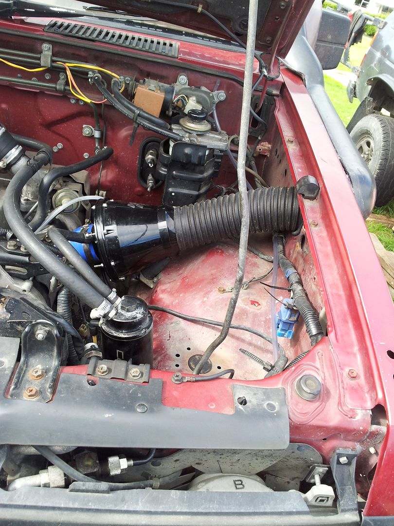

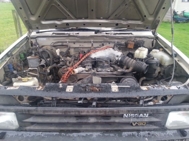

So a long story short I drowned my truck at the river no phone so no photos and a long walk to get a tow :cry: . Get it home pop the spark plugs out turn it over and hello its gas not river water :oops:
All the plastic and wires gone burger so got a parts truck for the motor and got a few things from the usa :mrgreen:

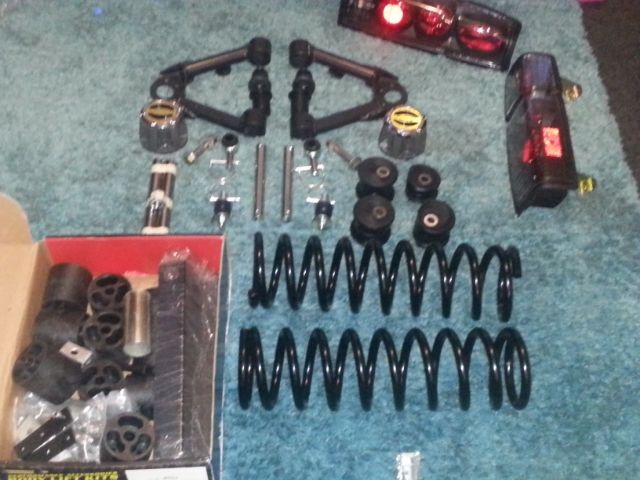

3" body lift to replace the 2" I have and a 3" sup lift to replace the 2" I have, uca's for the lift, diff drop down bushes, sway bar disconnect's, warn hubs and not in the photo is a c200 lsd for the front diff. The tail lights are ment to be for the pathfinder wd21 but are for a d21 navara so they are know good to me now. I just need good weather to get this done or a good cash offer on the parts :lol: I wont to start playing with the sv8 I just got :D but need to finish the truck

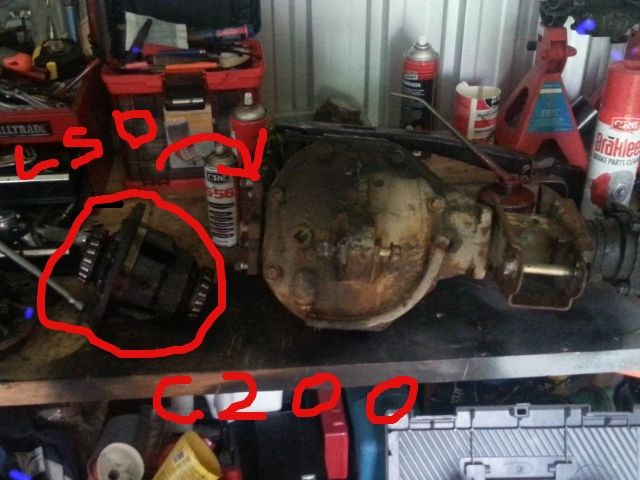

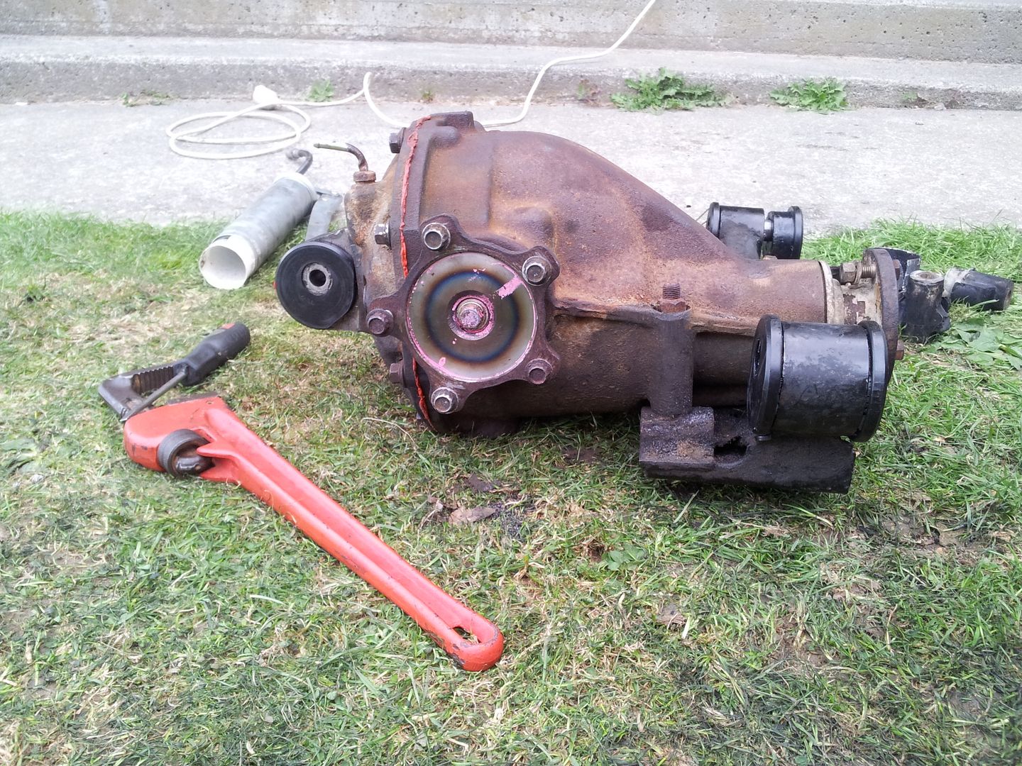

Now how do I get this in there? :? Mite start by opening it :lol:
And the best art work goes to :?: ME :lol:
slide
Posts: 895
Re: the rebuild
Post by slide »
tatnz wrote:Now how do I get this in there? :? Mite start by opening it :lol:
Check spline count is compatible by removing r200a side flange and try in c200 lsd sidegear. They most likely same @ 31spline, but lsd could be 33 spline if d22 era

And I guess this goes in here to hold the stubby axle in? is this the only mod needed

tatnz wrote:And I guess this goes in here to hold the stubby axle in? is this the only mod needed
Not the whole side gear... just the threaded dowel thing, its pressed in. You'll need to remove it and gently press it into the LSD side gear using a slide hammer or similar.
Rock onwards! :D
ps also when you strip the R200 down mark all the bearings/races individually, don't mix up bearing races. Also take notes/photos of the number of shims on each side of the carrier bearings. Reinstall exactly as they were, this way the carrier bearing preload settings won't be upset.

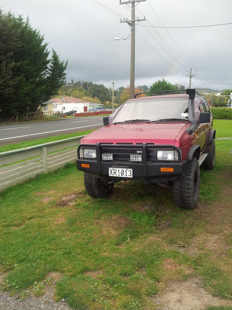

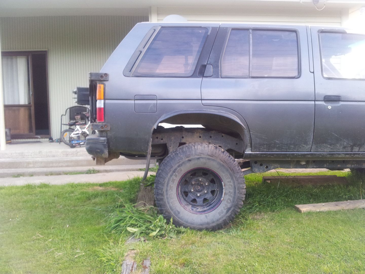

3'' Rear springs in with new shocks and 2''BL :oops: look at the small 32s :x

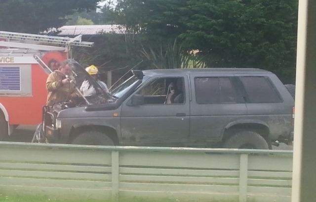

2'' rear springs and 2''BL and the local fire brigade :roll:
I don't know if I want to put the 3" BL in the thing looks high as now :roll: but if I want the 35s under there I guess ill have too :twisted: .
What are your thoughts :idea: man they look good
I don't wona end up like this chap :lol:

might pay to check if ya can get certification for the 3'' body lift before ya put it in. as im sure max is 2'' but I may be wrong. with the 35'' tyres are ya moving the rear axle back or tubing gards ? keep up the good work.
tatnz
Posts: 59
Joined: Fri Apr 01, 2011 8:48 pm
Location: southland
Re: the rebuild
Post by tatnz »
I was going to cut right up to where the door meets the body and then make and weld steel flares and the front guards will be cut about the same. Kind of like this
