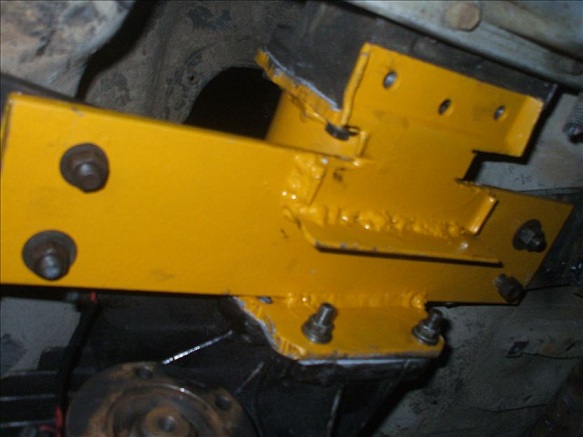

Thats all the transfer bracket is, i used round tubing and my mate uses a piece of square.
Seen them expensive on tm but mine cost nothing (maybe rods and cutn discs), also painted mine cat yellow to try and hide how horie it is. I actually cut a inch off the gearbox shaft to shorten it up a little, but that contributed to my ugly angle on the front drivshaft.

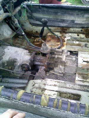

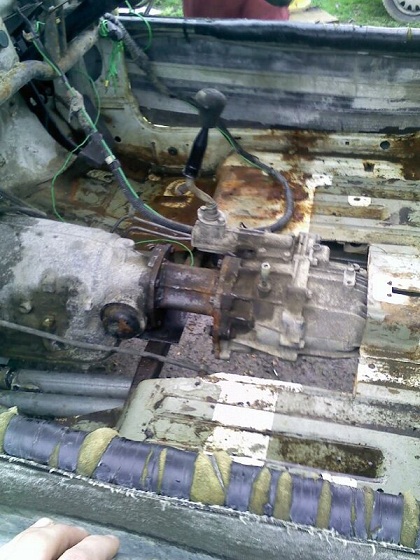

Have you made any progress with your conversion yet? I'm about to start doing the same conversion but into a 98 bighorn that was running a 3.0 DOHC diesel. I have been reading the comments about transmissions/gearboxes with great interest because it would seem the transfer case from my Torque On Demand system is not going to be suitable for mating to the back of the commodore trans...
I do have a good 3.1 manual box and 2.8 manual box, if I could somehow get 1 of them to fit onto the back of the 3.8 I've got, I'd be a very happy man. Although running an auto wouldn't be the end of the world!
Re: 1993 bighorn engine swap
BlairH wrote:Have you made any progress with your conversion yet? I'm about to start doing the same conversion but into a 98 bighorn that was running a 3.0 DOHC diesel. I have been reading the comments about transmissions/gearboxes with great interest because it would seem the transfer case from my Torque On Demand system is not going to be suitable for mating to the back of the commodore trans...
i know the 2.8 manual box can be adapted on to a vn 3.8...cause we got one... we just made a 5/or 6mm adapter plate. skimmed the back of the flywheel so adapter plate fits. spun the diameter down a bit so fits in bellhousing.used vn flywheel and pressure plate with izuzu clutch plate.goes pretty good, have blown up rear diff twice(spat spiders out and then welded it up....) and snapped the rear output shaft of gearbox in two when diff locked up... ours was done on the cheap( read under 500) as only a paddock hack!
also vn v6's are stupid easy to hook up electrically
