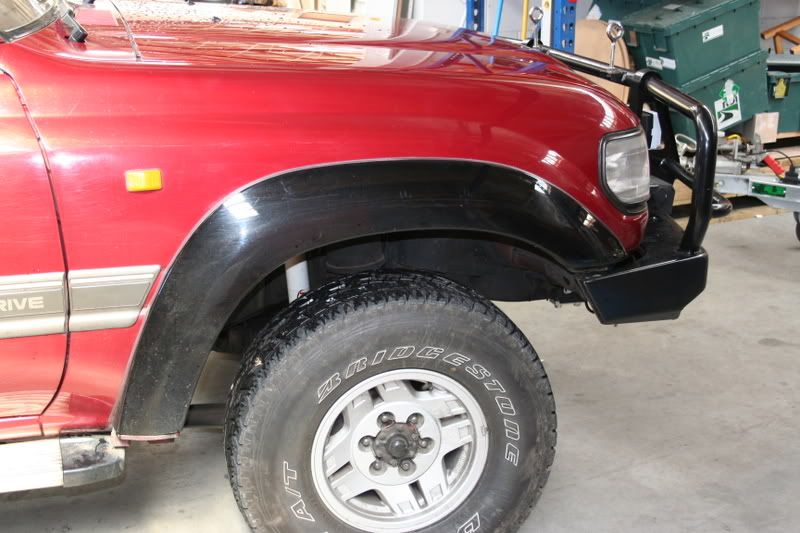

The snorkle fits to the drivers side front guard:

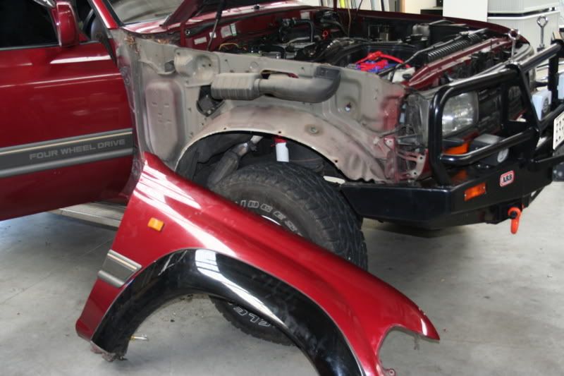

Due to the Landcruiser having a steel inner guard as opposed to a removable plastic inner guard as commonly found on most other 4x4's, the guard needs to be removed fromn the vehicle.
So to get the ball rolling, remove the corner light:
Remove the mud flap:
Undo the row of bolts holding the gaurd to inner gaurd:
A coupleof tricky bolts in behind the head light (I used a 1/2" drive air ratchet to get these ). The nuts are captive, but broke free, so i used the vice grips on the now loose nuts:
Remove the row of bolts ontop of the gaurd:
Then the one behind the door, easiest to get with the door open
Remove two screws from the vent section infront of the windscreem to get the last sneaky bolt hiding under there:
Slide underneath and get these three bolts. The forward most bolt has a captive nut, and as you expect it broke free and got the vice grip treatment (almost got the angle grinder treatment )
A bit of very carefull wiggling and teasing to break the sealant joining the guard to the inner guard, be carefull, you don't want to twist or tweak the guard out of shape. I had to go round the joint with a screw driver and leaver it apart carefully.

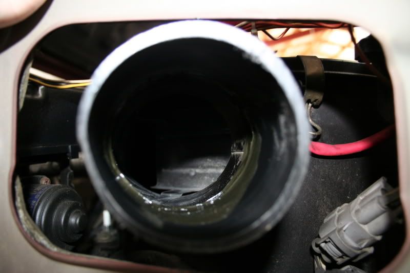

Remove all of the intake ducting that is now exposed
There's a hose clamp onto the airbox:
And a couple of nuts on the engine bay side. To get the rear of the ducting out, you really need to remove the cruise control unit, but considering the snorkle is a perminant fixture, i just got a bit of metal fatigue action going and broke the bracket off

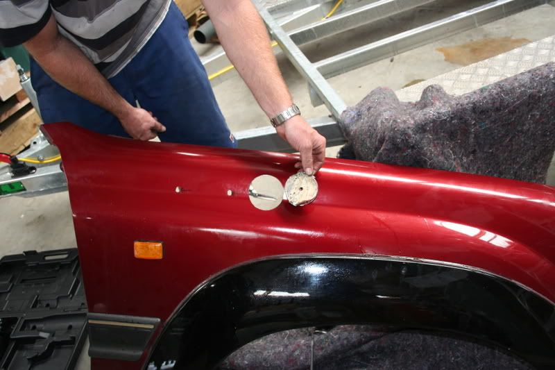

Set the guard down somewhere safe and cut the template out as per instructions supplied with the kit:
Line the template up on the guard REALLY carefully and tape it there:
Measure the positions of the holes on the template relative to the mounting holes etc on the snorkle. The template is a guide only, the snorkle can distort during the cooling process as it comes out of the mold, so there is a certain amount of variation expected:
Once your happy, center punch the centers of the holes as shown on the template:
Pull the template off and drill your pilot holes using plenty cutting fluid on the drill bit:
A couple of guys dropped in to say Hi' and i got distracted, so forgot to take a photo of this part. Cover the area you are going to attack with the hole in masking tape, this helps dissapate the heat generated by the saw. Use HEAPS of cutting fluid and go really slowly and take your time.
The end result will be something like this:
