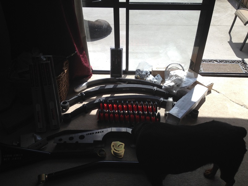

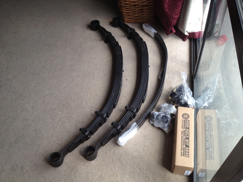

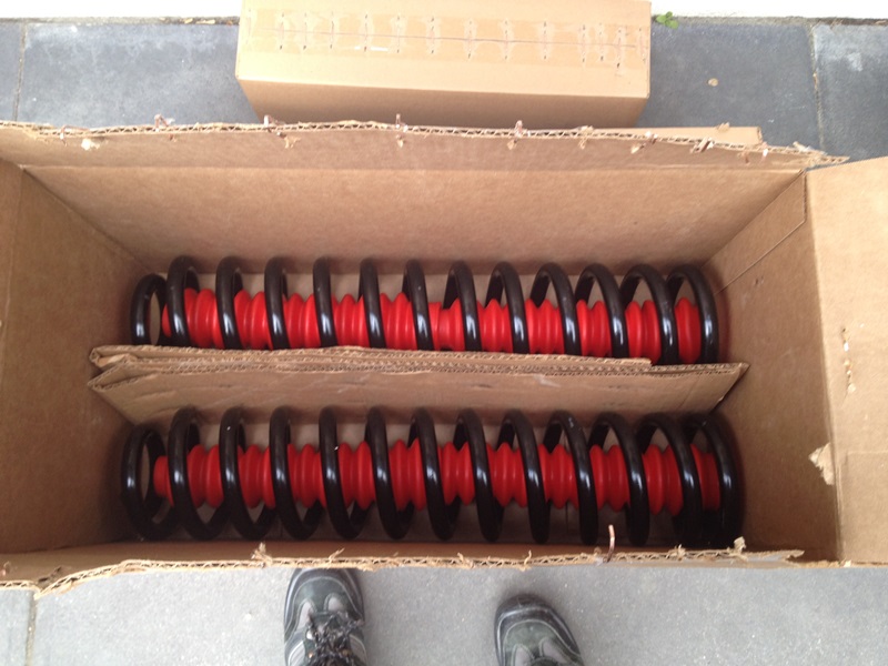

Shipment #1 has arrived - stoked as! (Still need to do a parts check)

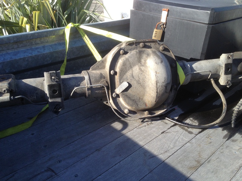

Stripping down the ford 8.8 diff and cleaning it up ready for my welder to weld the new brackets on and get the sleeves welded up this weekend. Not sure when I'll have it back, but I'll make sure I take some before and after photos. Following that I can chip away at piecing the kit together on the truck in my spare time. (Change of plans 01/03/14)

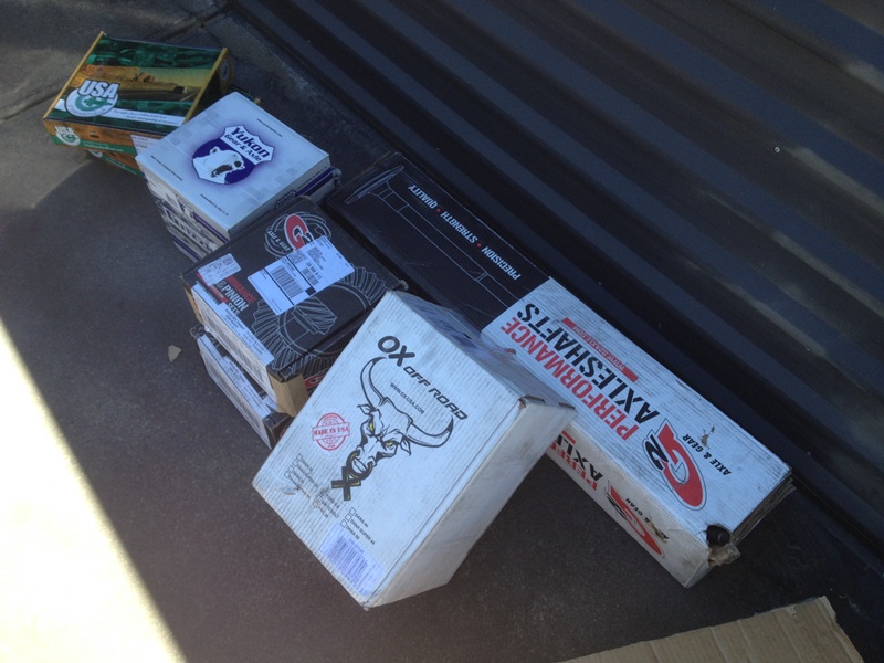

Next goodies arrived!
G2 Chromoly Axle Shafts
G2 4.88 Ring & Pinion Gears (Ford & Dana)
Yukon Grizzly Locker
Ox Locker
Diff Rebuild Kits
Ox Locker
Diff Rebuild Kits
