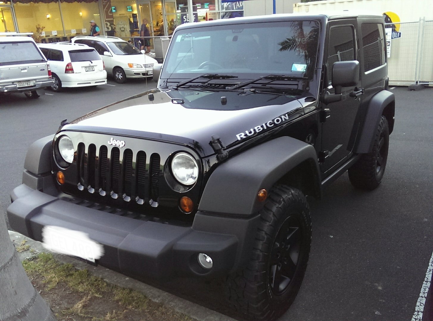

Postby TJ » Wed Apr 01, 2015 7:34 pm
Just to capture starting point. This was on the day I bought it.
I'm sure it won't keep looking like this for too long.

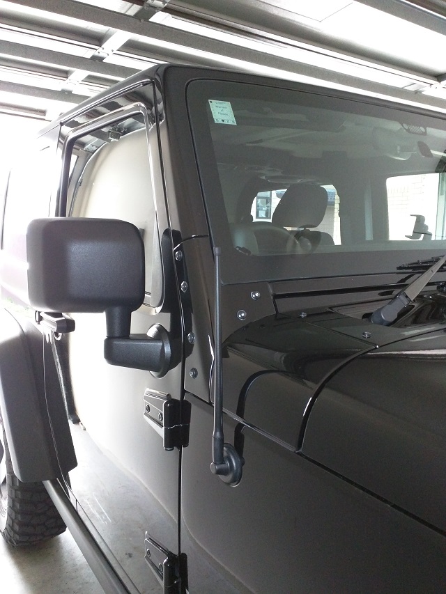

Postby TJ » Wed Aug 26, 2015 8:39 pm
Changed the antennae with this one from ebay (http://www.ebay.com/itm/191309985215)
Looks much better (no chrome).

Re: JK Rubicon journey
Postby sketch » Wed Aug 26, 2015 8:46 pm
Nice, those stubby antennas are neat. Be careful though as they can sometimes loosen themselves easily overtime :roll:

Postby TJ » Wed Aug 26, 2015 8:49 pm
sketch wrote:Nice, those stubby antennas are neat. Be careful though as they can sometimes loosen themselves easily overtime :roll:
I had put a little bit of thread locker as recommended in the instructions.

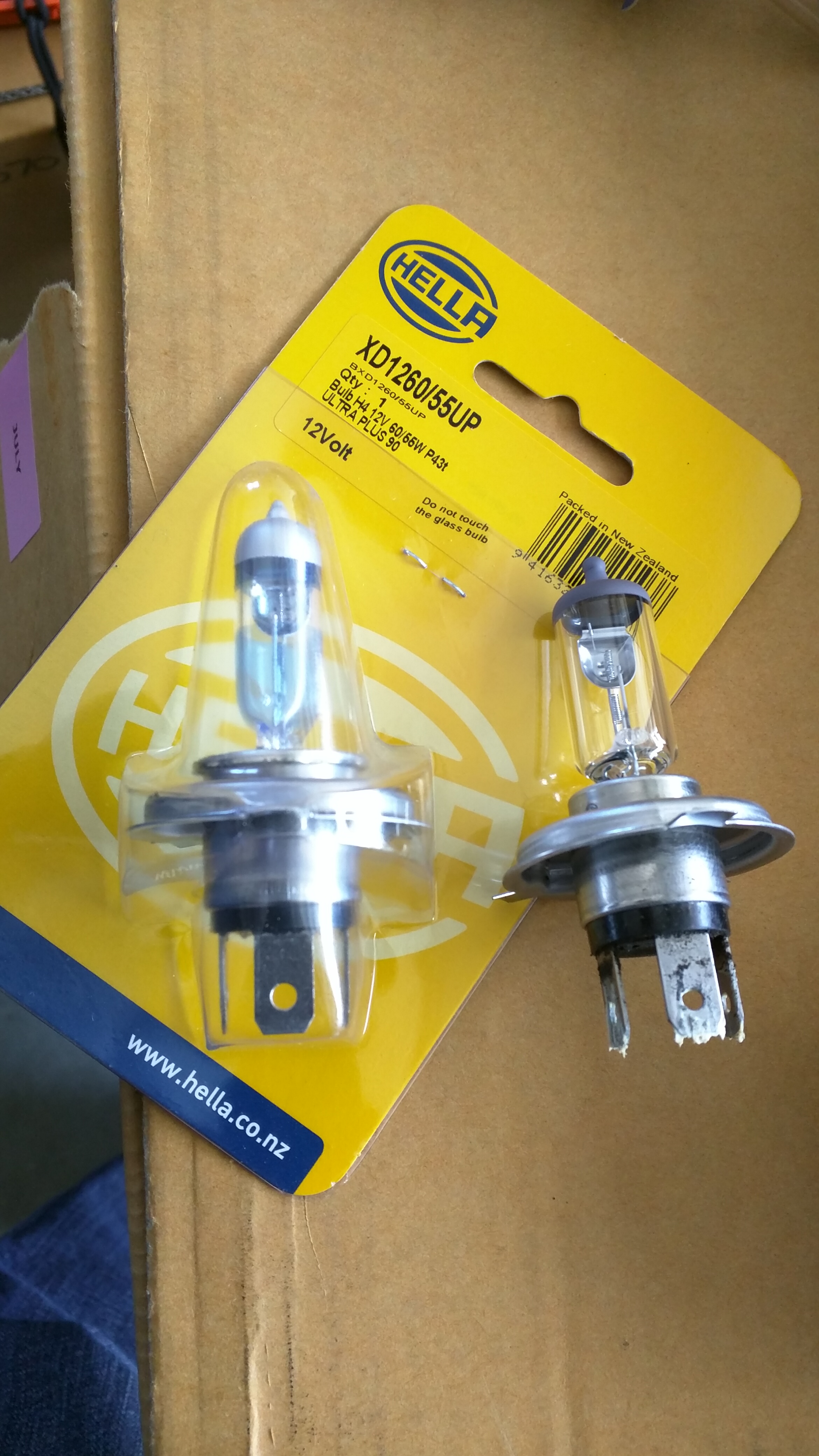

Postby TJ » Sat Sep 26, 2015 3:56 pm
Changed headlamp bulbs to Hella H4s which are brighter than factory.

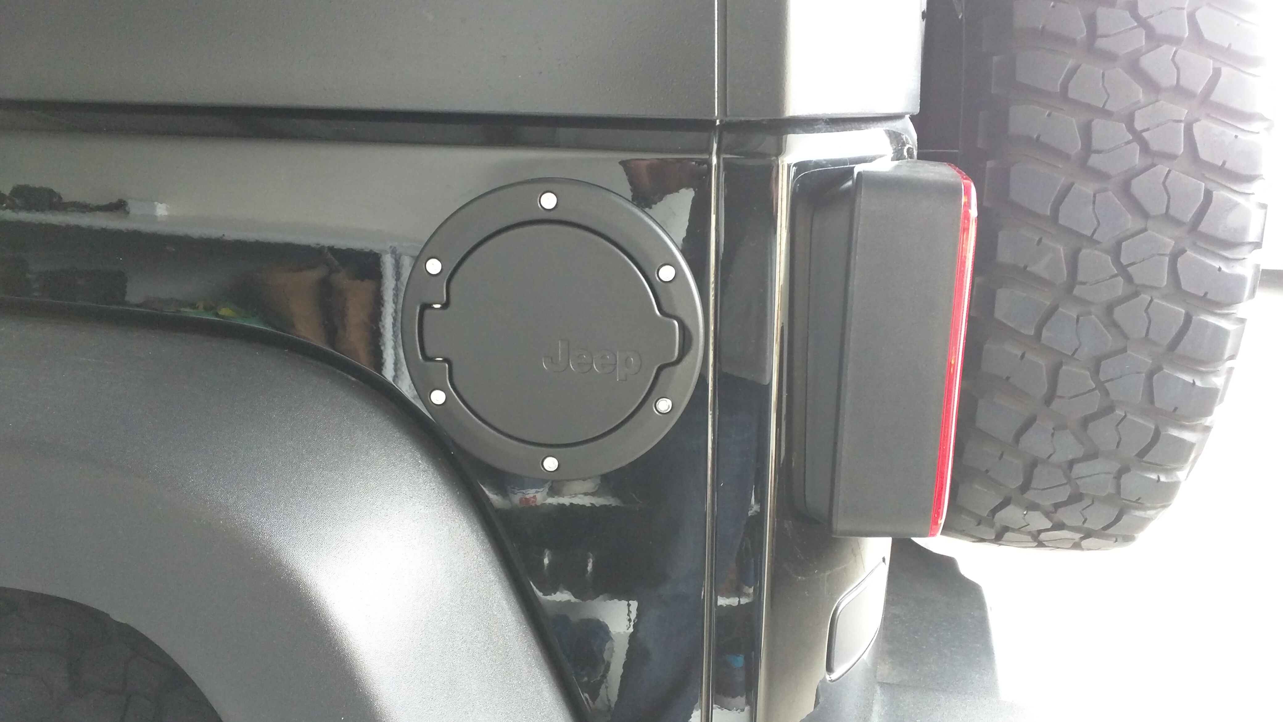

Postby TJ » Sat Sep 26, 2015 3:57 pm
Gas cap cover from Jeep

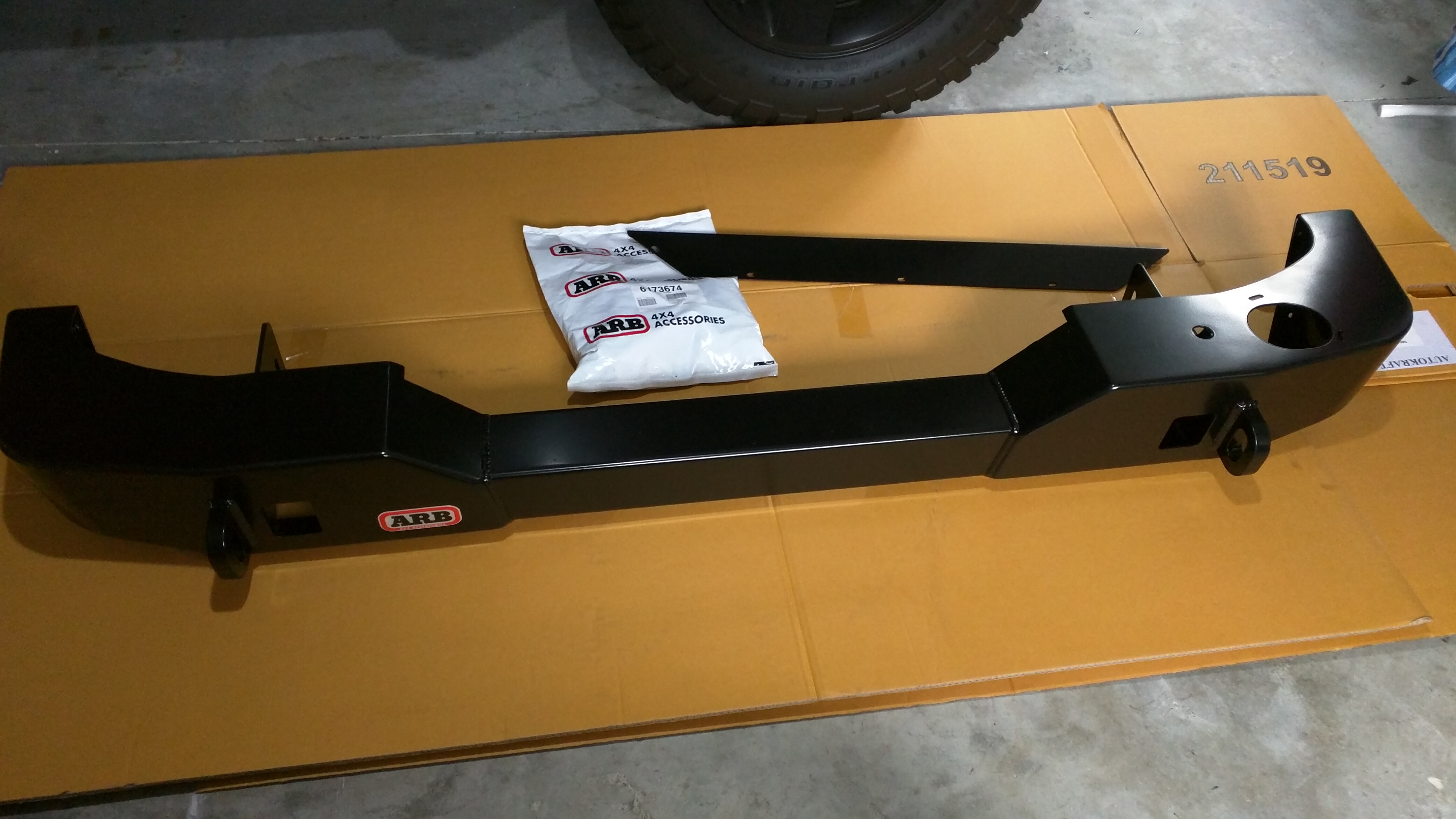

Postby TJ » Sat Sep 26, 2015 9:51 pm

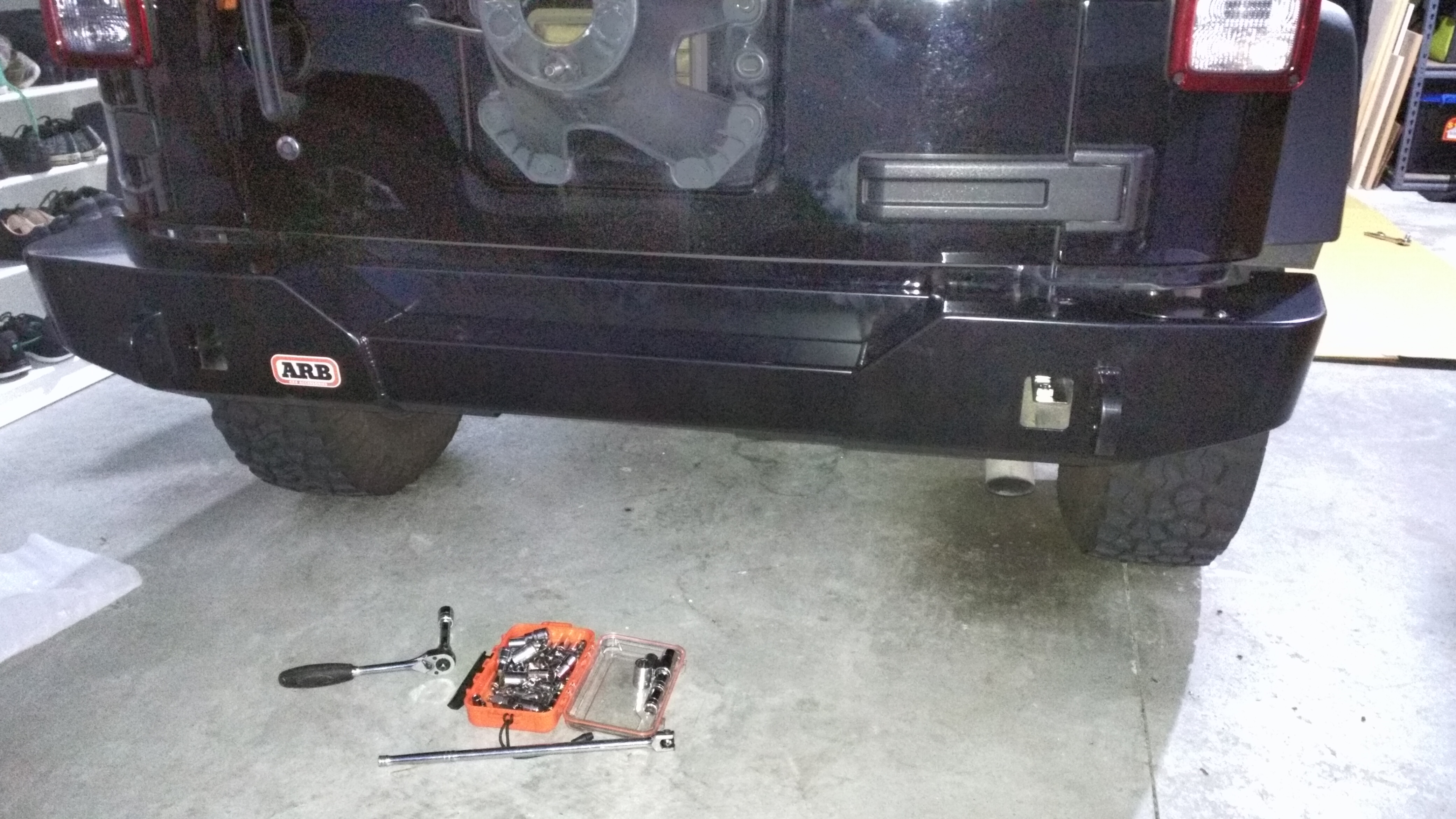

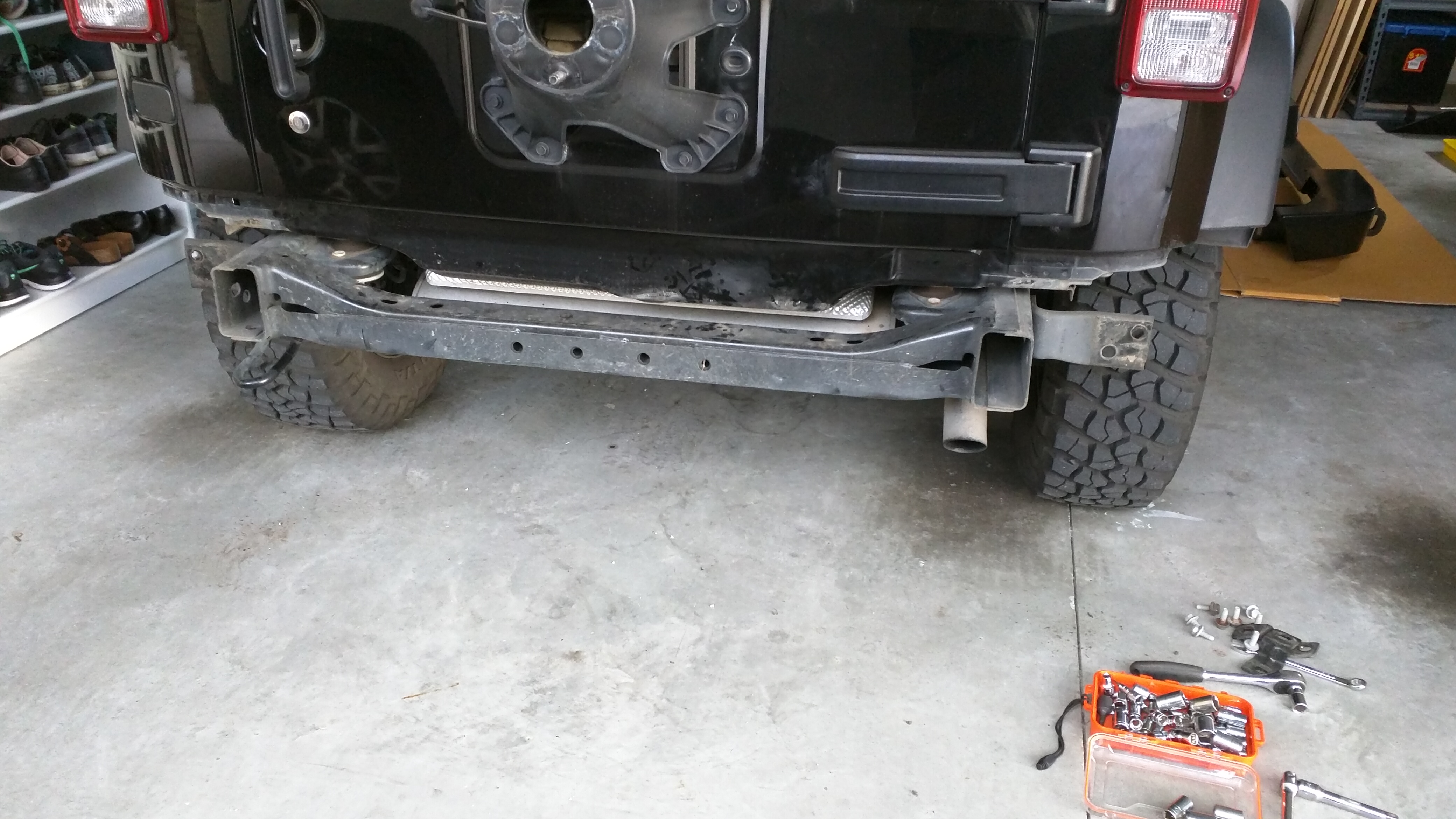

Just 75% done with rear bumper change. Need to do a couple of final bolts. Then license plate relocation.
'12 JK Rubicon V6 3.6L Auto D44/D44

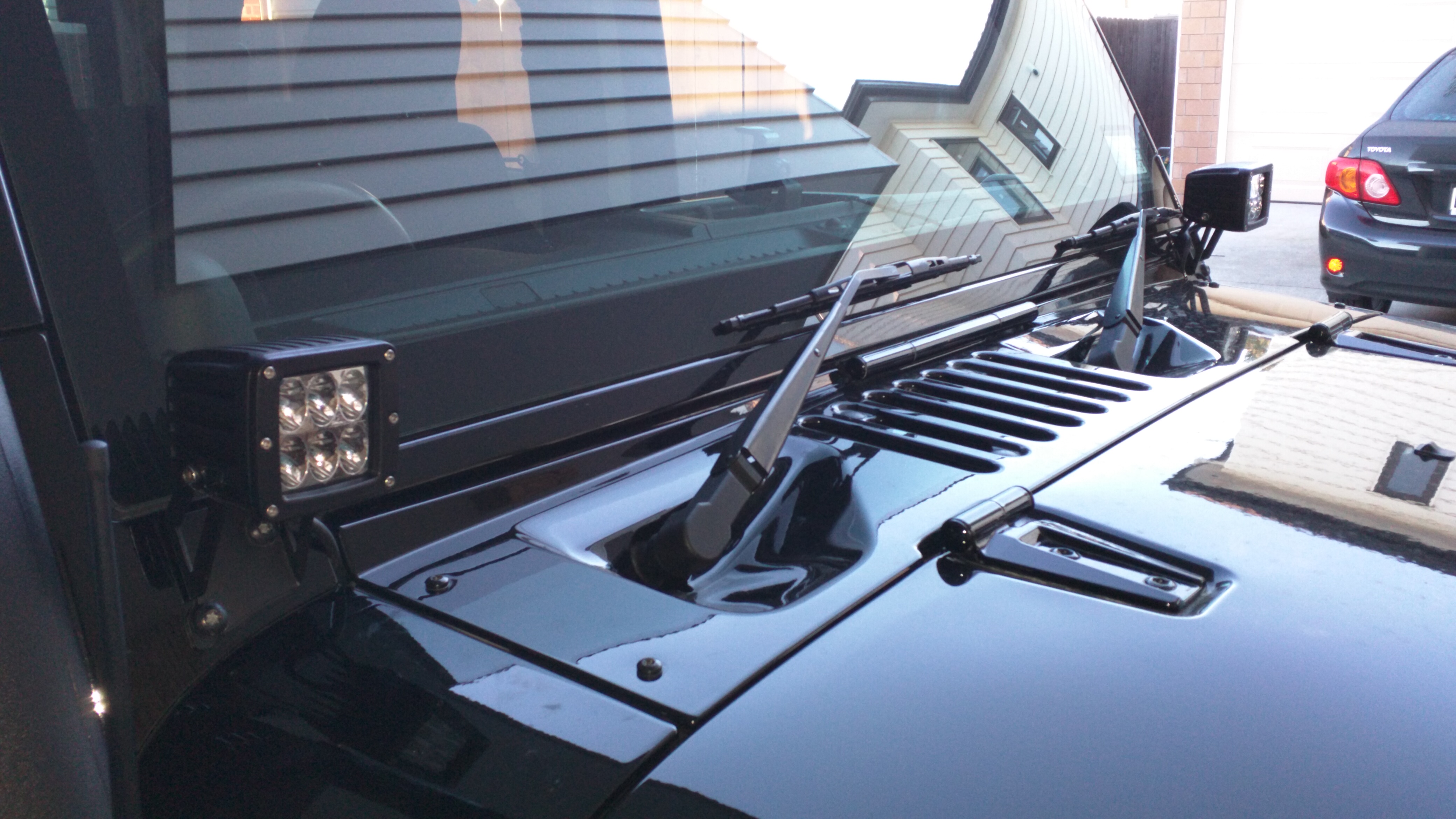

Postby TJ » Tue Sep 29, 2015 7:13 am
Windshield led spoties done.

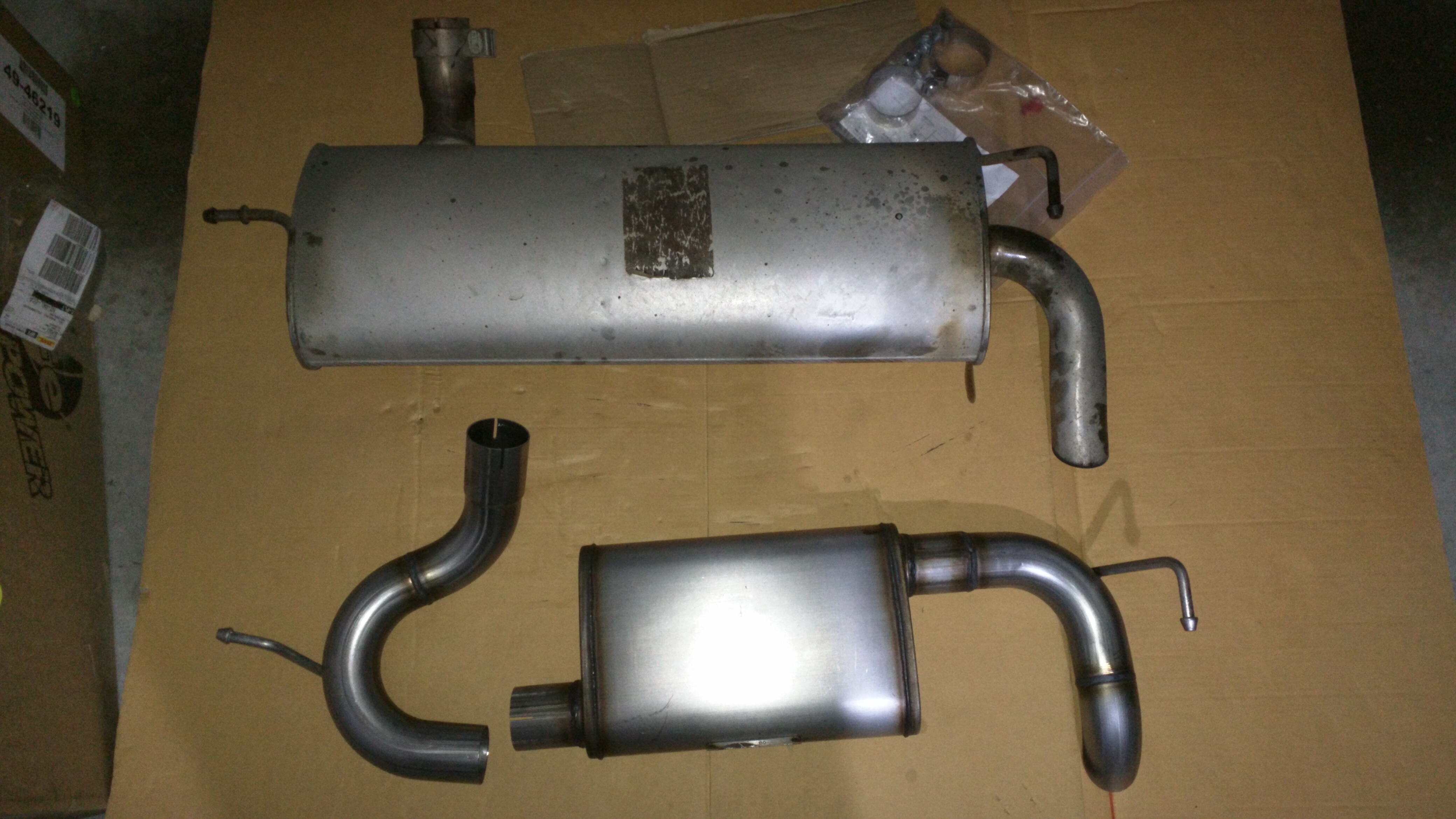

Taking the big pillow off and putting on something more manageable.
TJ
Posts: 2060
Joined: Thu Oct 12, 2006 12:00 pm
Location: in a Jeep
Postby TJ » Sat Oct 03, 2015 9:10 am
All done. Can't even hear the difference while driving.

Good job with the muffler, that's one modification I always wanted to do but never got around to it...just became a dented mess in the end :lol:

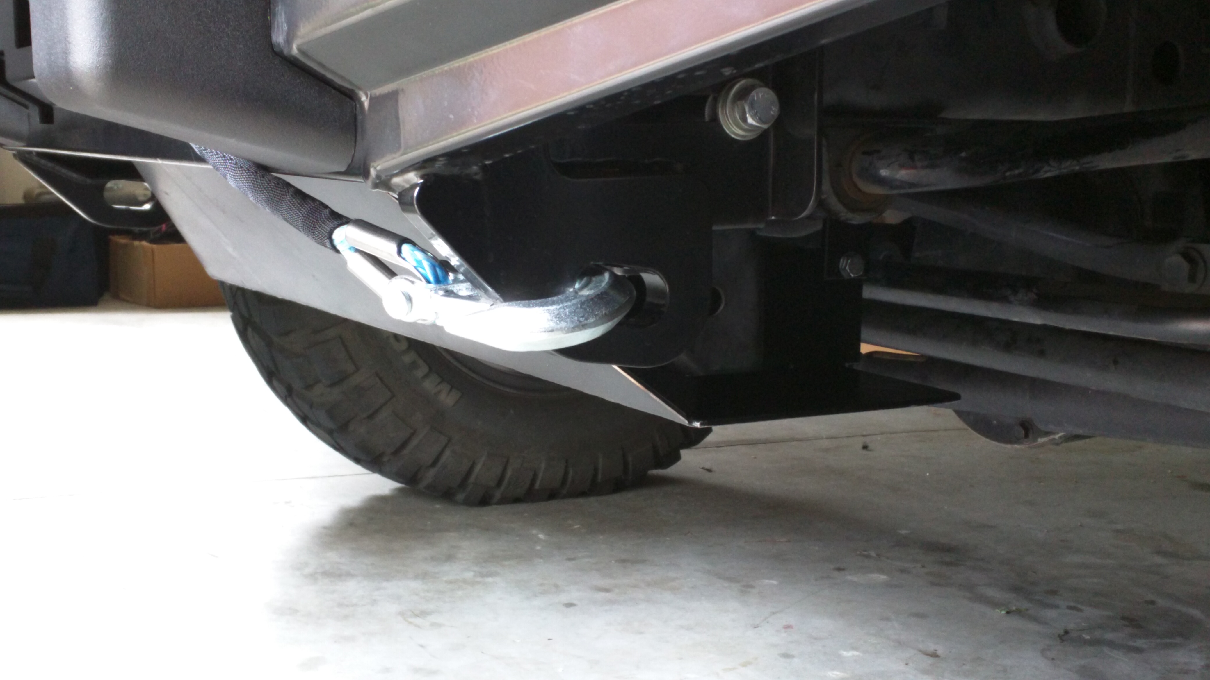

Installed front skid plate from Black Jack Welding in Australia. It fits perfectly under the ARB front bar.
I probably need a lift now after all this weight up-front.... :-)
