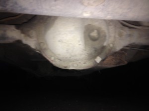

Its either a Dana 35c or a Chrysler 8.25.
Hard to tell from the picture.
If the housing has a flat bottom its a C8.25

dana 35 c I think
