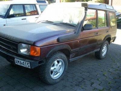

Got motivated by the pics of guttix's 300tdi Defender and decided to have another go at getting Dad's old Discovery running. It has sat in the garage partway through a timing belt change for about the past 5 years. I had a look through some helpful threads on aulro.com and worked out when we last had a go at it 6 months ago that we had the injector sprocket misaligned.
Now sorted it and have a running 300tdi Discovery. Yes that is dust on the bonnet.
Now to try and get a WOF on it...

nstacey - nice work, tidy looking disco (and another in the background...). Does your 300tdi have the changed idler/tensioner/crank pulley? Apparently heaps of problems with them in the late 90's...Rover put out some new parts, and the tensioner changed to one without a lip...and the crank pulley got a lip to hold the belt. Mine hadn't been done...so when I got my parts things got confusing...but sussed now

guttix, yeah it still has the original tensioner design (although a new part) and the original crank sprocket. I was of the understanding that the ones that were going to fail would have by now. This one is a 1994 with 215km on it.

nstacey wrote:guttix, yeah it still has the original tensioner design (although a new part) and the original crank sprocket. I was of the understanding that the ones that were going to fail would have by now. This one is a 1994 with 215km on it.
Unless you so for the revised kit the cambelt will wander and wear on the sides meaning you will either suffer failure or be replacing it again sooner than you think. The belt has been known to wear through the front cover and thats expensive to replace. Complete combelt kits with new pulley and tensioners etc are available at such reasonable prices that its foolish not to upgrade.
Re: 13-14 October 2012
yeah for the money I'd get the new setup...rather that than the belt going, and you're up for new pushrods/valves etc
http://www.landroverspares.co.nz are awesome, real knowledgeable
