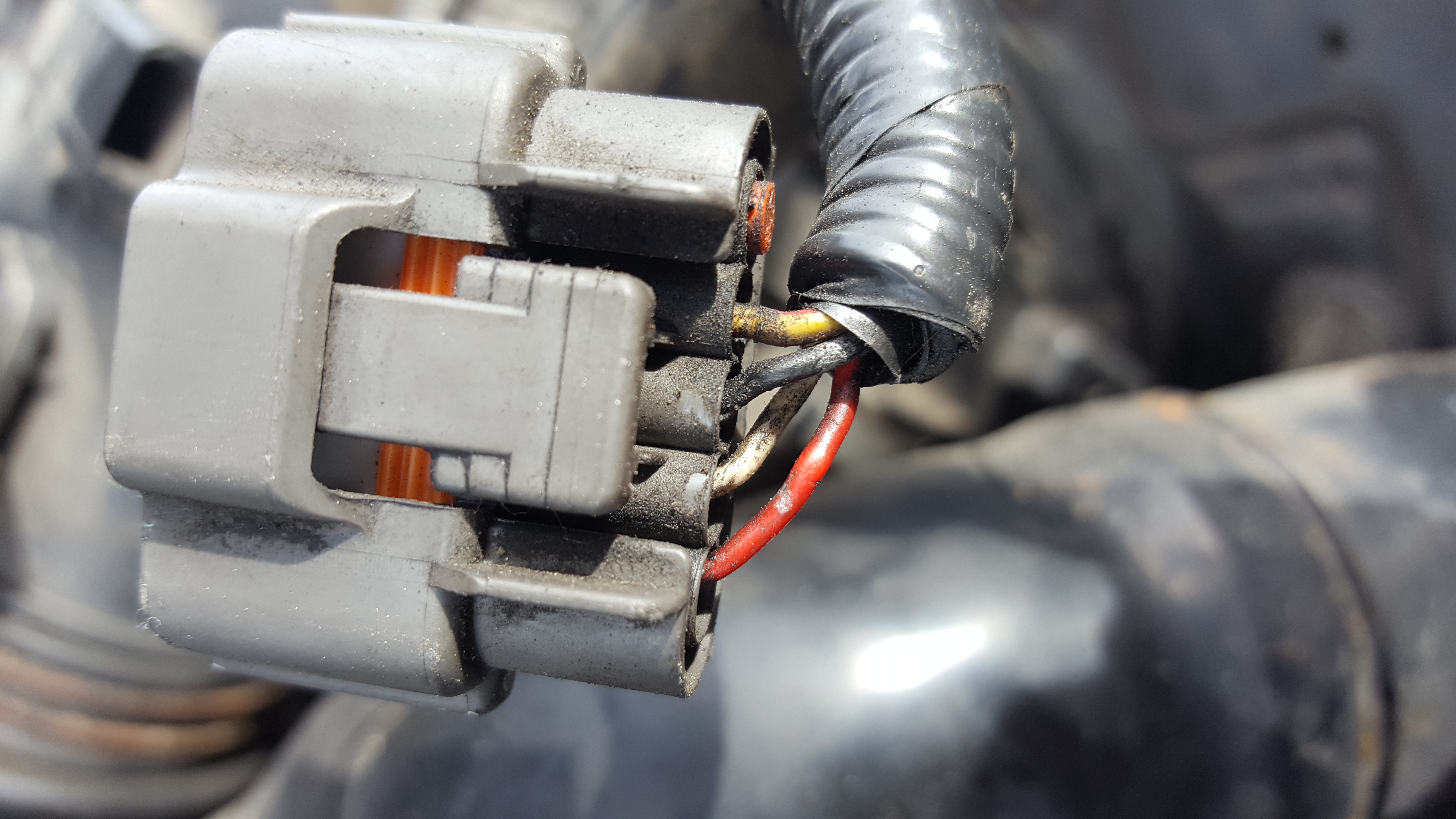

Post up a picture of each AFM plug. Although the AFM isn't plugged in you should still be able to start it up it will just throw up the engine check light.

does this work? trying to do it off my phone.

last pic is the zd30 loom

Bompie wrote:20170827_092941.jpg
That one is easy. Positive ,negative and ecu value out
Use the qd a.f.m the zd30 plug will have a temp sender as well for ambiant air temp.

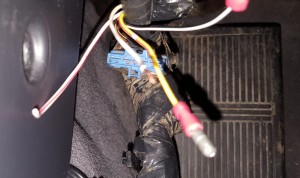

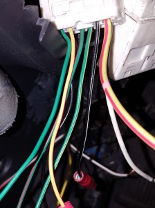

Tonight's update. It runs. i went back to the doner truck and traced the wires. the red/white goes to egi relay pins 3,6,2 the white goes to egi relay pin 7. The yellow/red goes to egi relay pin 5. the black/white goes to fuse box fuses 16,17,21,22,25.
so back to the 2 body loom plugs i joined the black/white together. i joined the 2 white together . i joined the small yellow/red(qd side) to large yellow/red(zd)side. then ran the a 12v+ to white/red. and from that it runs. i havnt hooked up the temp gauge but i know its the small yellow/red on the zd side of body loom plug. hope this info will help anyone else in the same situation.
