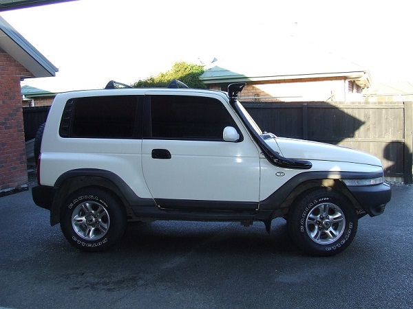

Had a good chat to Tom, bit out of my way as I live south of Chch. Anyway sourced an after market snorkel kit from Taiwan - might be a copy but the specs/pics look okay, waiting for delivery in about a week. $NZ453.00 plus fitting.(shipping was $110.00). See what happens.
Re: Korando 2.9 litre diesel
After market snorkel imported and fitted - had to settle for fiberglass. Fitted by 4wd Upgrades in Chch. Something different! Getting a new bash plate made shortly - original one is hopeless. For interest sake standard ground clearance is 215mm from rear diff.

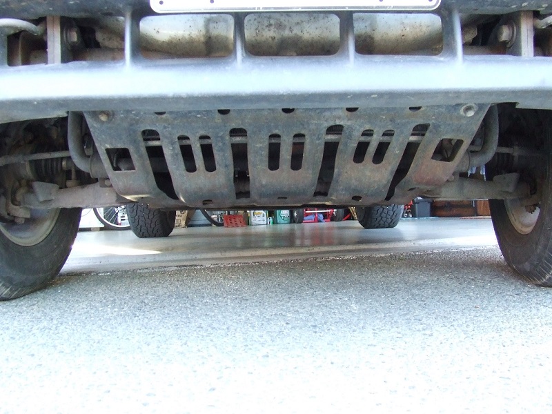

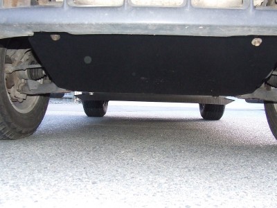

Got rid of the original bash plate - too much ventilated and was worried about sharp things getting through! Replaced with one piece 3mm mild steel and taken back to the front drive shaft, 6 bolts though bit concerned about two bolt heads that may get the bash! Maintains front lowest point 215mm ground clearance, middle cross member 220mm. Goes okay up the Wilberforce Valley so far.

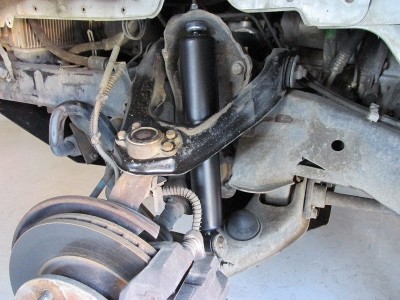

Replaced the original front shocks due to too much bounce, with Monroe Adventures. Went for a drive, heaps more control in the rough and better cornering at speed on the highway.

Only real main accessorie for me was the imported snorkel which has worked well to date with a filter sock from Mudstick fitted for summer shingle roads in Canterbury high country.I do carry a small compressor behind the front seat for off road from Supercheap that plugs into the cigarette lighter (and it inflates tyres well), x2 ridge ryder branded recovery ramps (have used once in snow so far), spare jack, shovel, strop, upgraded the head lights with bit more powerful bulbs, changed tyres including spare to same tread from 15"to 16" 245X70X16 AT. Any spares such as oil filters from TM at half the dealers/garage price (about $26.00). Oil changes are easy on the Korando - filter up high so good for access. Best place to get the oil is usually from either Repco or Supercheap when on special as the sump takes 9.5litres. Have fitted black canvas seat covers too from Supercheap. And changed some internal lights to led type. Standard fire extinguisher in passenger glove box. That's about it.

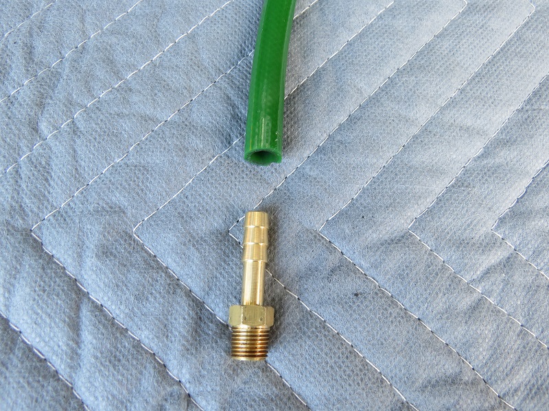

Just for info, fitted extended rear & front diff beathers using what i was told was universal Ironman kit for my vehicle. Not quite really.
Initially removed my rear factory diff breather and replaced with the Ironman brass fitting. Then noticed the smaller internal diameter of the Ironman brass fitting compared with the larger internal diameter factory sizing for the hose though external thread the same. So removed the Ironman brass fitting and re installed the factory one with thread tape applied. Then fitted the Ironman green tubing and ran it along the axle upper housing then along the left upper chasis to the firewall securing along the way with zip ties. Using my high lift jack, checked the suspension travel to alllow a small amount of slack in the hose length. Then installed the Ironman filter bracket etc.
Working on the front diff, the Ironman supplied brass fitting thread size was slightly too big to fit? So fitted back the factory one and refitted the original rear diff breather hose (was about 1/2 metre long) as the front diff fitting had a fatter external tube size for the Ironman green tubing (what were Mercedes thinking?) and then secured just below the upper firewall. Out of the whole Ironman kit, only used part of the green tubing and their clamp for the rear diff - rest is surplus! I suspect more common 4wd kits work out better for the the majority?
Now to find the manual transmission breather - still looking!
