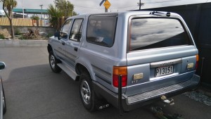

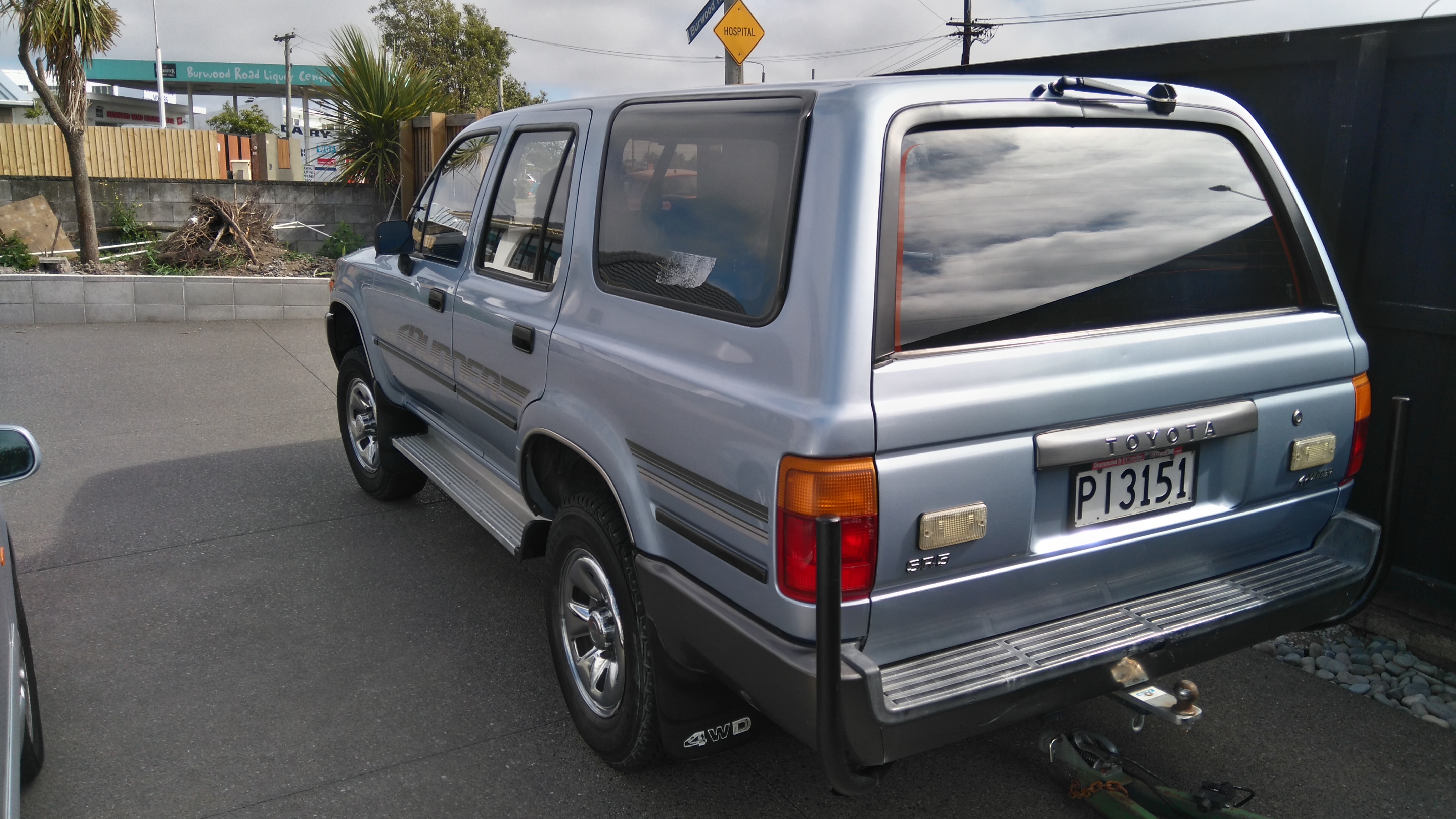

About 6 months after I sold my 80 series, my brother decided to sell the 4Runner that my Dad bought new in 1990.
It had been used for towing a horse float for the last 8 years or so and was dirty/smelly and really gutless, add to that a rear diff whine and leaking radiator, but the price was very right and it was nice to have Dads car that I first drove when I was 18.
It still had the original Toyota washable air filter and spark leads, so new plugs, leads, dist cap, rotor, air filter and an oil change wasthe first on the list.
5 evenings of cleaning to get rid of the dirt and horse smell.
New shocks
Get rid of the catalyst and leaky muffler and put on a nice big muffler to keep it quiet and breathe well
New crown wheel and pinion on the rear diff with the LSD tightened up.
Front seats from an SSR-X as the originals were knackered.
On boxing day I got bored so gave it a polish.
It will never be a hard core 4wd but will do what I want it to, the little 2.4 petrol wont win any races but isnt too bad, (now it can breath) certainly better than the 2.8 diesel one we had for 10 years before I bought the landcruiser.
Im working my way through sorting out vibrations and noises, new ujs have fixed some but the driveshaft feels unbalanced at 100km/h
At the moment its a 2Runner as the transfer box is noisy and seems not to disengage the front driveshaft properly so I took the front driveshaft off to keep it on the road until I can get another t/box.
