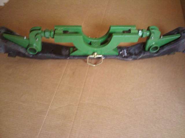

Check out this idea that someone came up with for their Vehicross. It make the torsion bars work with each other to mimic the leverage effect of a solid axle.
Its no longer in production, looks like a clever idea that could be adapted to fit most torsion bar setups (Toyota may be difficult since the T-Bars are mounted nice and high)
I have cut and paste it all below.
SUPER FLEXY IFS KIT
I have designed, fabricated, tested and patented a new set of parts that allow IFS to articulate in ways that were not possible before.
The parts attach to the OEM locations and require no drilling to install.
The design is such that the two torsion bars are now semi-connected and interact with each other...
The SUPER FLEXY IFS KIT allows one tire to be at FULL COMPRESSION while the other tire is at FULL DROOP, AND more importantly while the tires are in these extreem positions, the weight is ballanced between the two tires MUCH MORE evenly, and the vehical remains much more level, while increasing traction....Typical OEM syle IFS does not allow this as much.
Also, as one front tire climes an obstical and compresses that side of the suspension, the KIT transfers force to the other front tire, pushing it downward...
This does a few things...First, the tire climing the obstical has its spring rate decreased, allowing it to stuff farther and easier and sooner up into the wheelweell untill it reaches maximum compression (bump stop)... at the same time, the tire on the opposite side has its spring rate increased, pushing it down into the terrain...
For example, With this Kit, You can drop one front tire into a 4" deep rut while the other front tire is sitting on a 4" tall rock, and maintain EQUAL tire preasure on both fronts, and maintain a more level vehical as well.
Included is a SECUREMENT PIN that allows the KIT and the susension to function as per OEM design with the PIN installed (for on road use)...Remove the pin for off road use and MUCH MORE ARTICULATION.

It took me a moment to realise the kit goes at rear of swaybars, not fronts. A clever idea, could be excellent in some situations.
I guess you could go surprise some people, and deal with (any) problems later?
The rocker mechanism could be made so that it only lets half, or quarter of each torsions travel to transfer to the other side. This would make for an improvement over OE, but not have the rock-over problems of a full-transfer rocker setup.
*post edited as I've interpreted design better

It is effectively disconnecting the torsion bars from the suspension and allowing the vehicle to roll at the centre point between the front wheels.

I found another thread on the planet... looks like a guy developed the system further, it mentions using an air line.. I copied and paste it again. These guys seem to be measuring it based on increased wheel travel, I'm guessing still within the safe range, but more easily accessed by the leverage effect (I'm guessing). Note they tout the system as giving 'more stability'... interestingly in none of these threads increased rollover risk or safety is mentioned. Check out those sweet HD tie rods too.
Super Flexy IFS kit: Speak Now or Forever Hold Your Peace.
Postby VXorado » Fri Feb 01, 2013 1:25 pm
The time is finally here... Now is your chance to get a SFIFS kit if you missed out on Bigmeat's very limited production run. For those who are new the concept, it's a kit that connects the torsion bar loading & transfers IFS flex from one wheel to the other. It will mimic some characteristics of a solid axle and ultimately give you more stability & flex when you're in situations that force suspension articulation. I tested the kit about a month ago and posted my results at the bottom of this thread.
This kit is designed for a 2nd gen Trooper/Vehicross. There might be a kit made for 1st gen Trooper but it will be from other members here on the planet.
New design: I have moved the fixing pin location to make it more accessible and easier to remove/insert. I've also included a setup with an air cylinder to remotely lock/unlock the kit from the cab. This requires 100 PSI on board air system.
Price:
Kit without air cylinder setup: $425
Kit with air cylinder/switch ready: $525
Shipping will be additional.
Each kit costs around $270 to have fabricated + cost of stock. The prices could get up to a 30% discount based on the number of orders. This price is not inflated, it only covers my basic costs.
I had a poll set up but couldn't see who voted which made it useless. Please reply to the thread or PM me if you want a kit.
Test:
I installed the SFIFS kit on Sunday and did a quick test last night for suspension flex. I lifted the front passenger side tire until the rear passenger tire started lifting from the ground. I also did the same test on the rear tire and measured height in each scenario.
Results:
Front tire lift with SFIFS off: 24.2"
Front tire lift with SFIFS on: 26.5"
Rear tire with SFIFS off: 27.2"
Rear tire with SFIFS on: 28.8"
I'm happy with the results. I have 2.5" of down travel left in the IFS and the SFIFS used all of it to level out the VX when I lifted the front tire. Less lift or spacers on the upper control arm would add to the articulation. I bet a stock height VX/Trooper would get 5-6" in the same test because of the increased down travel.
