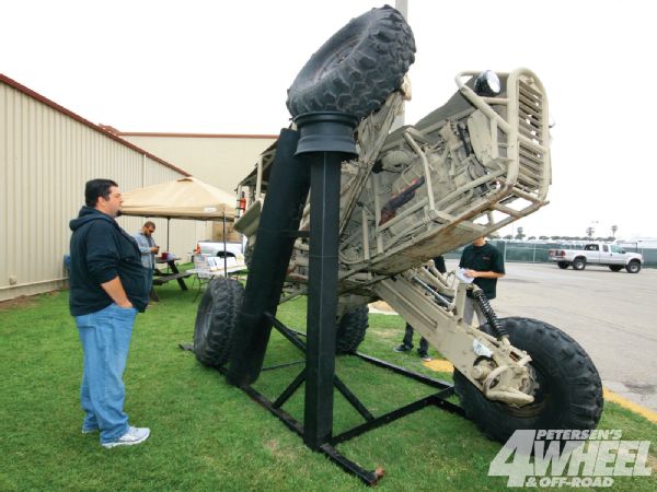

Here's an interesting independent suspension buggy
http://www.pirate4x4.com/forum/general-4x4-discussion/977540-godzilla-ifs-buggy.html

More development needs to be done on independent suspension systems for extreme off road use before they can be ruled out. Personally I see big gains to be made over a solid axle for almost all applications off road but the difficulty is that there seems to be so many more geometry options that it will be a long process getting through them all.
