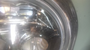

If the lights have an E mark then you will have no problems. I have a set from Caleb that I am not going to use as I preferred the chrome look but they don't have the mark. He has had them fitted for WoFs and got a pass . There are pics on his Facebook page filthy4x4.

Changed the headlights on my Jeep Wrangler to JW Speaker 8700 Evolution J LEDs. These are full replacement 7" beams and ECE and ADR approved for LHT use (i.e. RHD vehicles).
They make more non Jeep specific Evolution 2 8700s for RHD market. Extremely happy with the amount of light. Factory 7" Hella halogens H4 on Wranglers are from 1997 to 2016. Same light in export markets.

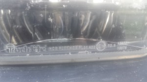

I have trucklite units in my l200 and they are nearly as good but cheaper.

Trucklites are now rebranded and sold through Narva in Australia (and New Zealnd). Margin is a bit more because of that locally.

Trucklites/ Narva, again are specifically designed as a lens and LED combination and work well.
