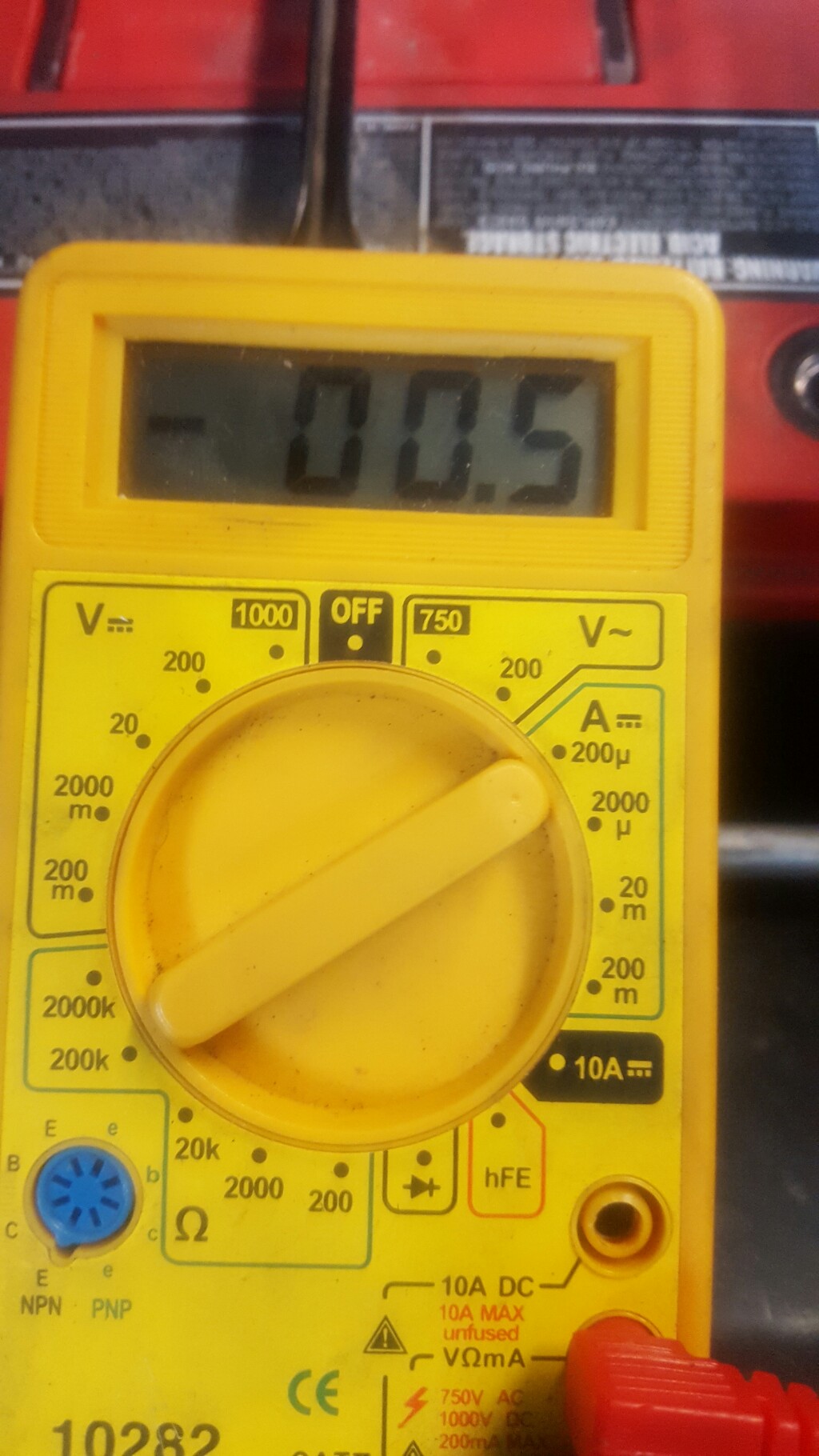

Here is the amp draw.

timmay556 wrote:20160725_173927-1024x1820.jpg
Thats exessive...0.05 is ok.
Start chassing and disconnecting stuff..cheak interior light's..then pull fuses one at a time to try trace circuit thats at fault

skidmark wrote:timmay556 wrote:20160725_173927-1024x1820.jpg
Thanks Skid, my volt meter just died after that photo (its 13 years old - cheapie from DSE) will have to buy a new one tomorrow and try again.
How do I test if its the internal lights? as it does do a funny thing ie when one door is open they all go on.

In my experience door switches are done on the negative side of the circuit, ie, if any point goes to ground, the lights come on.
In that picture you're reading microamperes. I'd flip it around to the 10A, put the lead in that hole and read like that.
Half a microamp is nothing to worry about.
I should have looked to the meter closer..thats very correct.
When youve got a working meter again chuck it in the 10amp scale.

I see you re correct, it was on milli settings, I will try again tonight with it set on 10. If that's the case and it is just 0.05 amps then I think it's new bat time.
I checked and it was just the fuse, however I've taken this opportunity to treat myself to a new one.

Again thank you guys. I've done the test again with my shiny new multimeter, 0.06 draw. So off to get a new bat tomorrow
