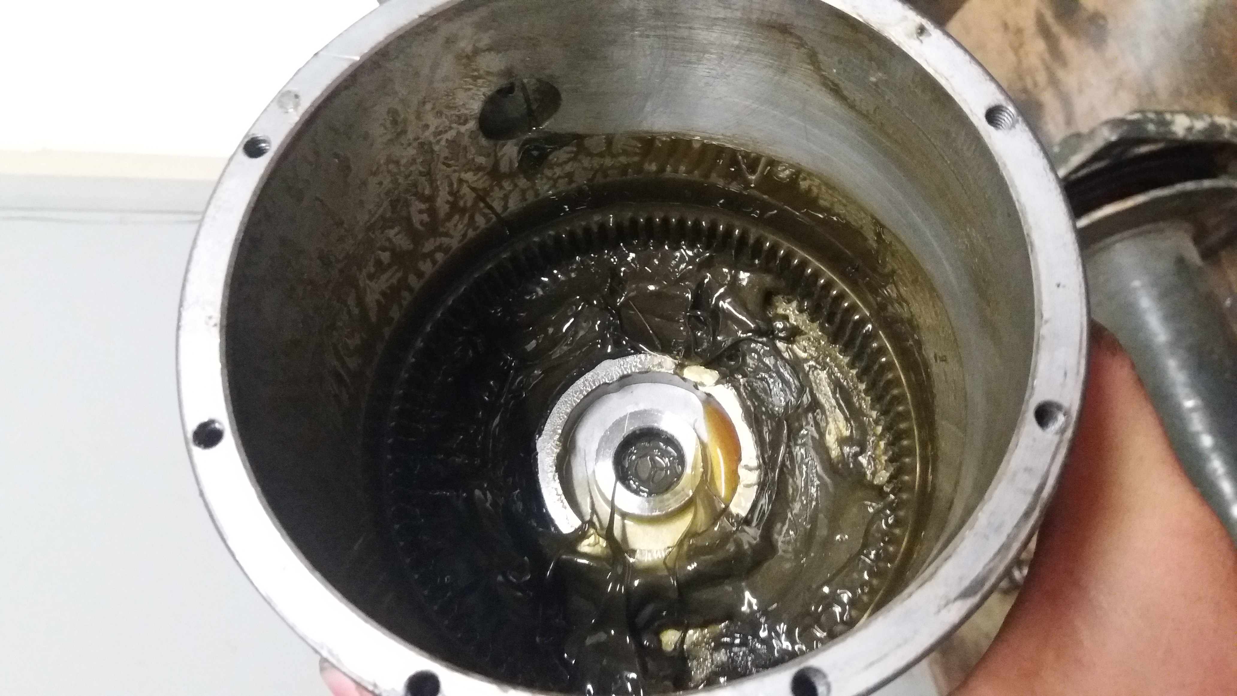

Stripped assesed it
And currently as I am typing and eating dinner it's sitting in a bath if supercheaps finest degreaser
Here's some pics
The standard horrid smelling grease is so thick im prying gears off shafts it's so sticky !
And we wonder why they don't free spool nice ? Haha

After tea I rinsed off the degreaser with hot water and flicked out all the grease from the housing the gears and the planatary plates
Cleaned the water off and re assembled and lightly greased the rotating parts and tho hear sets
Re assembled it all and used some 15/40 as lube
So from going to a struggle to free spool it by hand to using 2 fingers to spool it out
The plastic bushes on the ends of the housing want some lube so I threw some plastic spec lube on them .the seals onto the drum will get vasolined so keep them nice and fresh
I will do some research to find out what can be done with the brake inside the drum to make it happy and nice
Hope this helps someone with some problems or to gain some hp to a old gummed up winch

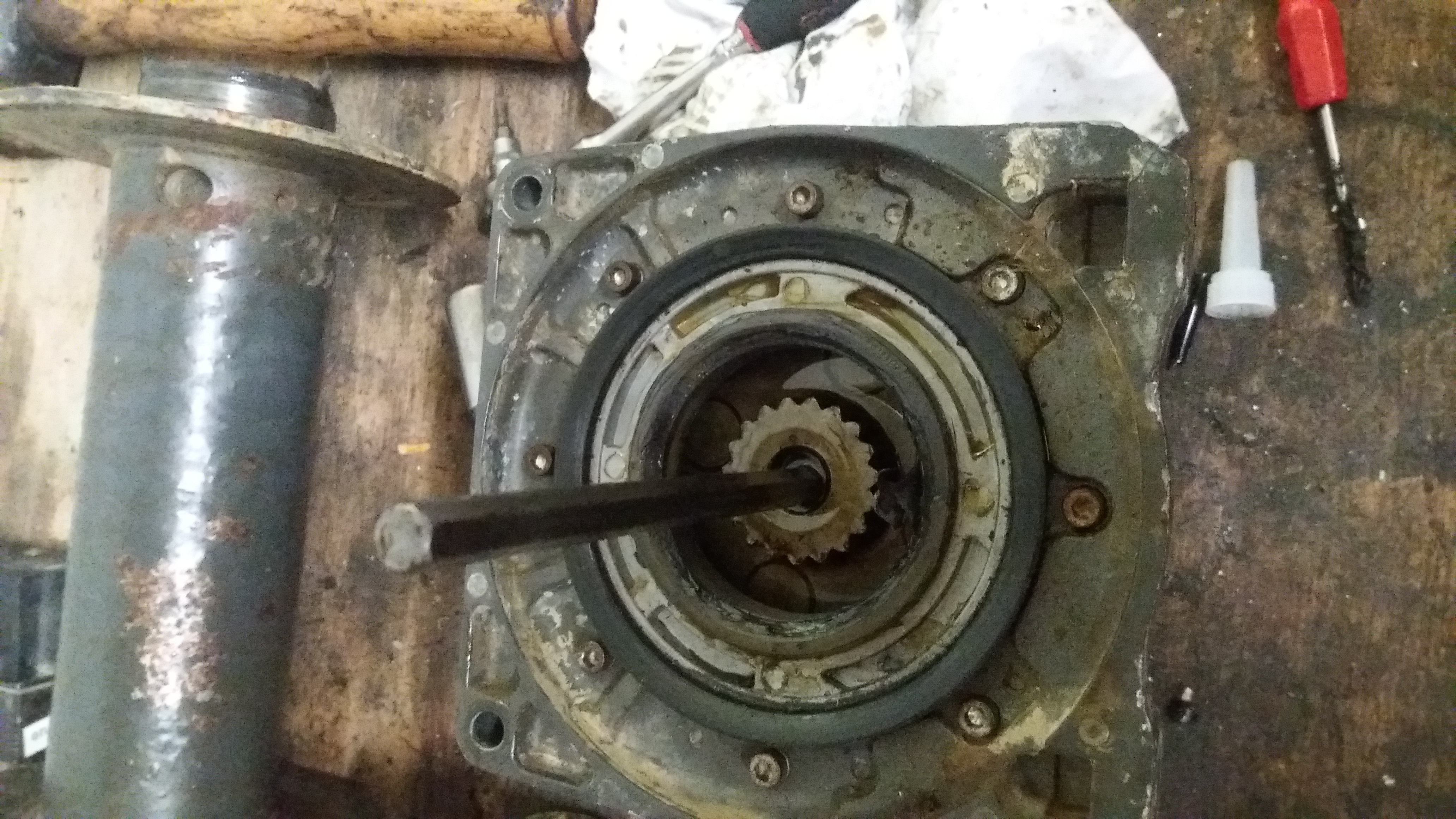

Before and after pics
After looks like a crack but it's just a casting Mark scared me when I saw it

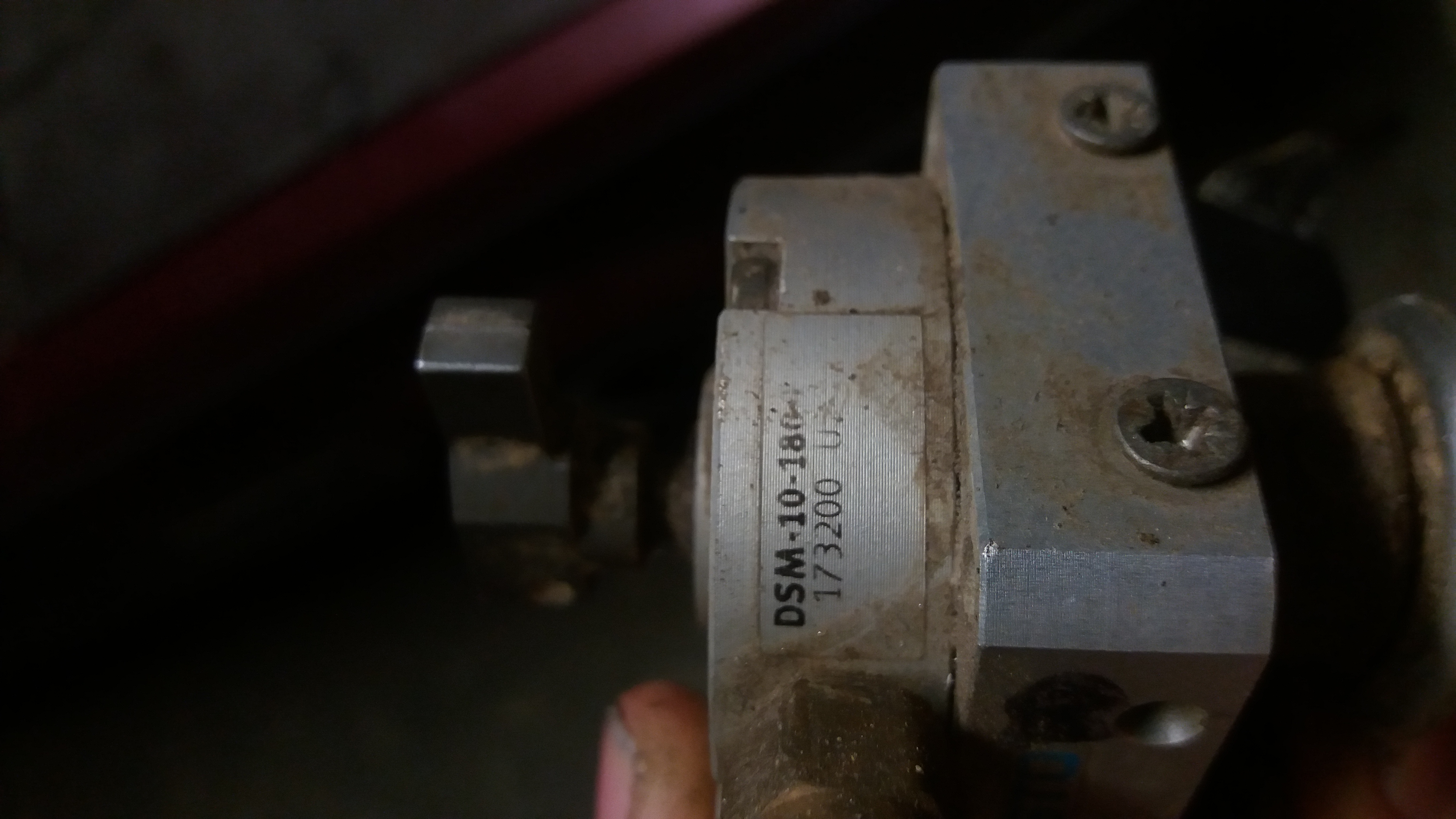

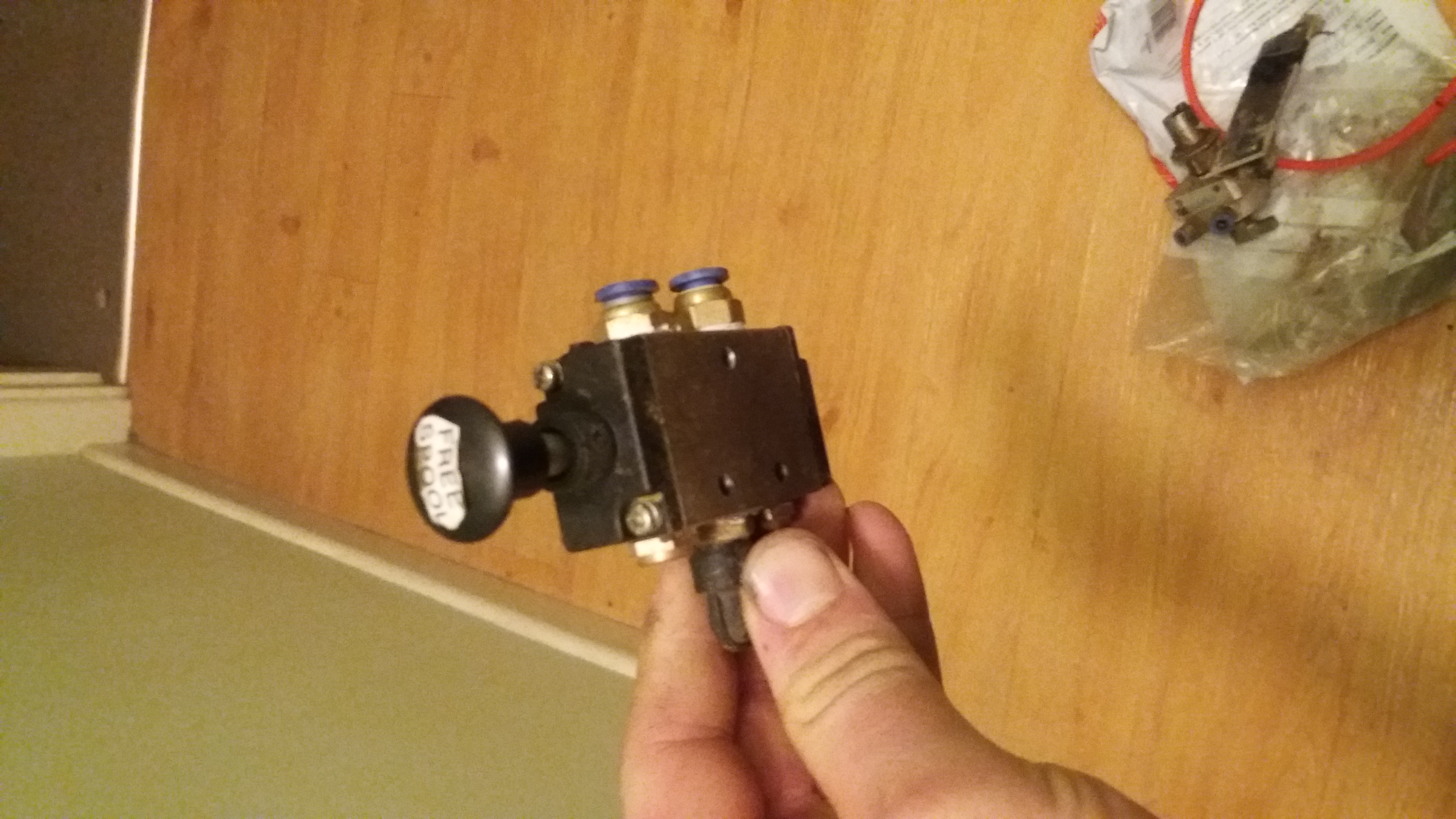

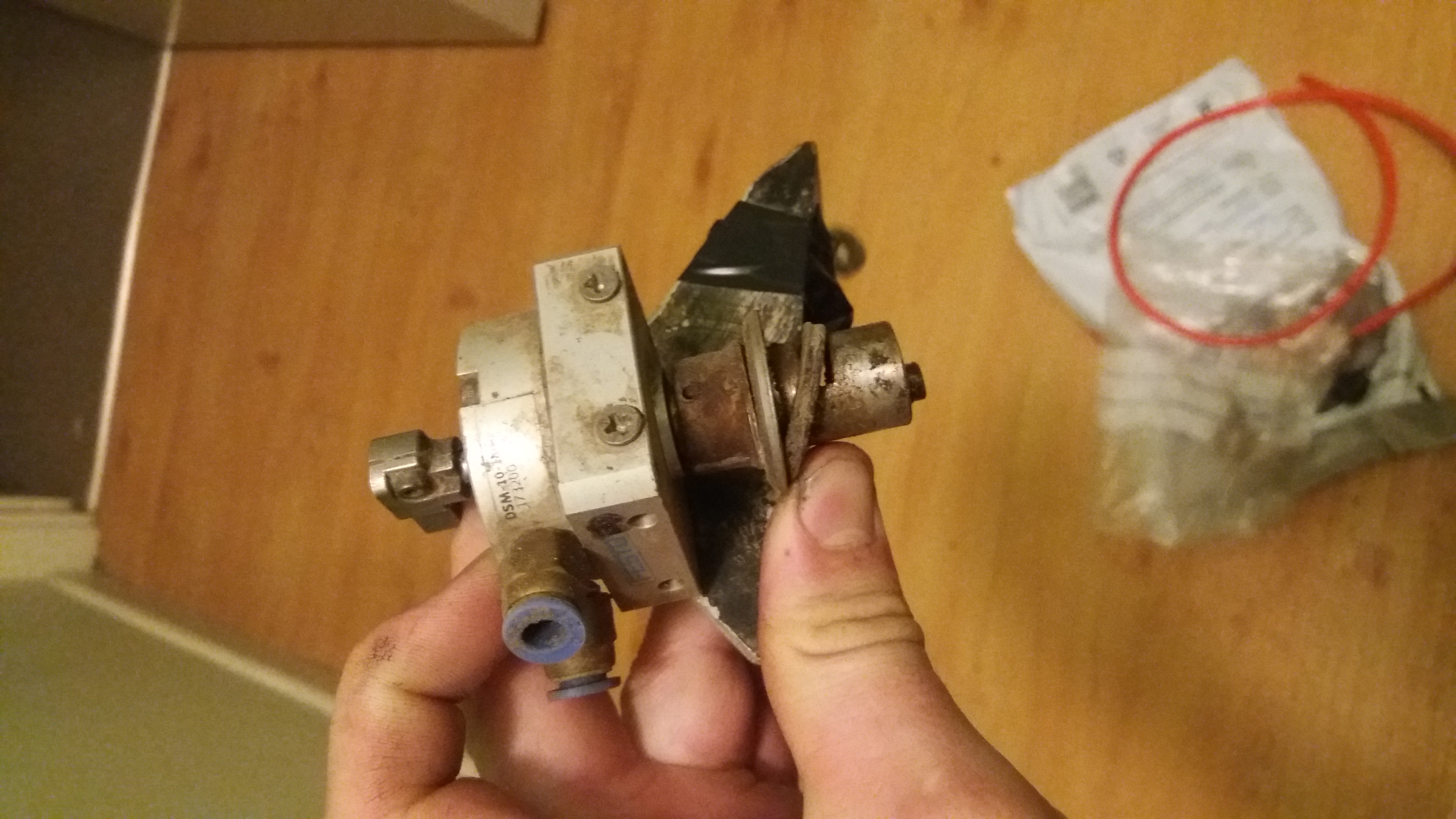

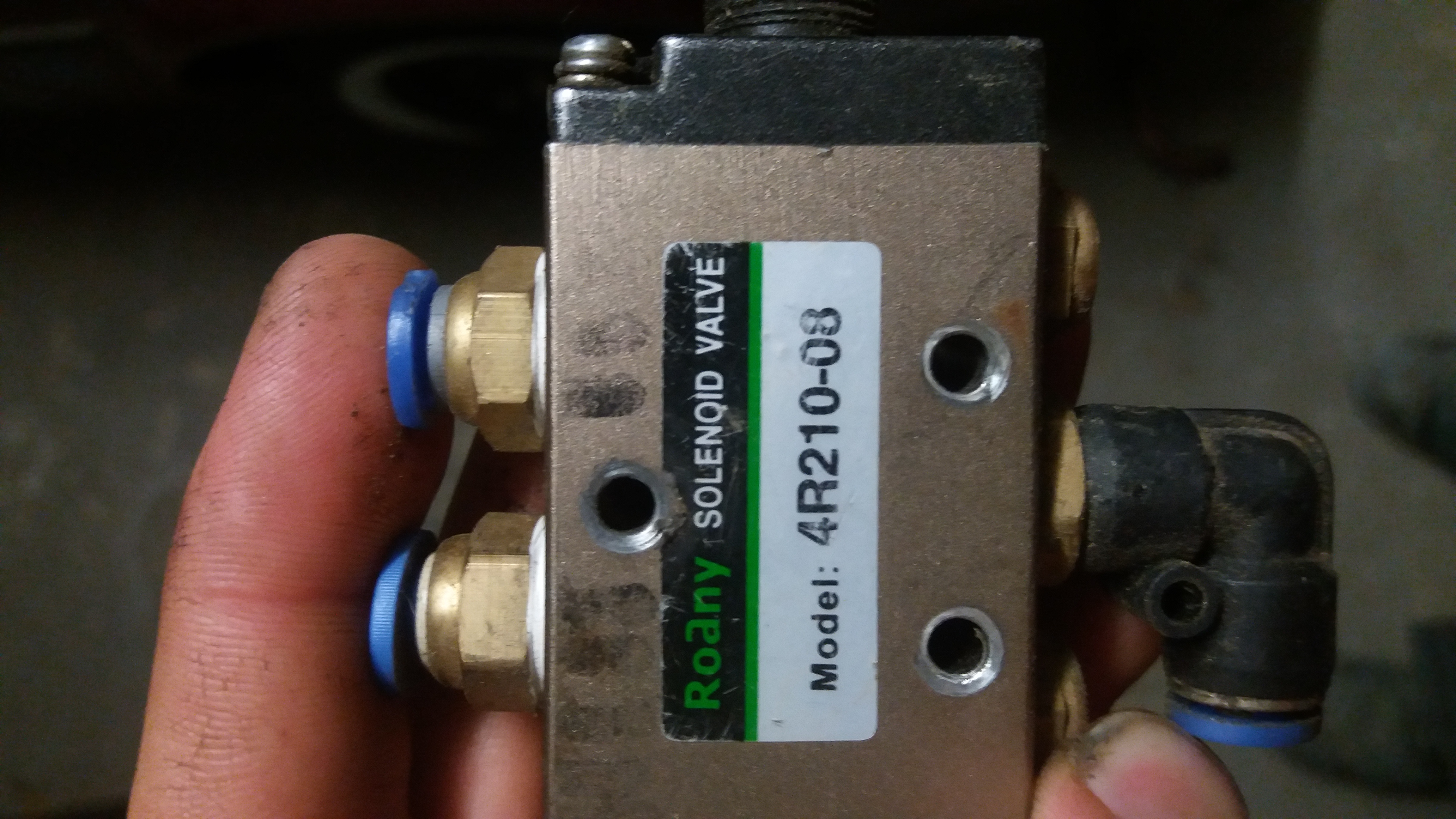

Hey guys soo bit of a update for ya !
I have brought a air operates rotary actuator in other words a air powered motor that turns free spool for me !
I have some snaps of it and the part numbers incase anyone wants to do the same I brought mine second hand from a dude in the south
