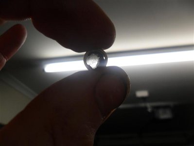

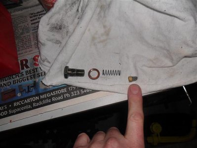

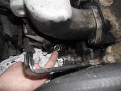

I removed the little gauze filter from the banjo fitting on top of the injector pump, (after removing the P/S mount bolts and swinging to one side), only to find it was black an you couldn't see through it. Cleaned it, which took a little bit of time and once it was clean, put it back, and reused the washers on the banjo, and started it up.
From cold, the idle seemed better, no inital missing in the first minute or so,
Took it for a drive and
OH MY GOD WHAT A HUGE DIFFERENCE, NO MORE PROBLEM SYMPTOMS
THE TERRANO IS NOT SUCH A SLUG ANYMORE!!!!!!!!
MY TRUCK IS A 1993 TD27 TURBO WITH 235K ON THE CLOCK
PEOPLE, IF YOU DO ONE THING FOR YOUR TRUCK, CLEAN THIS FILTER :D

Added some pics
Terrano's never gone as good as it is now.
Note the spring between the banjo and filter
Couldn't see through this when I got it out
Location on injector pump

reopening old thread. I have been trying to find this in injection pump and I do not see it or the spring. how far down is it?
cowman
Posts: 45
Joined: Thu May 31, 2012 8:27 pm
Location: Taumarunui
Re: Bleeding td27 after running out of fuel.
Post by cowman »
same here... I read this thread and thought id pop out and see what crap i could find in my filter. popped off the banjo fitting, but no spring, no filter? i even poked a magnetic pickup down in the hole and poked around for ages. nothing.
do you think someone else has had it off and chucked that stuff out or am I in the wrong place?
