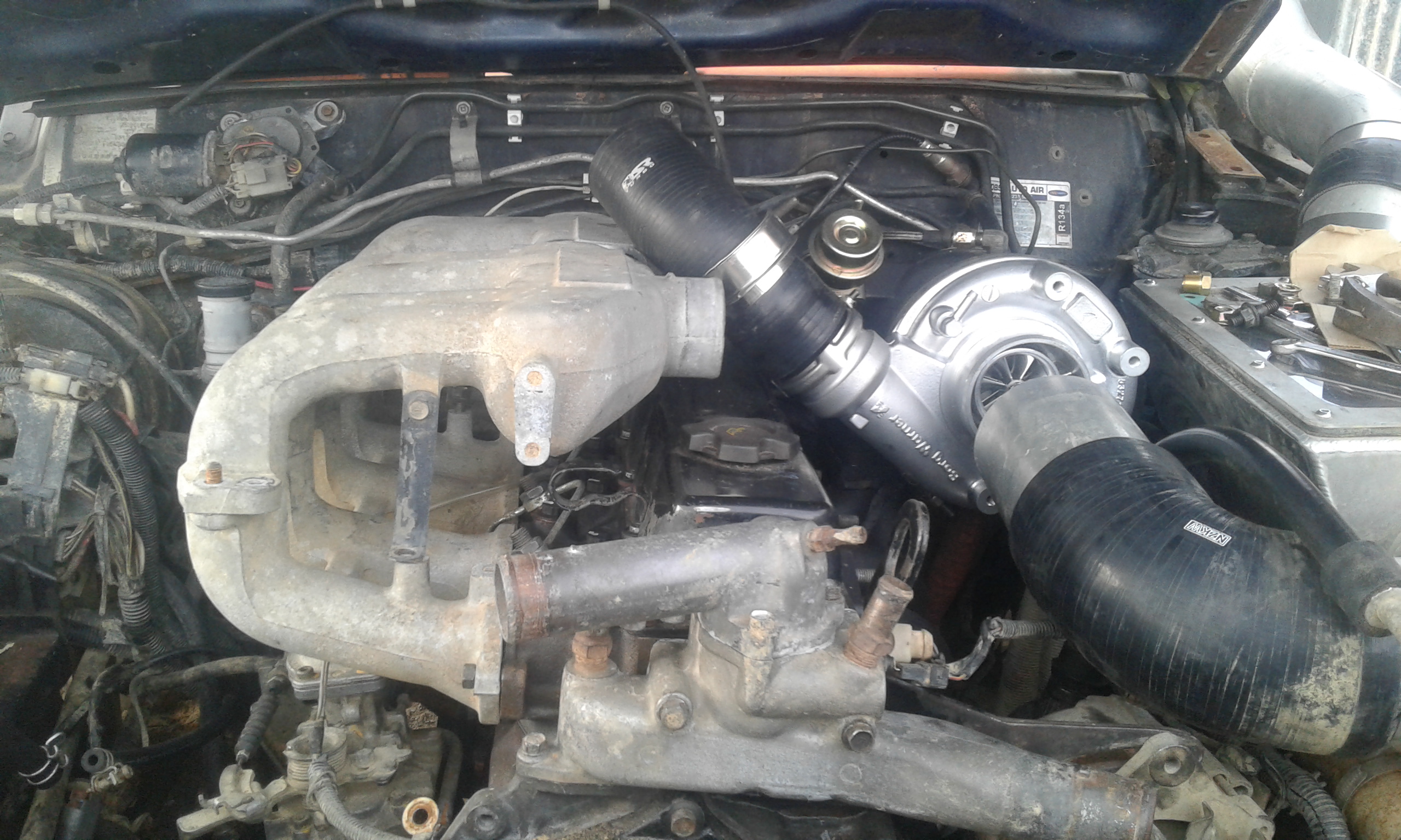

flow bench ignores harmonics an resonance unless they now run valve simulation on them?
yeah couple atmo qd manifolds which will give my a good starting point then tune length with trumpets inside the plenum.
my setup is far from standard but being nosey never hurt
problems are only a problem if you not willing to learn how to find solutions

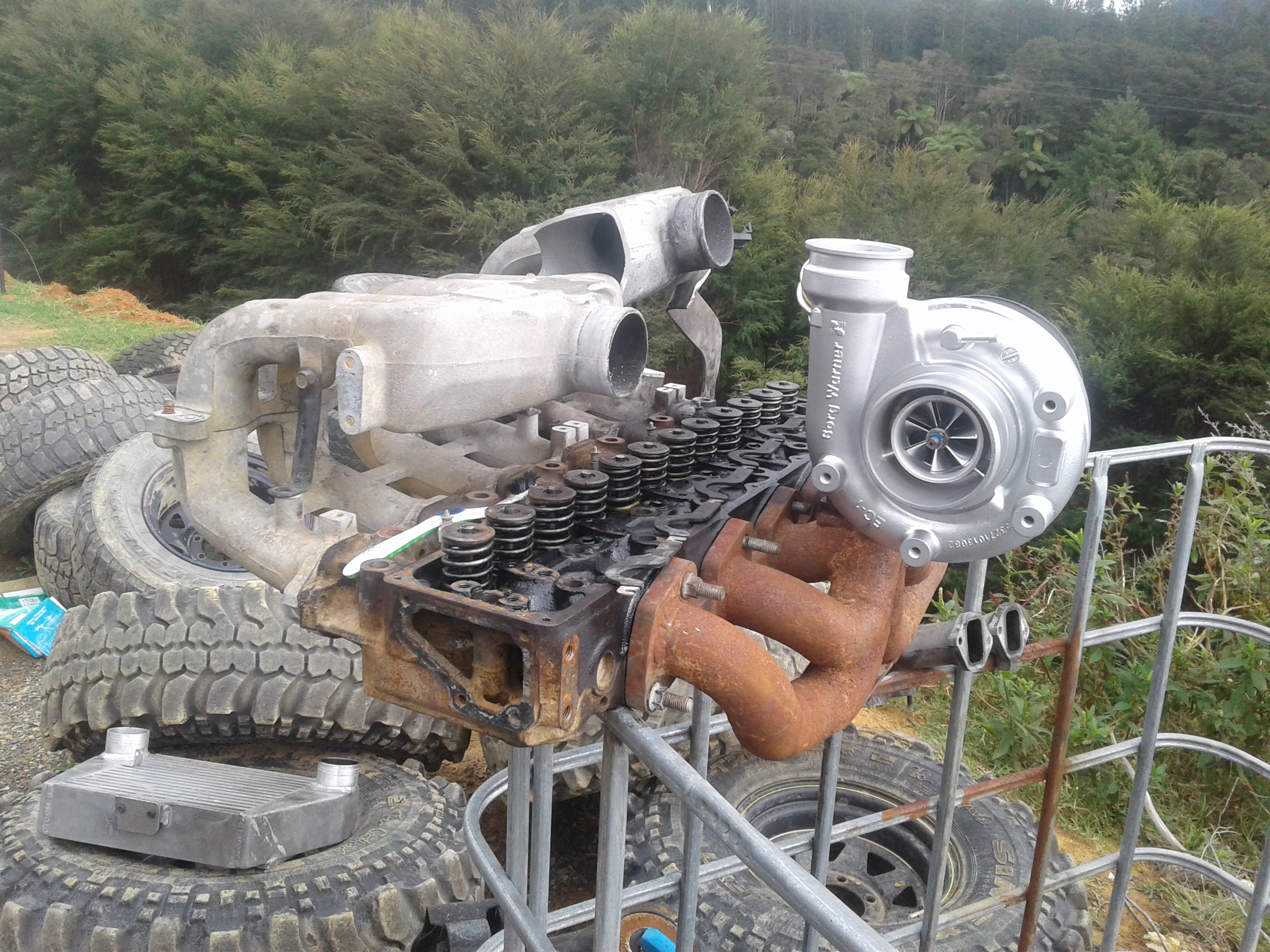

Postby coxsy » Tue Dec 12, 2017 3:22 pm
brought a intercooler for the truck, the lump totally wrong for intercooling set up ,
so spare manifold see if i can knock up something more suitable ,

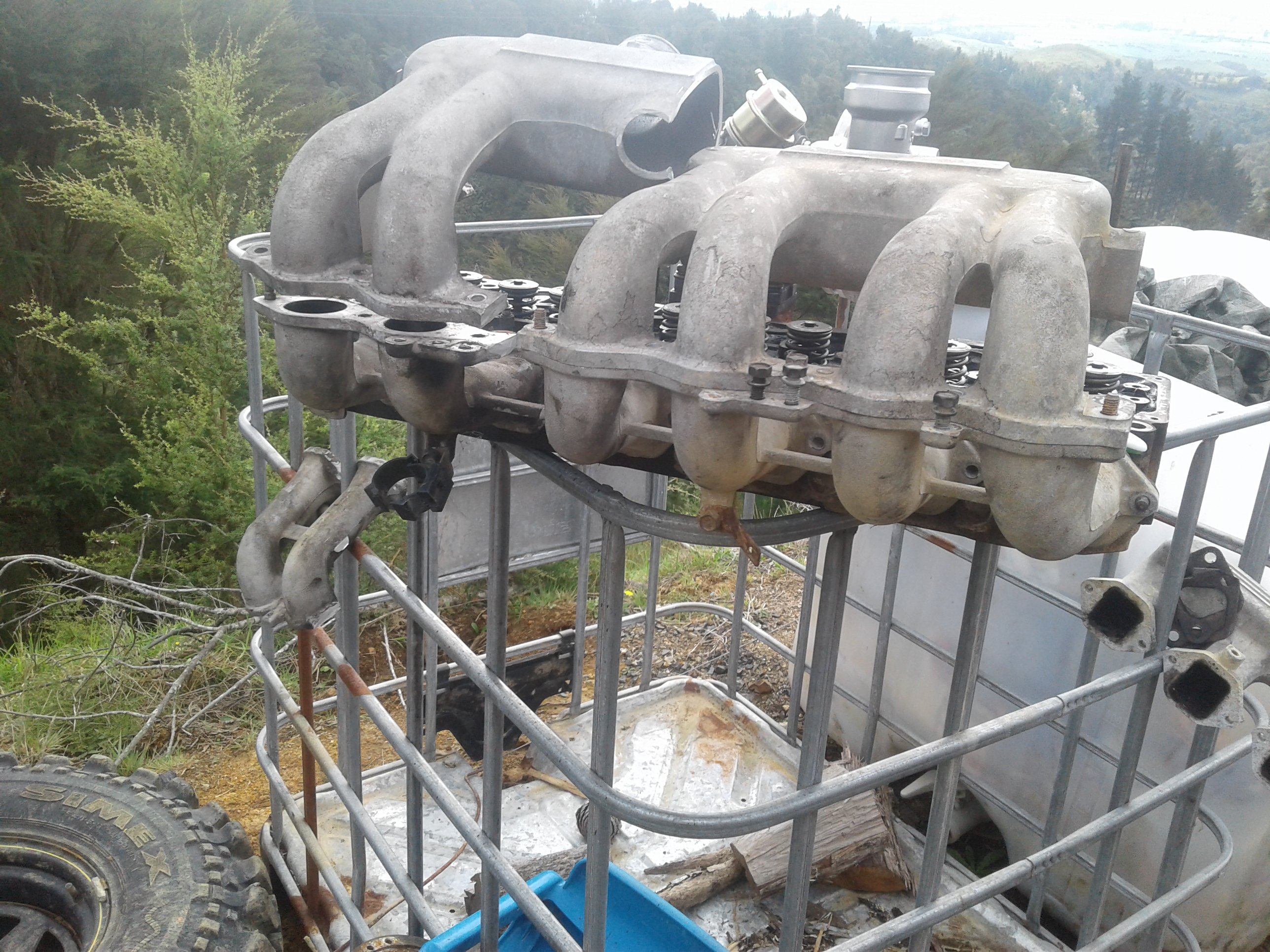

So snapped the crank on an rb style manifold better build a qd32 hybrid

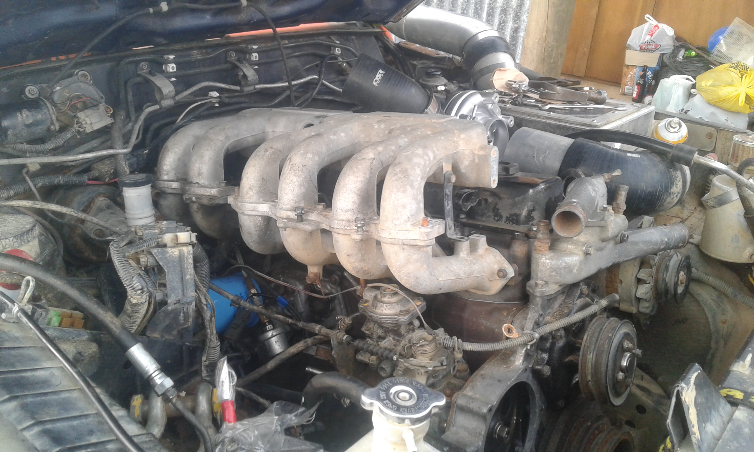

Postby slidenyo » Thu Jul 19, 2018 1:57 pm
Getting closer to some testing

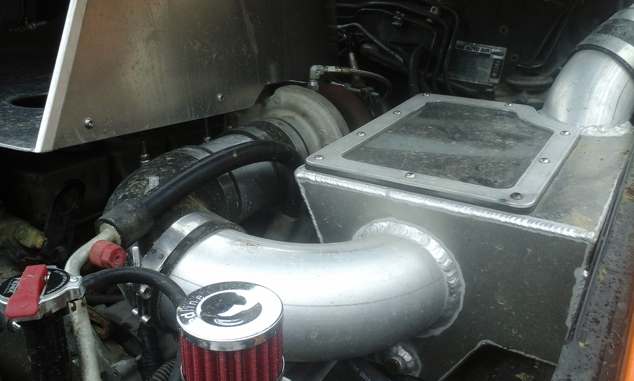

Postby slidenyo » Sun Sep 02, 2018 7:27 pm
Bit of an update.
New qd32 hybrid manifold on track
#kettlemods
