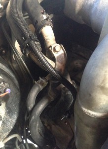

For the water sensor probe we found a bung in the head on the intake side. The sensor comes with a 1/8 NPT thread. I took both bung and sensor to a hydraulics shop (Martins) and they sold me an adaptor off the shelf for $5 We were a bit worried the probe didn't stick out far enough into the water flow but it seems to be working ok for now..

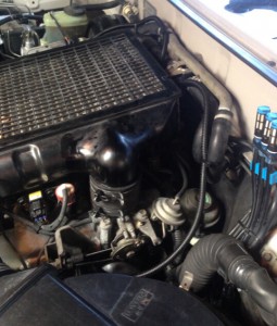

Both sensors wires went through the firewall where the heater cable goes.

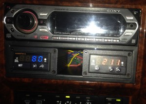

We installed the gauges into the trinket tray under the stereo. I ordered the enclosure boxes from auberins and they fit real nicely in the trinket tray held in with a piece of double sided tape.
The wiring in was pretty straight forward following the instructions: power,ground,sensor, and a feed from the headlamps which makes the gauges dim when you turn the lights on.
The only bit where we struggled was when we fired them up they were reading crazy numbers. Like 33 Celsius water whilst hot. We scratched our heads a bit until we realised that you needed to program the gauges so they matched the sensor type! Once we worked this out using the "Input Type" setting in the menu we were fine.

Yeah. Managed to change to Celcius. That last photo with the Input Type adjusted to match the sensors shows the readings at tick over , whilst hot.
Have only driven from outside of house to garage so far. Can someone post normal or average readings please? Would be good to compare...

Sensor wire routing
