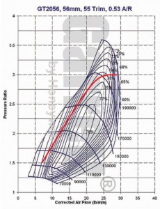

Postby fh2014 » Fri Jul 15, 2016 8:59 pm
Ive seen the antisurge vs non antisurge on compressor maps, it pulls the efficiency more to the left with the antisurge housing.

Postby fh2014 » Sun Aug 14, 2016 11:00 pm
Thought I'd post this just in case someone with the same problem stumbles across this thread.
Here is what I had
Heres what I have now
The first was massive surge because the compressor was too large/turbine housing too small resulting in the boost building to quickly for the engine to consume it.
After contemplating buying yet another turbo $$$ and building yet another downpipe I was able to buy this thing here https://sirhclabs.com/ (mods remove if not allowed) and control the boost by only the engine speed - rpms and more importantly in my case - airflow. The cortex ebc seems a powerful unit for the price - to get similar control from other well known brands I was looking at $900+. I couldnt find many reviews online so I took the plunge and so far I'm happy as. hope it lasts and hope someone finds this information useful.
dvk-kp wrote:I had a Turbo Smart e boost street in my laurel and I could control how it came on boost with it. Worked well. Works up to 40 psi too. Can't see why it wouldn't do th same on a diesel.
I looked at this, good entry level unit but can only control boost with a speed signal, not an RPM signal.
