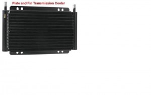

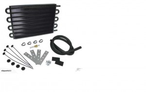

Like this? BNT didn't have in stock.
Re: KZN185 transmission swap...
So, these are the type not to install?
Rather, this type?
Rather, this type?
Correct. The bottom one (plate and fin) you posted is the more efficient type.
BNT didnt offer to order one in? Google Davies Craig trans cooler or Hayden trans cooler and get the largest you can fit in the space you have
